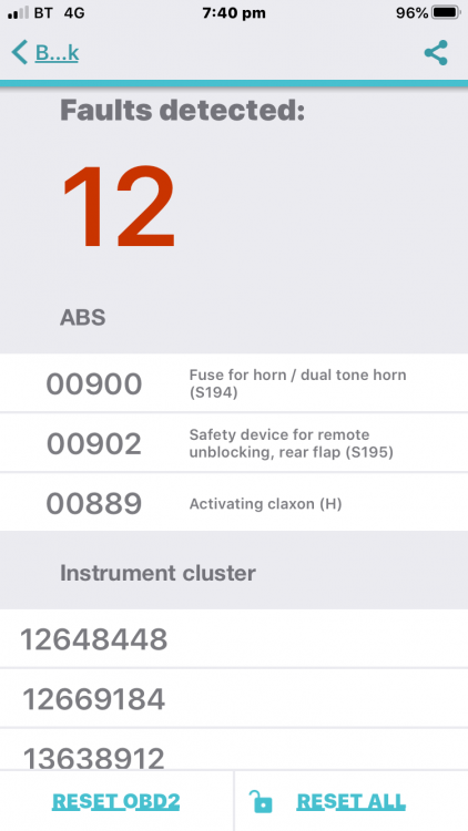

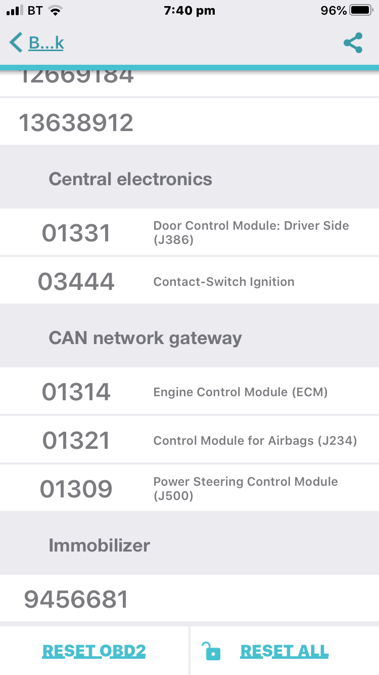

I plugged my carista OBD in and ran a diagnose and these errors came up. I'm guessing these are coming from either the ECU or the convenience module? It's stopped raining and the car seems okay at the moment of testing but I don't trust it. I'm taking it to an auto electrician to see what they can do.

Could the door wiring throw the same errors? I noticed in the diagnostic that there is a problem with the door module, so if water had got into the wiring, could that provide a communications problem across the whole CAN network?
Very much so. A friend's Octavia had this sort of problem several years ago when water from a leaking rear washer got into the trailer module and shorted across the CAN lines. Once it had dried out everything returned to normal. I'd go looking for water in any of the control modules that are connected to the CANBUS (which is probably all of them), starting with the ones in the engine bay (ABS and engine) as they're the ones most likely to get wet when it rains.

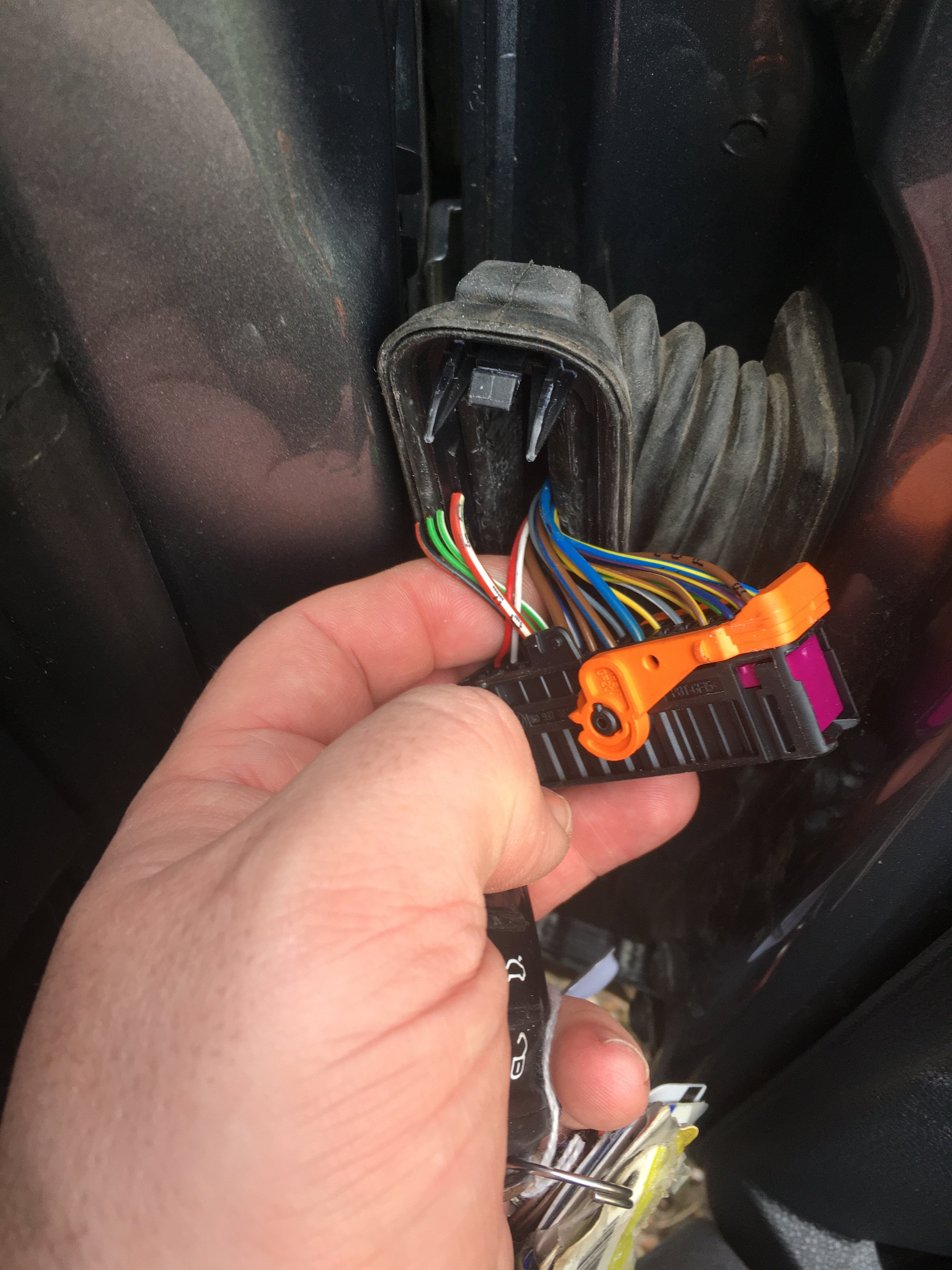

Hi,
I just prised open the driver's door loom to find 5 broken wires, 4 are visible in this shot and there was some water in the bellows. I've realised I can lock the doors with the remote, and lock the driver's door with the key and the car is secure until I can get the wires rejoined.
The red and white wire must be the supply for the window motor, which would explain why the motor didn't work.
I'm hoping that resolves the issue.
Yes, Red and white looks to be the main supply in my Haynes manual.
There are 4 small wires that had broken, one had broken inside the sheathing and a number of brown wires have nicks in them. Notably a blue and brown wire that provides the CAN bus to the door module has a nick in it, which could explain the errors on the bus. The red and white wire carries 12v and is fused at 25A, so could explain why things were behaving odd when it rained, it was potentially shorting out. It may have been playing up for some time while this wire was breaking.
I have some liquid tape that I will be sealing the nicks with, and some waterproof heat shrink butt connectors that melt solder into the joint when heated to patch the wires together. I'm waiting on the larger sized ones for the red and white wire.
