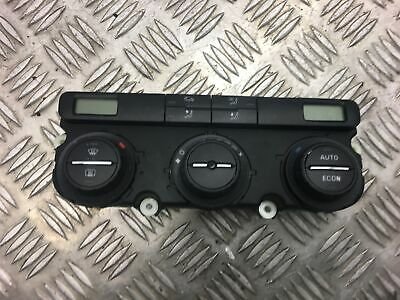

Thanks @pikpilot fiddled about with controls this afternoon, varying each side etc to no avail, I don't know about climatronic I've got a switch that says econ that's about it but that's off. No aircon button just a temp control dial for a each side and one in middle for fan speed.
A photo of the panel would give confirmation.
If it is a manual system then check that when you move the manual controls that they feel or sound like they are moving something. Many years ago I had a manual heater and seperate a/c where the rod from the heater temperature control dial had disconnected itself (not a VAG car).
Edited by pikpilot
@pikpilot this is the one I have
That must be one of the Climatronics variants as it has an AUTO switch and two temperature setting displays.
Even the non Climatronic systems are not manual in the way that you remember and describe them, they have electric actuating flaps, the last car I can recall owning with a manual heater valve must be a 70's Mini and the last with manual heater flaps? - Cant really recall, not even sure if my Sierras had them.
