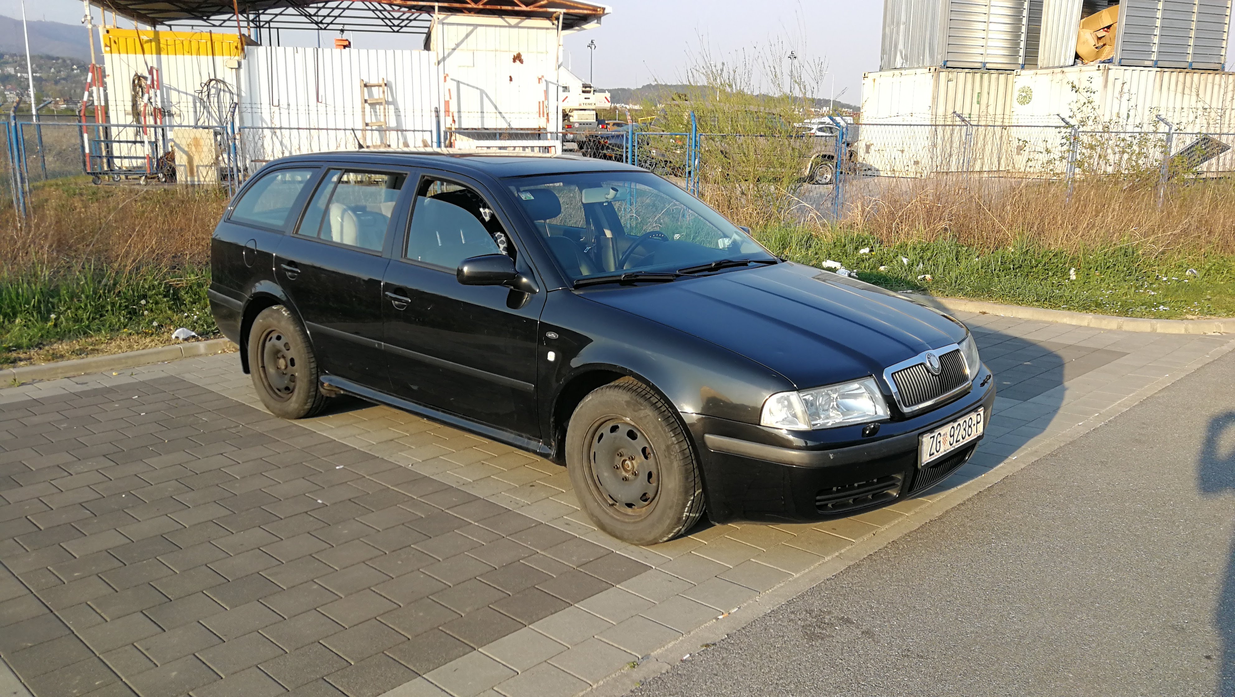

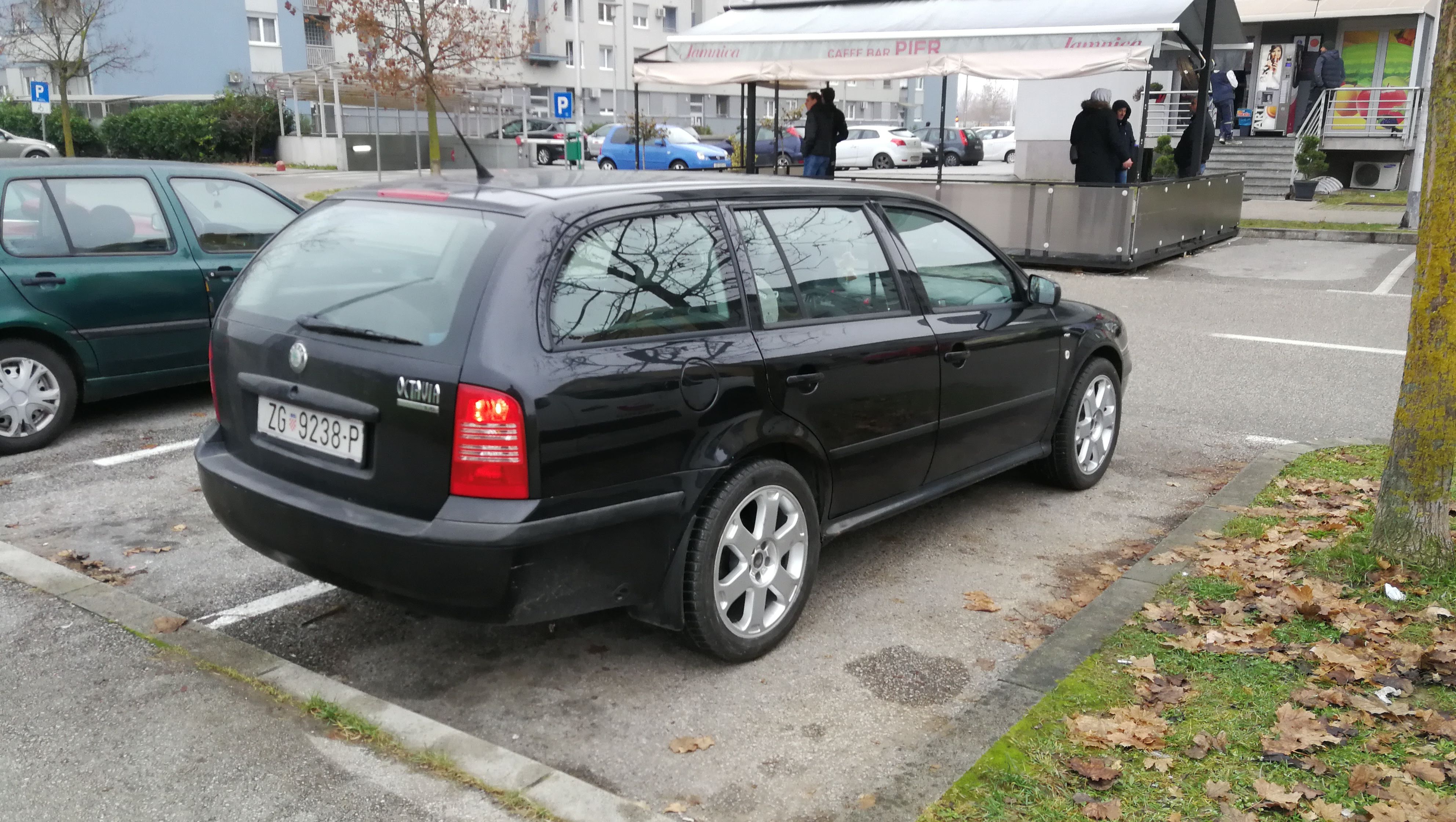

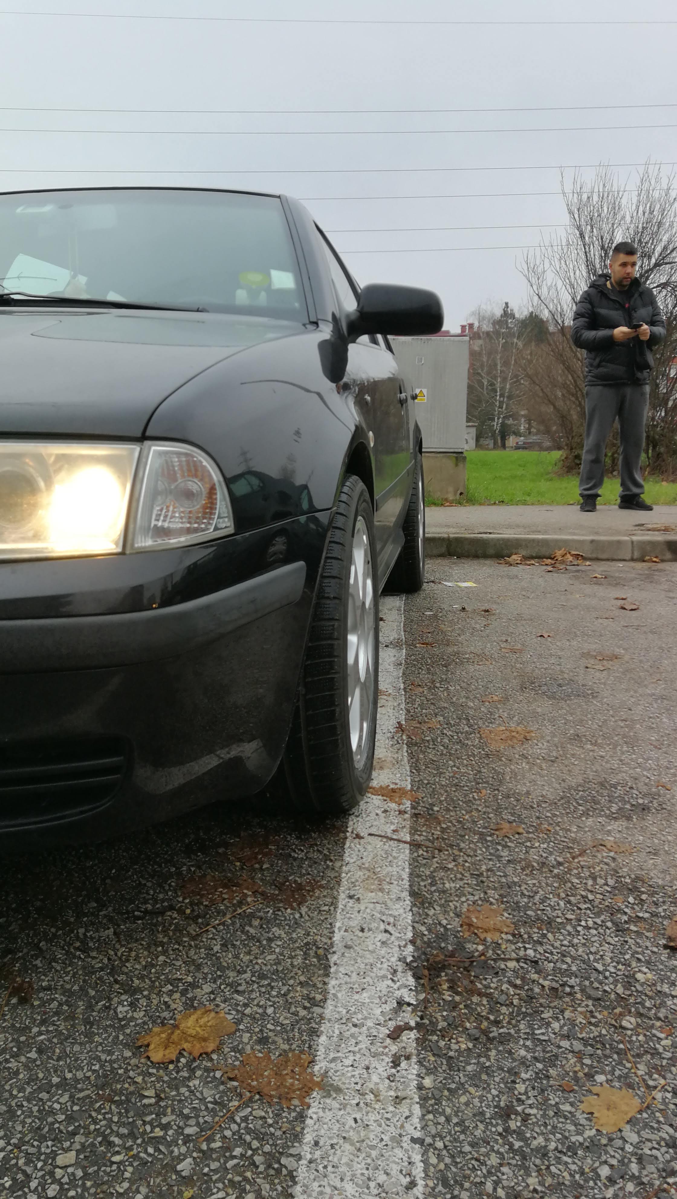

Attached a few pictures of my Škoda stable, the cars actually complement each other, both black, with stock xenons, looks cool. I just love the subtle looks on the Octavia, it's the perfect sleeper.

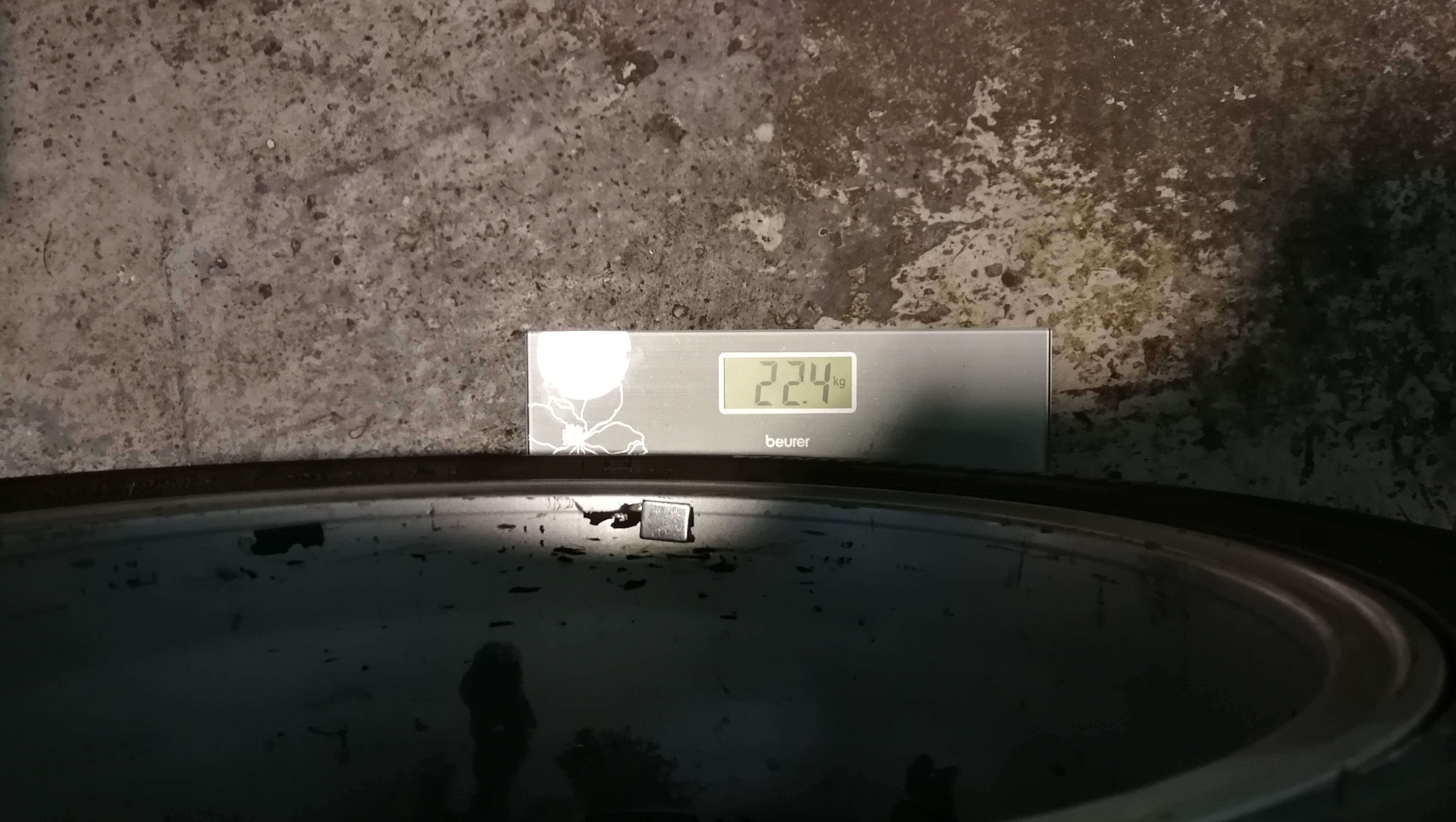

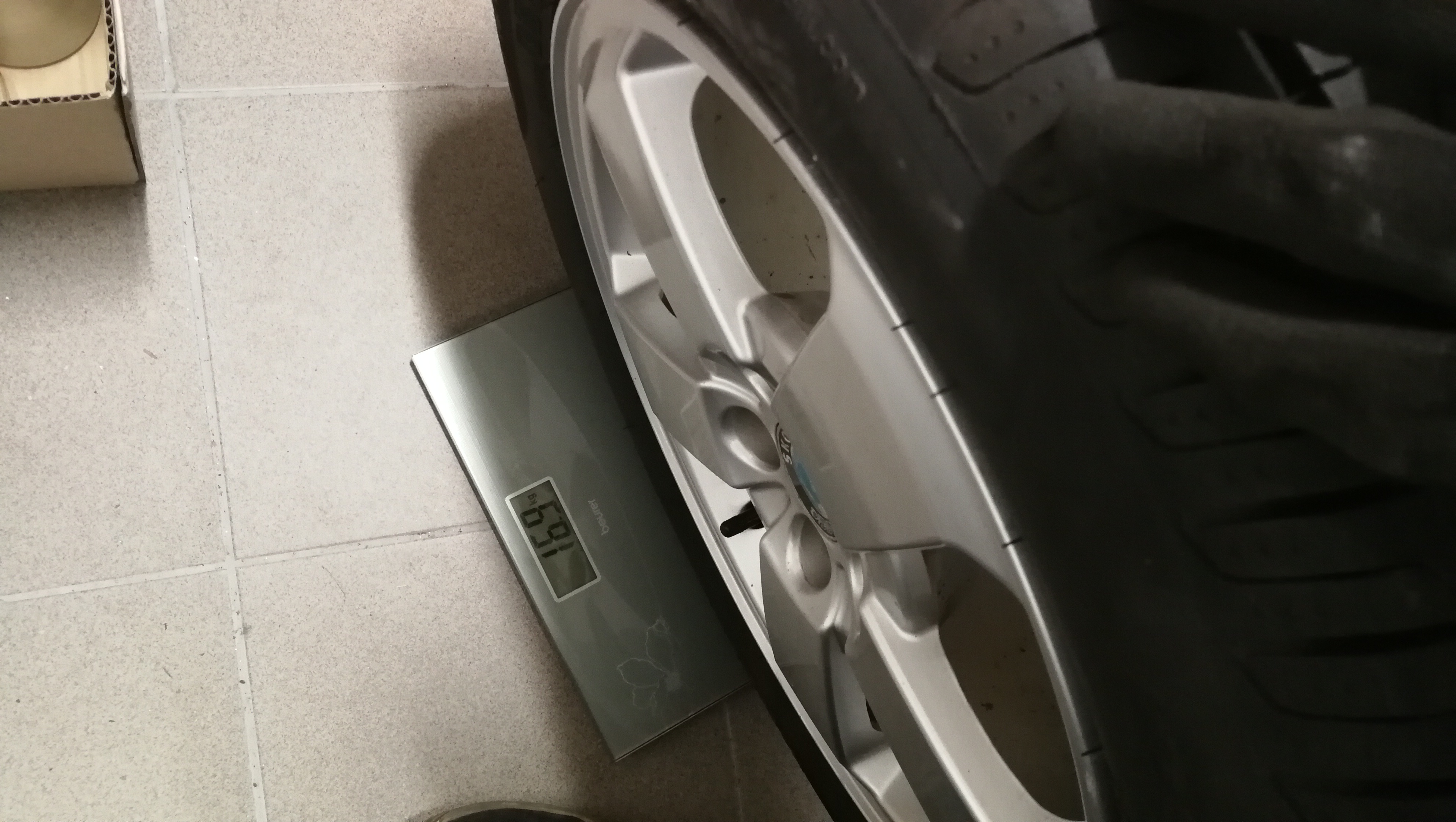

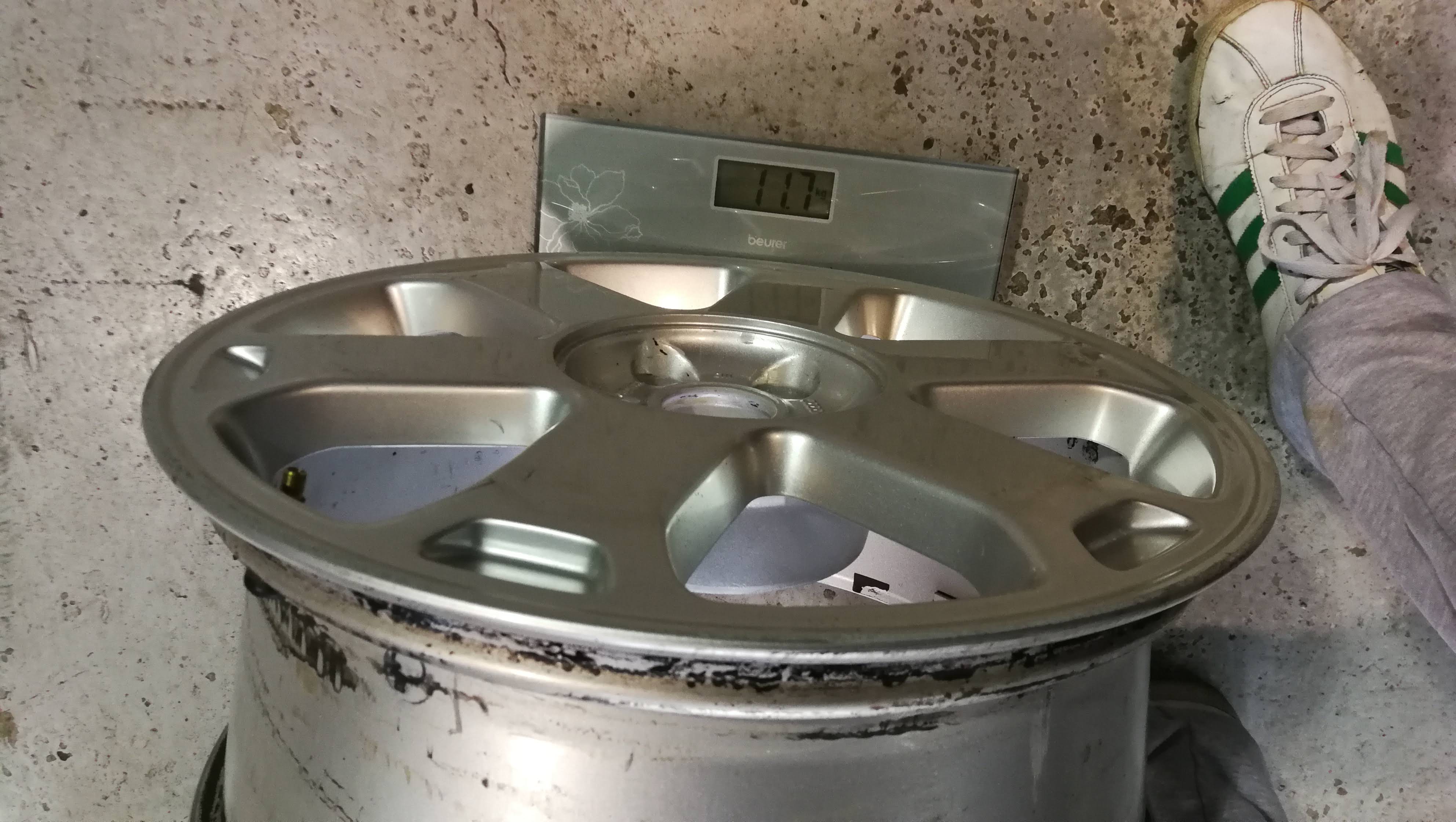

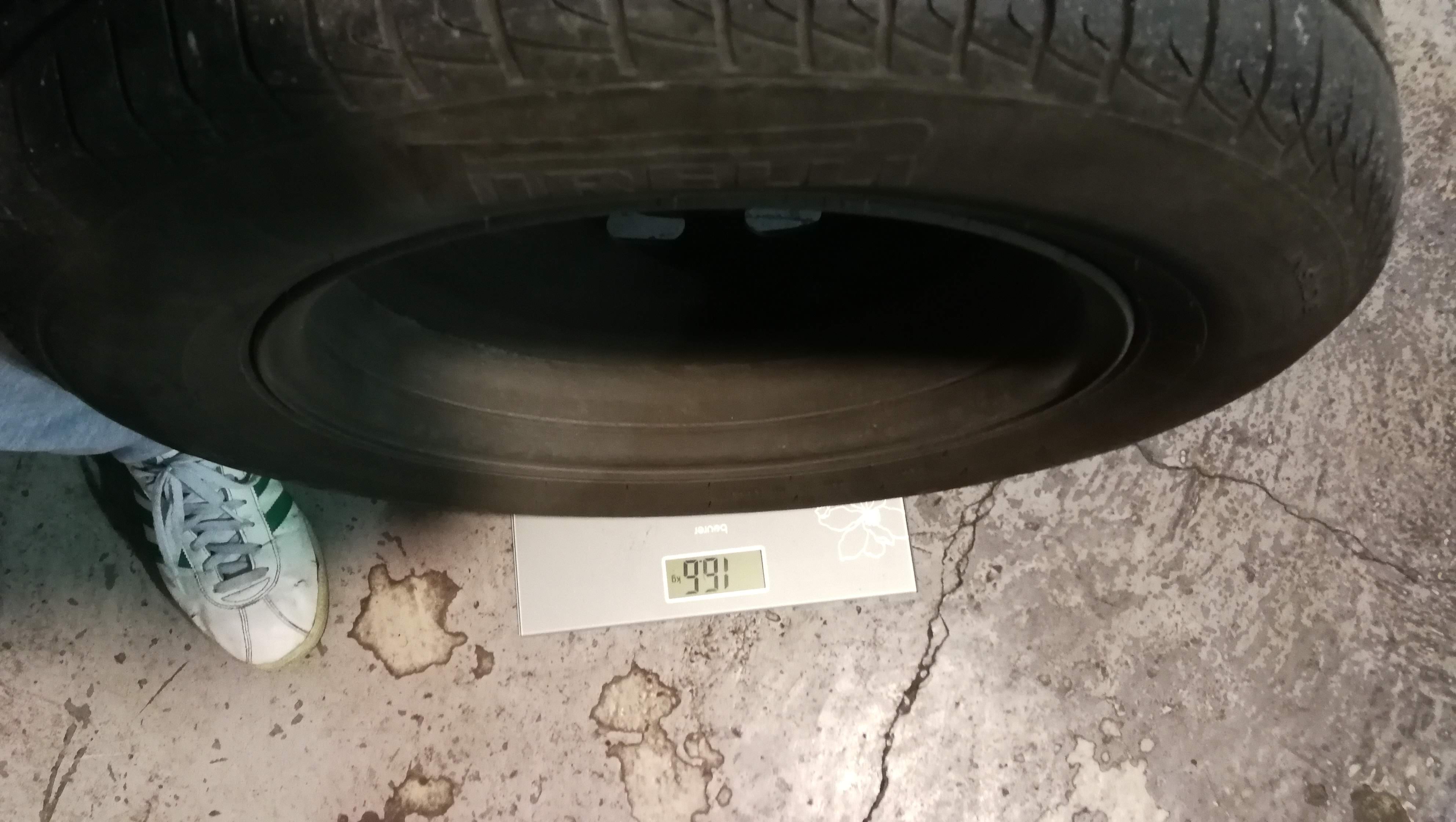

awfully heavy, steel rims+tyre 16.6 kg, alu rims+tyre 22.4 kg, ouch

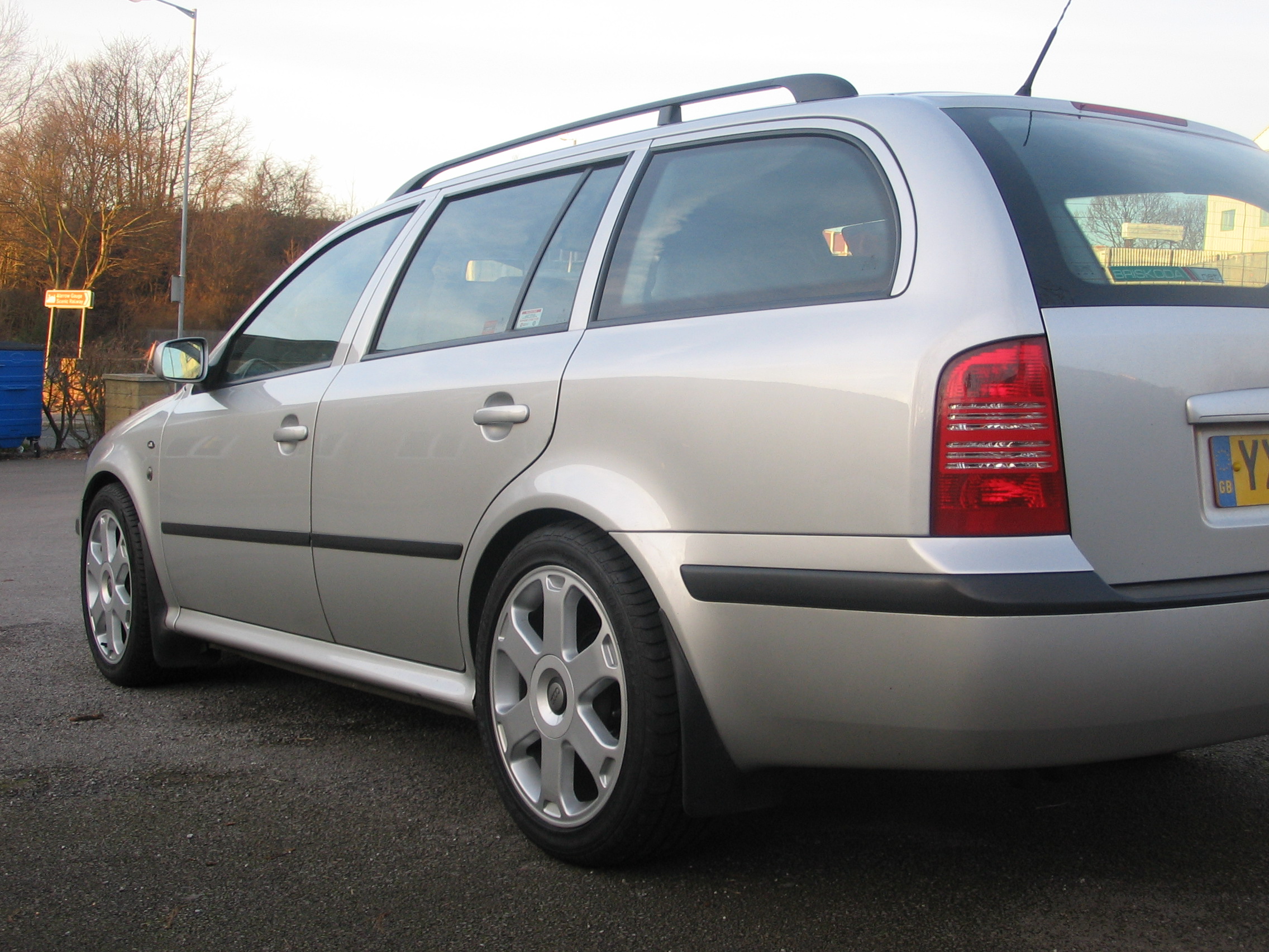

As for the wheels, I've done the same as you in the past.  The car looks better on the Avus rims but as you say, they're heavy.  I once put some Audi 'fat fives' on my old Mk1 and they ruined the ride & handling.  They looked good but after a few days I went back to the standard Spiders and the car felt so much better straight away.
I've currently got a set of 18" OZ Ultraleggera on the car which strike a good balance between looks and weight.  They're lighter than the standard Spider rims but they aren't cheap.  I've also got a set of 17" Pro Race 1.2 in the garage and again, they're light but seeing as I bought them new, they cost me quite a bit when new tyres were added.  I have a problem when it comes to wheels and have spent a fortune over the years on my cars trying to find the sweet spot between looks, weight and cost.:blush:

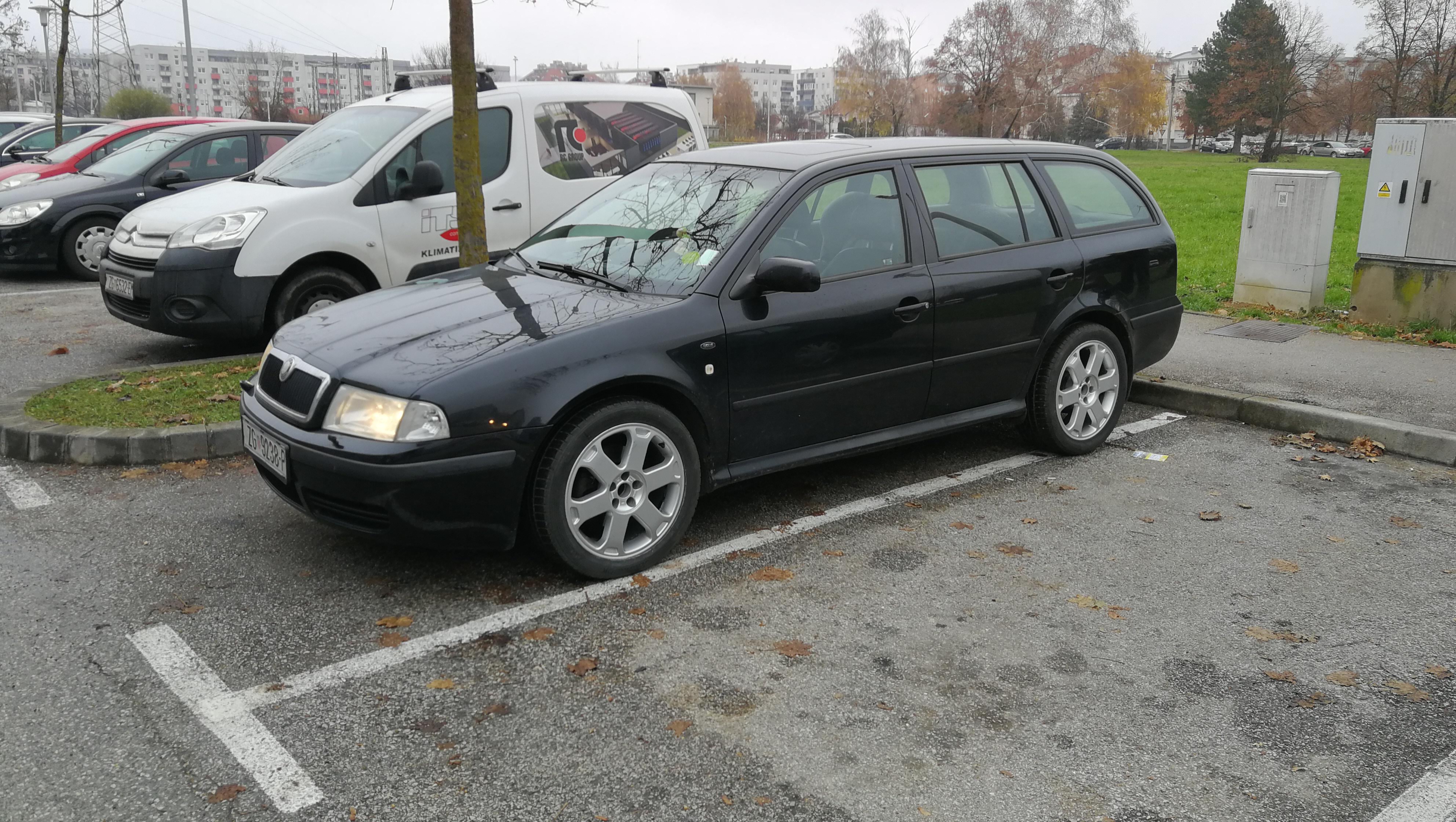

So much for the 17" Avus... Failed homologation, fronts are outside the car silhuette, car is basically illegal to drive with them. After much contemplating what to do, fit 225 tyres, do camber adjustment, extend the flares, even mill down the rims - in the end got rid of them (made good profit lol) and found a great deal on original 16" Ride wheels with Pirellis P7 205/55R16 already fitted, great condition of tyres and rims. Saved myself a ton of time and nerves.
Weight of the set is 16.9 kg, exactly the same as 15" steel rims and tyres. Unlike horridly heavy 22.4 kg 17's.
The initial turn in and car wobbliness was better on the 17's, everything else is better on 16's, especially acceleration (even grip, but probably due to good summer tyres unlike dead winters on 235).
Now I'm back at my sleeper roots, the car looks just so natural, clean and calm, I look at it quite often :)
