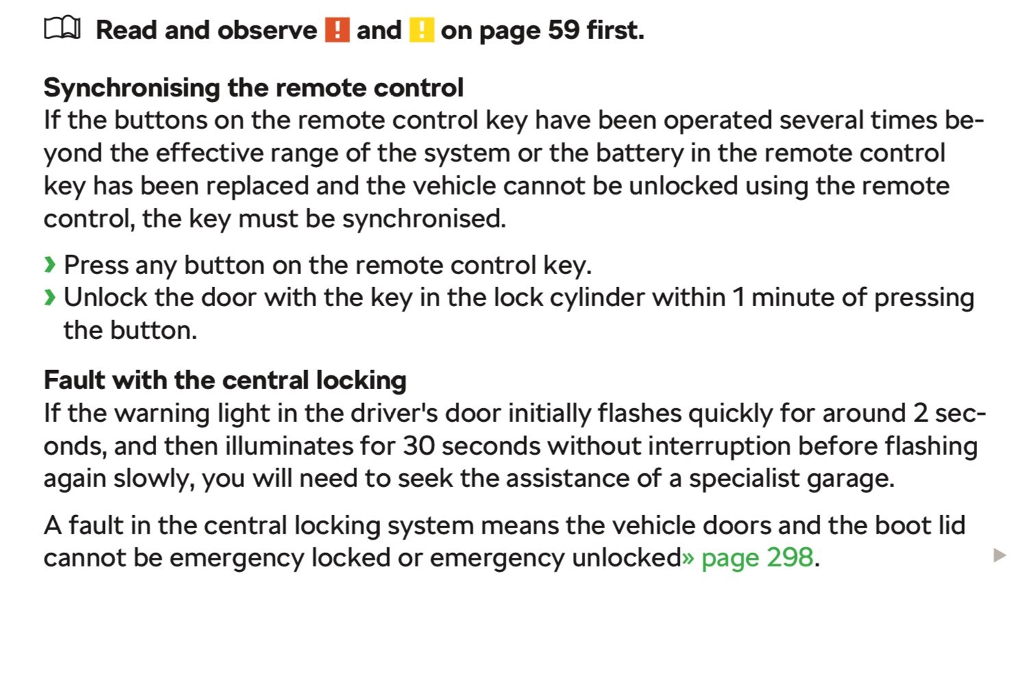

Have a look at this thread:-
You might need to re synchronise your keys..

I've not had to do anything to resync the fobs after replacing a battery, but I have checked both of mine out immediately after making a replacement, just to ensure they're both in sync again.
