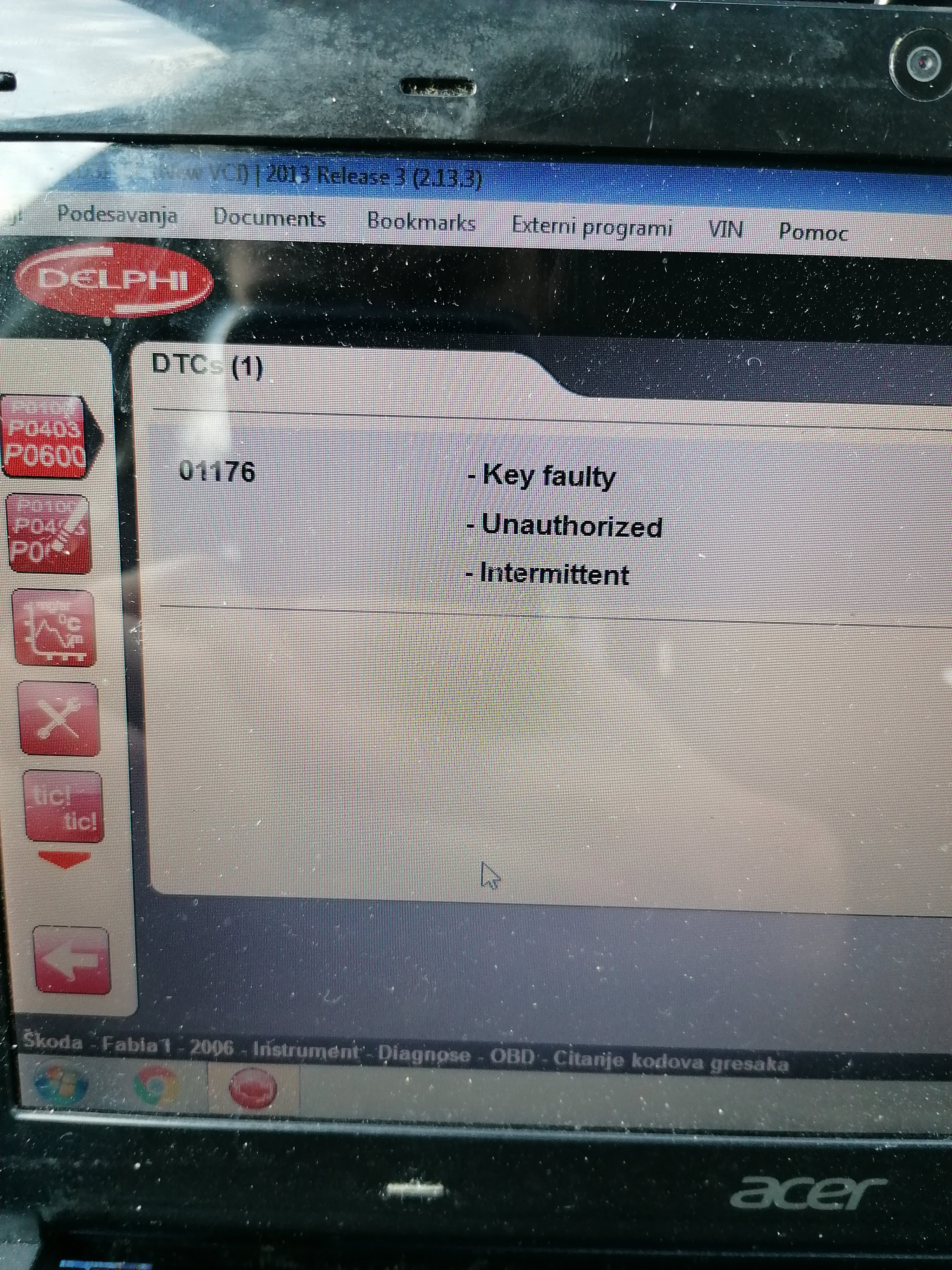

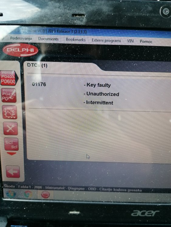

Hi everyone, i finally got a dash, a 2006 TDI combi showed up on a scrapyard and i went and snatched the dash, mine Is model 6y0920 871 d and the one i got is 6y0920 872d, I don't think that's a problem. Plugged it in, everything works beautifully, but it has lights on: the immobilizer, the check engine and airbag light. I got my dad's Chinese Delphi knockoff and erased the airbag, went into the dash, only code is " faulty key", when I erase it it says system ok, until I connect again and it shows it again. The immo light won't stop flashing. Tried going into the immo also, the same thing as the dash, same code, erase it, it comes back. The check engine I cannot solve because this diagnostic can't go into the ECU, no idea why, it has a problem with some VAG cars🤷🏻‍♂️. Does anybody know how to solve that immo light, it goes on my nerves now that everything is working..
You will need Vag-Tacho to read the pin code of your old speedo unit and then read the Pin code of the new one, then with VCDS  you can get the replacement speedo unit to recognise your ignition key transponder chip, there is a video on how to do this on the Ross-Tech Wikki site
Damn.. the old one is dead so reading the pin from it is a no.. also I don't have vcds, looks like I will just put a piece of tape over the LED😅
I did the same thing, I had exactly the same issue and just taped the LED, immo light disappeared immediately :D
