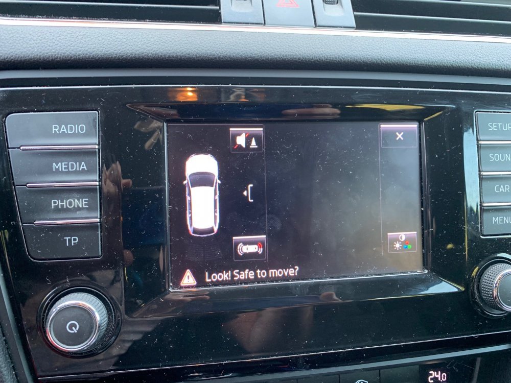

Hello,
My skoda octavia is 2014  with MIB1 (with BT....)...  I bought cheap rear camera and MIB Adapter (I connect to port 6 and 12).
In VAG-COM I activated "rear camera" - (10-Park/Steer Assist - Coding,  -  Rear View Camera installed)..
I now have a just same screen picture like before (see attechemnt). Parks sensor work fine, but I need display graphic for camera. Any ideas?
Thank you
@aki78 Can you please help me solve it?
Do you also need to tell 5F Infotainment that you have fitted a camera?
If you have the screen with TP and not VOICE on it, then adding a camera in this way isn’t possible.
