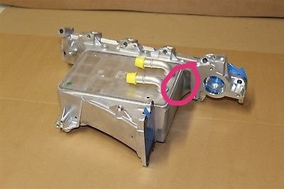

So the problem was finally solved, the engine harness had chewed through a couple of wires at the intake manifold, (the thick wiring that goes down by the right side of the manifold).
Through vibrations, or a rogue rodent!?
Through vibrations, no signs of rodents, thought on it also, but you could clearly see that the harness had rubbed itself on the inlet manifold. The harness has probably moved with heat by time closer to the inlet. (took a pic of the inlet manifold from the internet and marked the area the harness had rubbed on)
