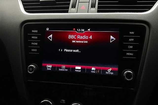

I’ve seen a couple of vRS that have alternate background colours on the menu and maxi dot screens.
I can’t for the life of me find an option to change this setting from green.

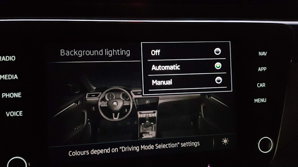

You need to be on 04xx firmware for this. Contact Pawel (pab567) on here and ask him if he has the correct firmware for this. For sure he will. Once that’s done it’ll work and if you want the coding for the option of automatic changing of the lights according to drive mode please see below
19 CAN Gateway — coding:
FPA_Funktion_AMB: active
09 Central Electronics — adaptations:
IDE09731-ENG154511-Int. Light:
2nd generation-Ambiente_Farbwahl_FPA_waehlbare_Kopplung : active
2nd generation-Ambiente_Fahrprofil_Individual : 1
2nd generation-Ambiente_Farbwahl_FPA_waehlbare_Kopplung_Status_hmi_default : coupled
2nd generation-Innenlicht : Keine_Spannungsanforderung
ENG153712-ENG154510-Ambientelicht Zuordnung der Farbe zum Fahrprofil :
Fahrprofil_0: 1
Fahrprofil_1: 1
Fahrprofil_2: 1
Fahrprofil_3: 4
Fahrprofil_4: 1
Fahrprofil_5: 9
Fahrprofil_6: 1
Fahrprofil_7: 7
Fahrprofil_8: 1
Fahrprofil_9: 1
Fahrprofil_10: 1
Fahrprofil_11: 1
Fahrprofil_12: 1
Fahrprofil_13: 1
Fahrprofil_14: 1
Fahrprofil_15: 1
Ambiente : Sollspannungsanforderung 13.5V
You can set any colors, I set like this:
[LO] _Fahrprofil_2: 1 — normal
[LO] _Fahrprofil_3: 4 — sport
[LO] _Fahrprofil_7: 7 — individual
[LO] _Fahrprofil_5: 9 — eco

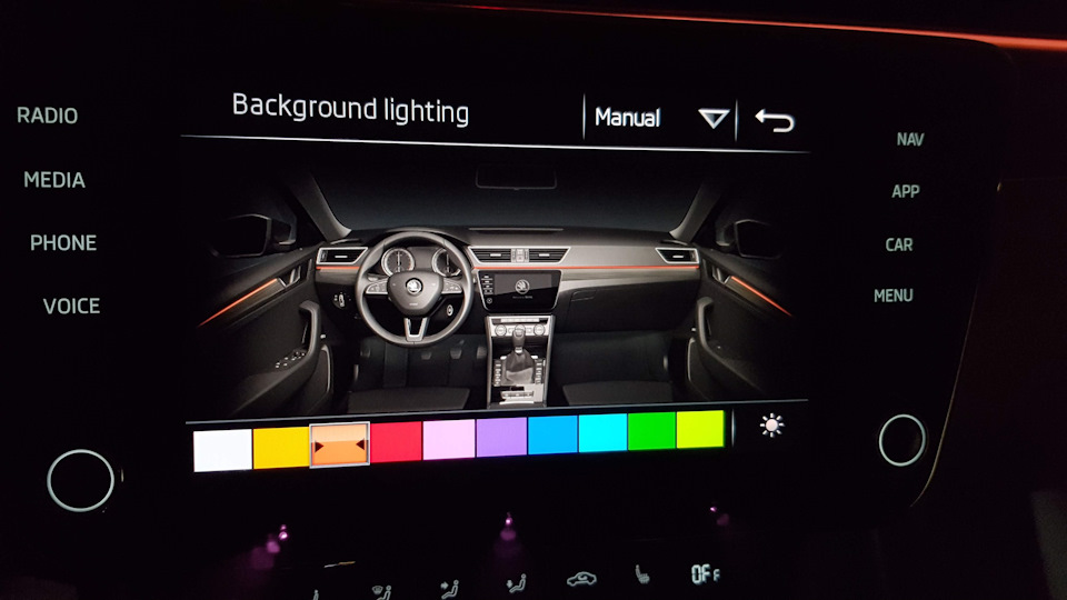

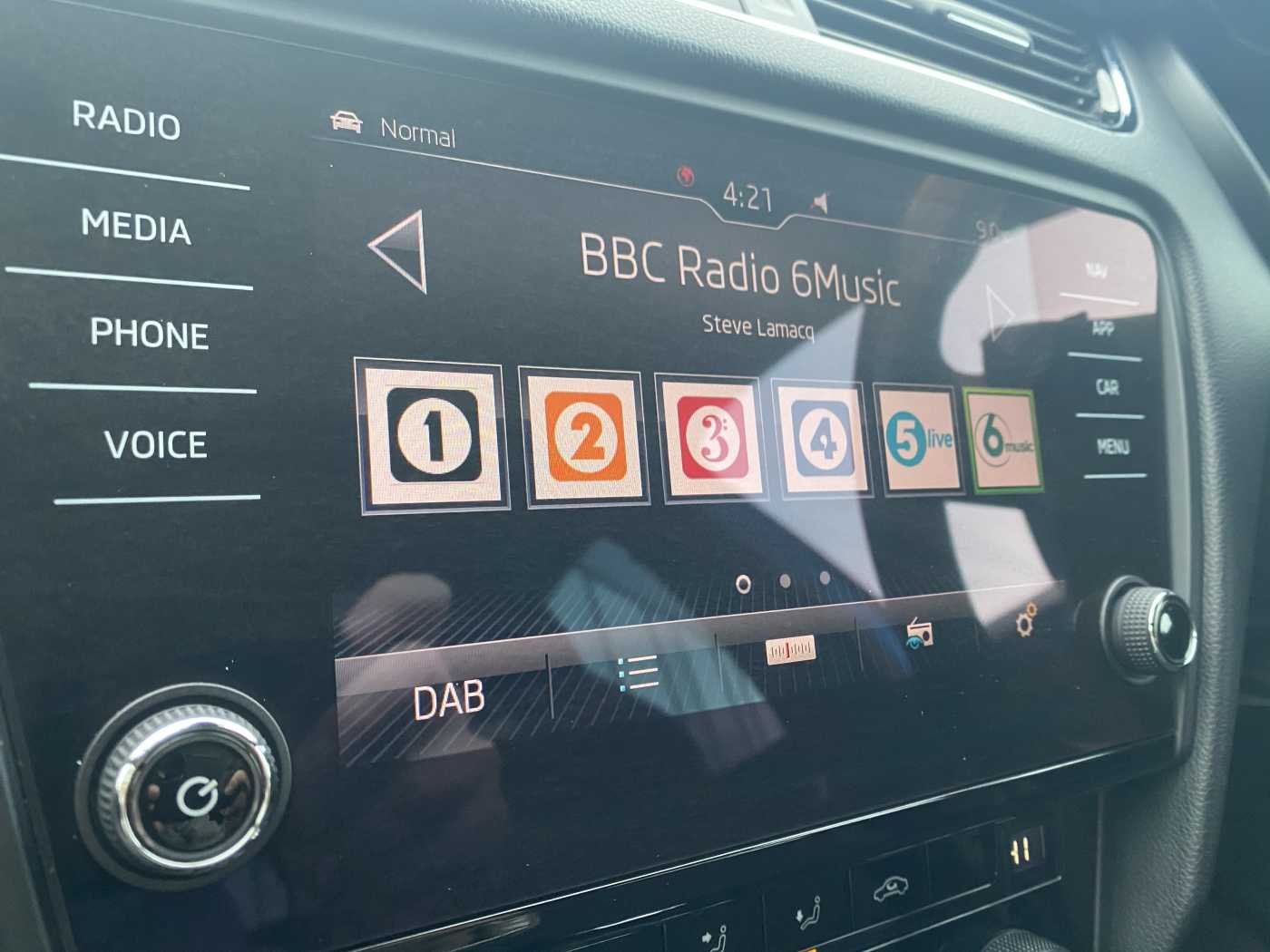

Sorry to bump an old thread, I've just coded this on a MY18 vRS but have a quick question.
For the individual setting, are you able to change the colour via the headunit? Seems some people are on later cars with this from factory:
Looking around online, it seems that it should be possible by setting Ambiente_Fahrprofil_Individual to 7.
When I set Ambiente_Fahrprofil_Individual to clash with any of the selectable Fahrprofil versions (1, 2, 3, 5, 7), selecting that option puts the headunit into disco mode! Basically the backlighting accent in the headunit will keep changing from the colour selected in manual mode and the colour set by that Fahrprofil option. As a temporary fix, I've set Ambiente_Fahrprofil_Individual to 9 (1 clashes with comfort) to avoid the conflict but it means I'd need VCDS (or similar) to change the individual colour choice :wondering:

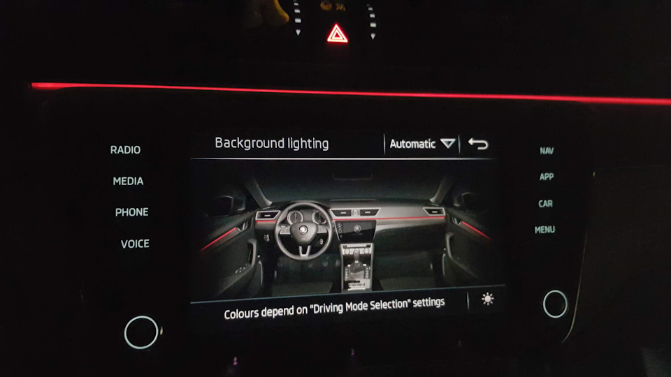

This is interesting as I have 3Q0 907 530 L 4326 and the coding takes and the auto mode is shown on the screen and it’s all there in the BCM, but when the mode is changed on Automatic it doesn’t change the colour on my car. My drive mode stays put though, does not default back to Normal. BCM is 5Q0 937 084 CG 0253
