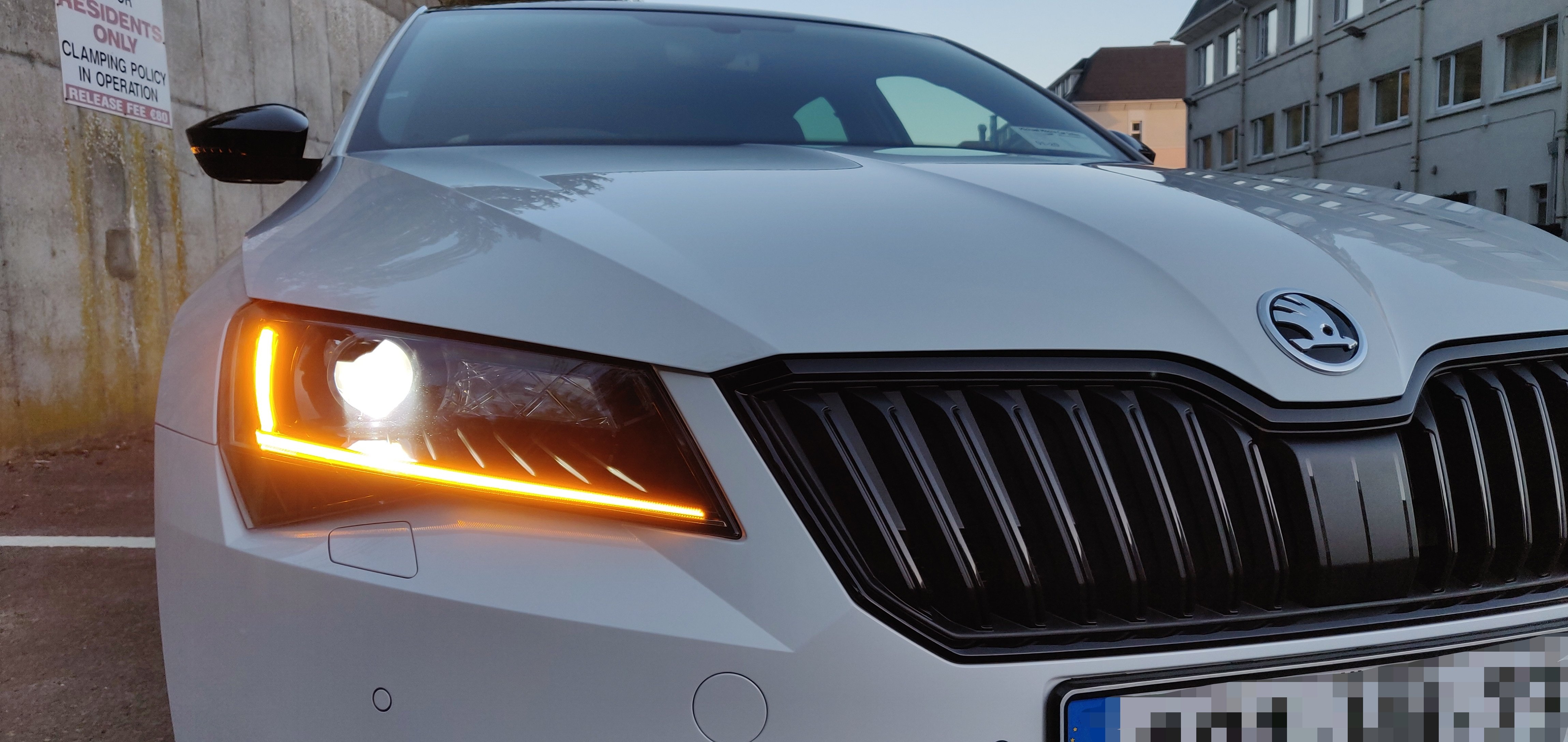

I am swapping out the stock black/chrome badges on my S3 sportline.
My S3 is moonwhite and I just think the chrome badges/lettering takes from the look of it..
I have attached the link tj the front one from superskoda below.
I can't seem to find a rear one like this. I have reached out to them and they have said the front won't fit the rear.
Has anybody had any experience with this before I pull the trigger and have to pay for shipping twice?
Thanks.

@Adaminski was that picture taken in Perranporth by chance?

@Adaminski was that picture taken in Perranporth by chance? Nope, it's in Athlone, Ireland! 😊
Looks very much like where my sis-in-law lives, in Perranporth. Right down to the parking permits and no parking signs!
