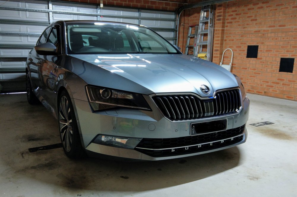

I put Eibach Prokit springs in my Superb.  Ride is still brilliant with the DCC shocks, and it looks much better.
Thanks for that.. Didn't sound right that's why I posted on here. Your car is sitting nicely there, good to know it hasn't changed the ride as the superb is probably the most comfortable car iv ever had

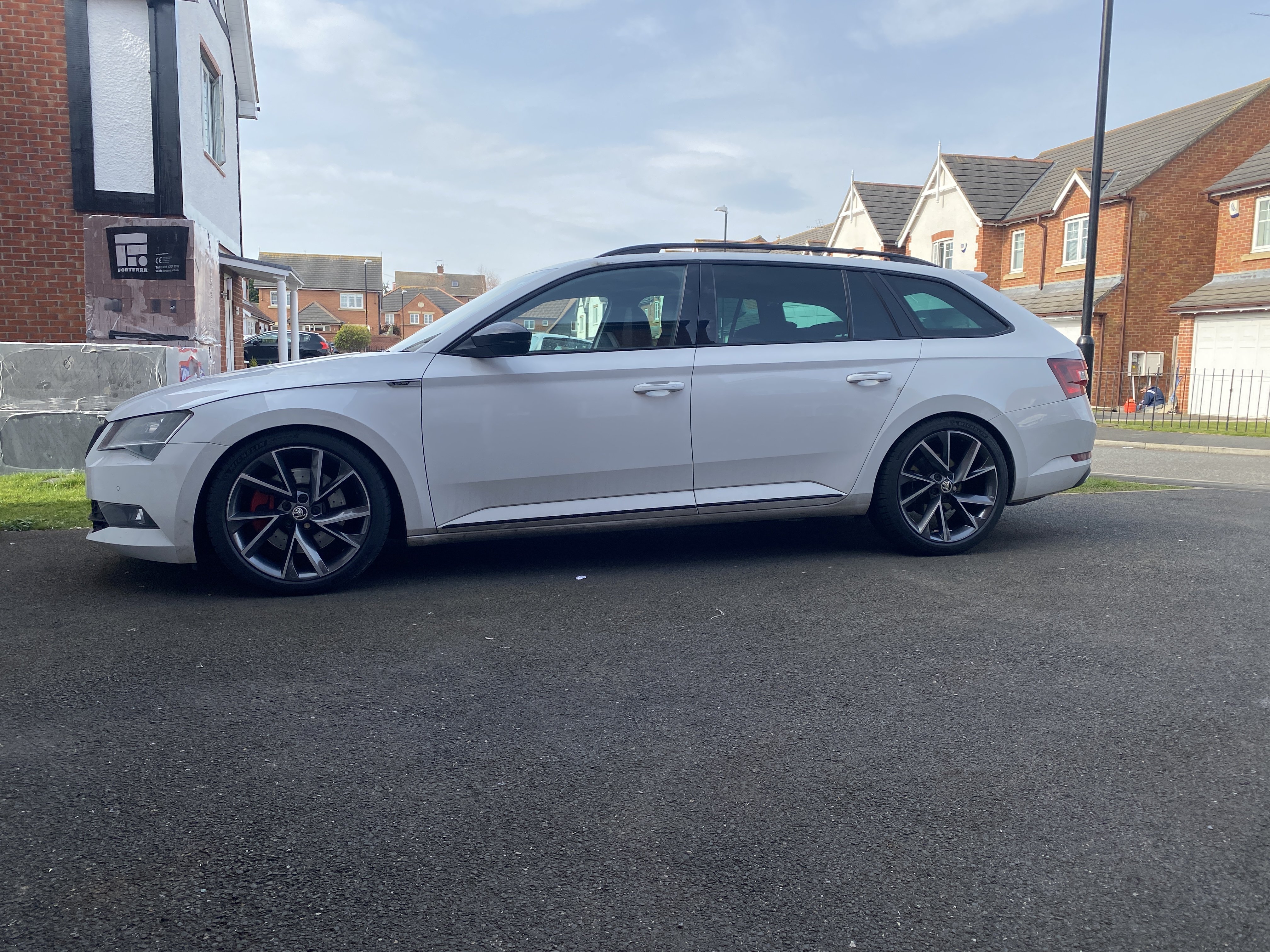

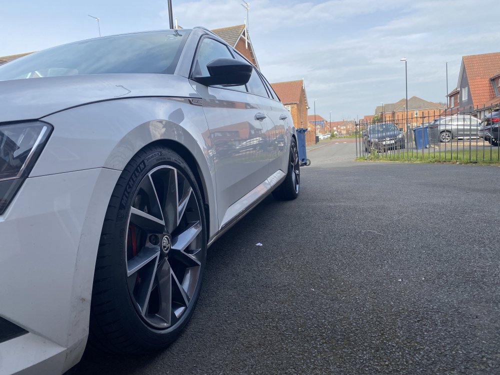

I’ve always had H&R on my vehicles. Had some in an octavia prior to my sportline. Pic attached is the sportline. Ride is a bit firmer but on 19’s, however still comfortable. I run 18’with winters on and it feels just like any other car. Handles well but not crashy.. Not sure on ride quality on a non sportline. @Markbro will tell you about that as his is a non sportline with H&R
Looks well on the h&rs, have a set of them ordered just have to wait for them to arrive now 😅
Good work mate you’ll not be disappointed, mine is on 12mm spacers tho too .

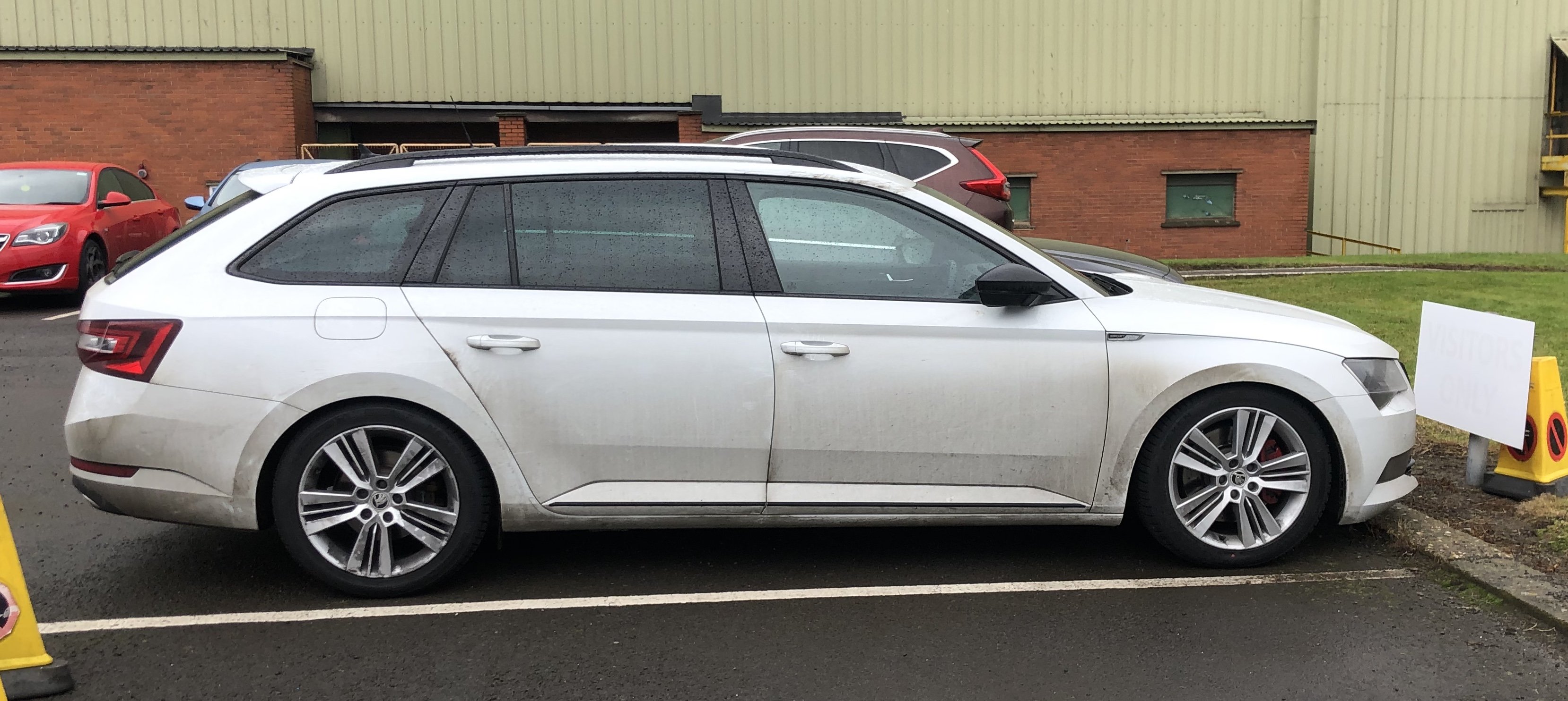

I had missed that thread and I am very close on going for springs. From looking at the two cars, the grey hatch on Eibachs seems to drop a bit less than the white estate on H&R, maybe 5mm less but I think it's noticeable.
Also, traditionally, owners who went with Eibachs reported a bit less drop than advertised, as opposed to ones who went for H&R (myself included) seemed to report a more noticeable drop. Given than I prefer a look closer to OEM the Eibachs seem to offer a result closer to the one I'm after this time so If I pull the trigger, it's those who I'll be going for.
