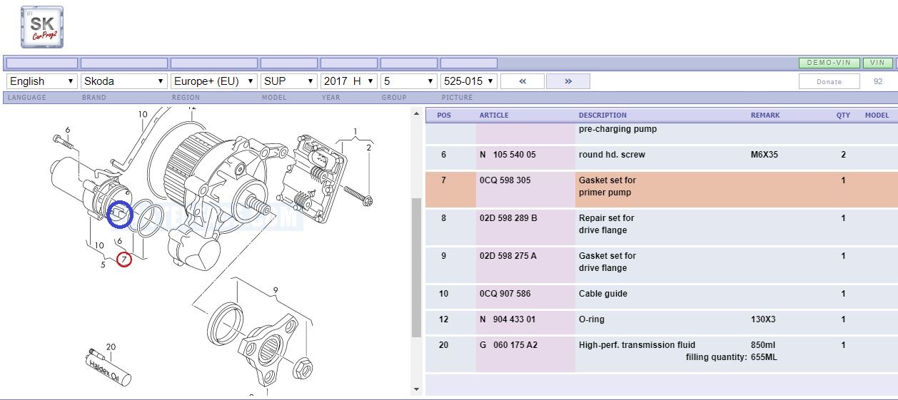

Anyway, when I change the Haldex oil, I will definitely remove the pump to clean the gauze filter and change both seals before reassembly. I viewed several tutorials on youtube and it looks quite simple. You effectively only need to remove the pump (mounted with 2 screws) to access this gauze filter (circled in blue below), which is also fixed with 2 screws.
I've found the seals P/N: see reference #7: 0CQ 598 305. It's around 15-16€ (found on ifinterface.com):
21 minutes ago, Bap33 said:
I didn't change the Haldex oil yet, since Skoda recommendation is every 3 years. According to yearly mileage, I was intending to replace it at 60000 km, upon DSG oil replacement.
