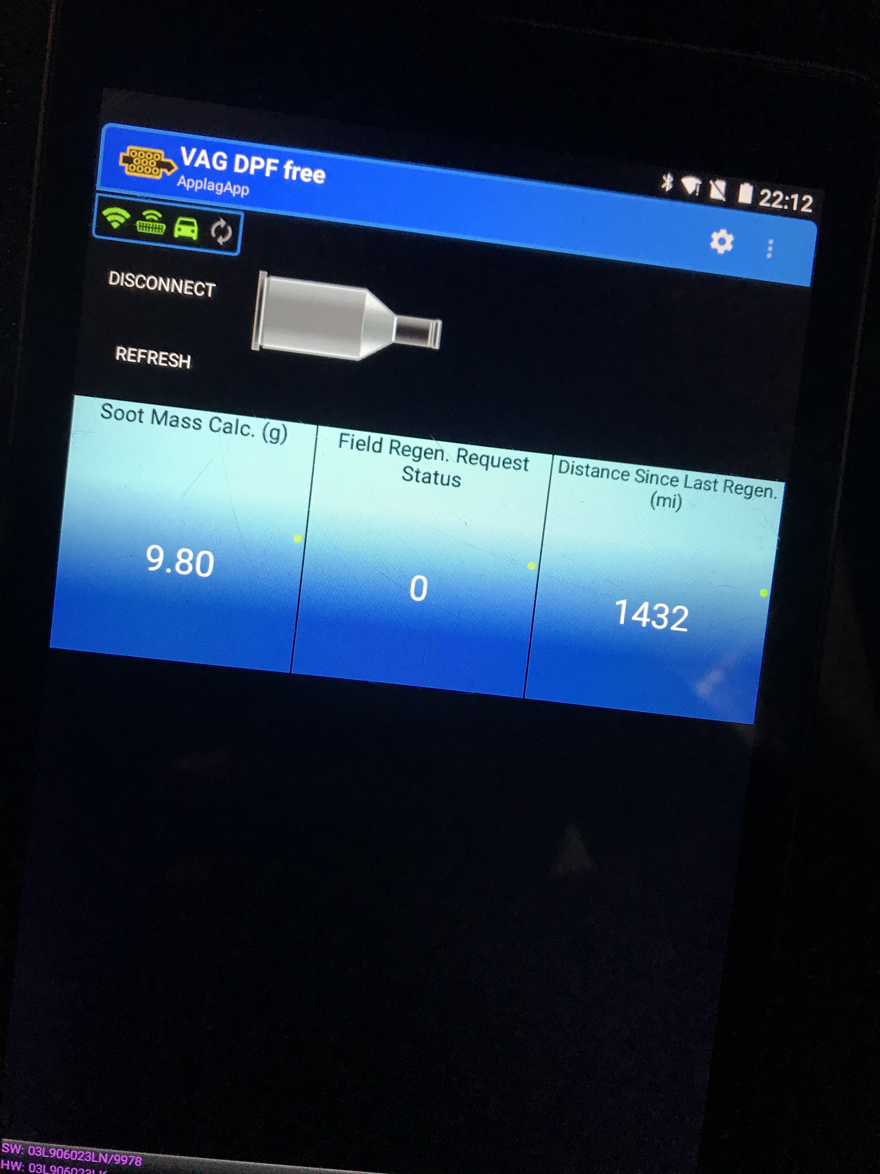

I’ve now plugged it into VAG DPF and seen that the last regen was done 1432m ago.

It's salvageable if you can get it to start a regen. By the looks of it you've done everything right to trigger one which suggests there's something up with the regen process itself, possibly sensors. At this point I think you may need to take it to a mechanic who is familiar with the setup to get a more detailed diagnosis. If you have the paid version of VAG DPF it might shed a little more light on the situation in the meantime.
There's no such thing as a red DPF light, they're always orange on Skoda's.
You need to scan the car with a code reader, there is something preventing the DPF from initiating a regeneration, as mentioned it's likely to be a faulty sensor.
If you keep driving the car, especially at high revs then all you're going to do is fill the DPF to a point it blocks and drops into limp-home mode.  You'll then not be able to clear it yourself.
DPF sensors are well documented as failing, if they aren't able to measure the pressures at either side of the DPF they won't allow it to regenerate.

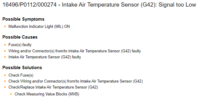

The only code I’m getting is P0112. The IAT is reading at 130c, and doesn’t move. Nor below or above. I’m feeling that this could be responsible, I’m struggling to get a multimeter to check the harnest going to the MAF Meter.
Would I be right I’m doing do?
Its plausible this may be why your car is not initiating a regen so it would be a good idea to sort that first but don't drive it unless you are taking it somewhere for them to fix it.
I too would think it could be part of your issue, the G42 sensor is related to the DPF...
I'd be looking to replace the sensor ASAP.

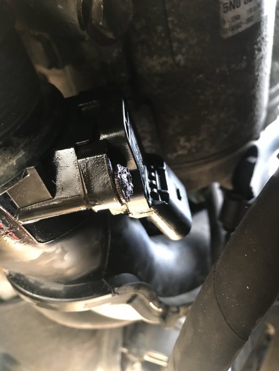

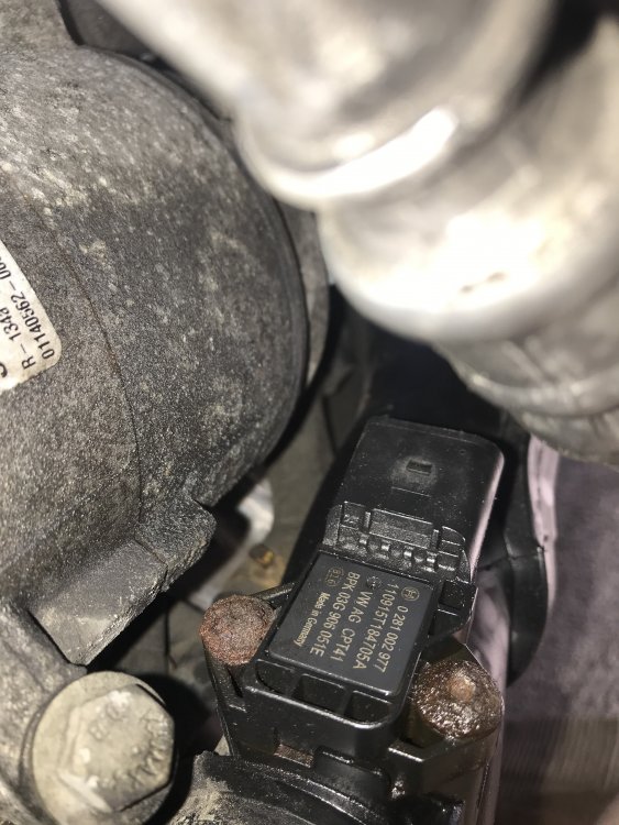

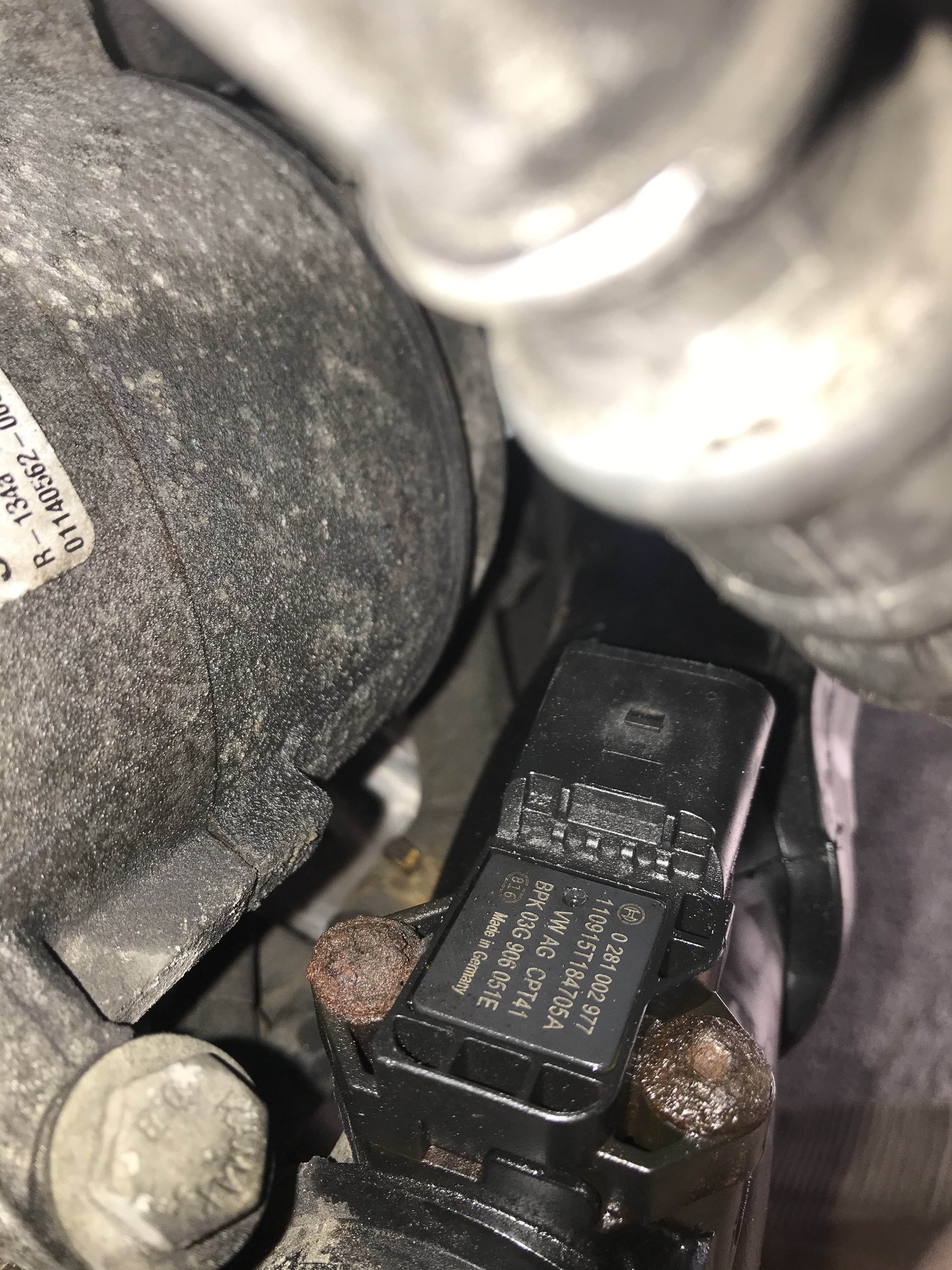

So as it happens, the new map sensor came today and I can confirm that is what was causing the code. I’ve unplugged the wiring harnest and plugged it into the new one and voila, normal IAT.
Now I can’t get the 2 screws that bolts into the intake as they’ve rusted up. Inside and outside. 🧐
Better view here:
