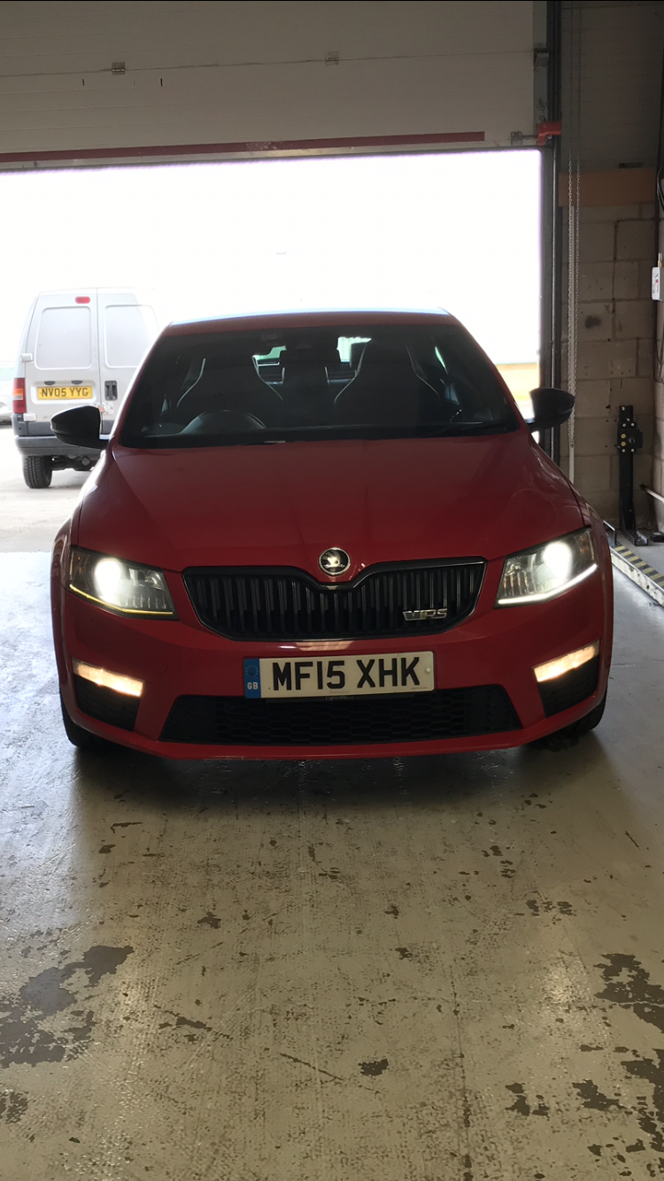

Hello,
The LED DRL is dim on my drivers side headlight. Local dealer says new headlight required (£750) as it’s a sealed unit. Is this the case?
Any help appreciated.
Matt

Thanks @StephenVRS - absolutely fantastic detailed response. Much appreciated. I’ll definitely check/swap that module. Gutted that it’s a bumper off job though.

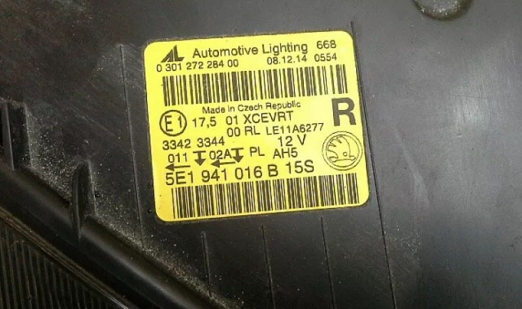

@SashaGrace - As luck would have it, I do have a spare drivers headlight, but it’s from a LHD vehicle, so I don’t know whether it would be suitable (part code is 1 digit different from UK version)
Finding a completely intact headlight for £100 isn’t that easy, but I got lucky with this one (it came from Lithuania!) for £100 including postage.

I could obviously do that, but I’d rather fix it if possible.
As for being an MOT failure, Simpsons Skoda at Colne told me that it was a failure on a pre-MOT check they carried out, due to it bringing a warning light on the dashboard, however my local MOT centre passed it fine, with just an advisory.
You won’t be able to use the LHD light as the aim is different but the DRL controller should have the same part number. That said, these cars have a separate sidelight and at this age don’t need a DRL to be legal or pass an MoT.
