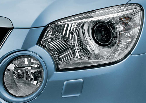

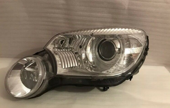

Are you sure the very first bit is right? "Skoda Yeti with separate DRL" sounds like a pre-facelift model to me. On your '15 the DRLs are integrated into the main headlights - not separate.
Which one u recon it should be?
Some early models utilised the dipped beam to operate as DRL's. The term 'separate' refers to the DRL using a separate bulb to that of the dipped headlight bulb.
On a Yeti?
That has never been the case, they have always had a seperate bulb in a seperate unit.
By 'models' I meant the MkII Superb, as an example, I should have said 'other' models.
The coding descriptions are however the same across multiple models. The use of the word 'separate' is to distinguish between dipped headlights and dedicated DRL's.
Although in the UK all Yeti's came with the separate DRL's activated, it is still possible, using VCDS to change the DRL function to use the dipped headlight bulbs instead (or the front fog lights, as per the OP's possible issue), so it may be that different country's / regions of the world had different set-ups.
Another little interesting fact that some owners don't realise is that the headlight and fog light/DRL clusters on the pre-FL Yeti are in fact one combined unit...
