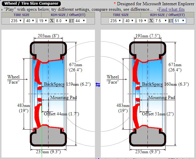

The Octavia RS has 19x7.5" wide rims while the Superb has 19x8" wide rims....
Edited by JR RS
Superb Mk3: 8JX19" ET44
Octavia MK3 RS: 7,5JX19" ET51
It may need 6 mm spacers. Additionally, tyres will be more 'rounded'...

According to ETRTO, 235/40R19 tyres need at least 8J rims so won't officially fit the narrower Octavia's 7.5J rims. However, ETRTO does allow the fitment of 245/45R19 tyres on 7.5J rims, so 235/40R19 tyres on 7.5J rims wouldn't be an extreme fit. There's no need to fit spacers. ET51 instead of ET44 is only a 7mm difference in offset. Together with the 0.5" narrower 7.5J rims, you can park 13.35mm closer to the kerb before scrapping the edge of the rims...and because the sidewalls will bulge out a bit more you should be able to feel the tyre sidewalls touching the kerb before the rims. Looks like a win, win situation...if you don't mind breaking ETRTO's rules.
