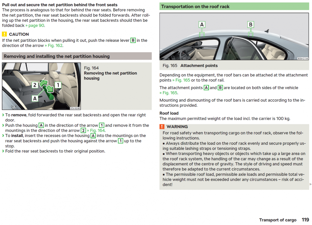

It's in the handbook, but very unclear in the brochure and options list!

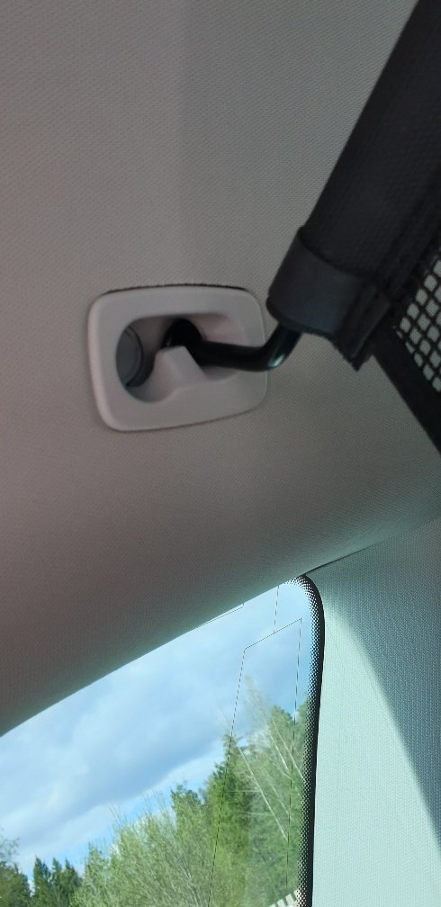

I've managed to find a video that you can just about see the luggage net bar in
If you pause this after about 5 secs https://www.youtube.com/watch?v=SZ4Pohhkxfs&t=140s
You can see the large dark bar under the load cover and if you are watching on a large screen you can just about make out the 'cow horns' on the net
I can't quite see the ceiling lugs to hold it but they must be there
I'm guessing it wont go under the floor when not in use ? but TBH that is less important than being able to put the load cover under there which is SUCH a useful feature, I don't understand why more OEMs don't do it
@scot5 Yes I've had E-Classes with similar 'all in one' and they are such a pain to move about and not being able to store elsewhere in car when they would otherwise be in the way of the load is such a pain. The Skoda solution looks far superior :)
On the ceiling lugs I wonder f they are a post built dealer fit ? i.e the metal sockets are already in the roof and the dealer just has to put a bradle through the headlining and click the plastic lugs into place ? The net is only £150 so I can't imagine there is a special section for it on the production line

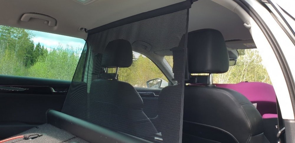

I have a superb with the nets.
there are 2 nets that fit along the sides, in effect over the wheels and the third spreads over the floor of the boot, none of them fit along the back seats, although you can sort of put one of the side ones there but it doesnt fix very well.
Best video yet for showing net attached to back seats
about 25 mins in for black ceiling lugs
and before that when rear seats are folded you see the net roll itself

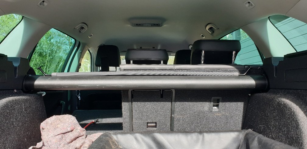

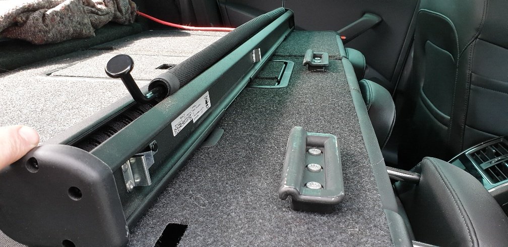

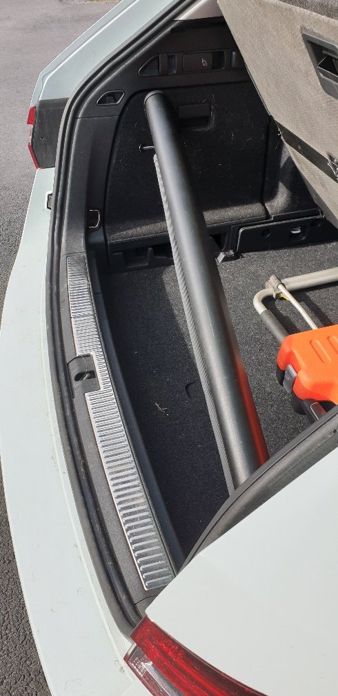

Attached pictures of my car with net in the two different positions.
It doesn't fit under the false floor, not sideways anyway. Easy to attach and deatttache.
Missed two pics.

Also I think I’ve seen it but just to check the load cover still fits over the top of the retracted net when the rear seats are upright?
3 hours ago, MiniEggs said:
Good to hear you are having a good experience
how is the leather wearing at 100k or whatever you have got to. I wish they did a tan colour instead of that horrible chocolate brown 😁
Leather is ok 120000km, but my car has black seats. I'll post a photo of my driverseat when I'm out on my next trip :)
The cover sits right behind the net and the little flap on the cover fits tightly against the net cassette.
