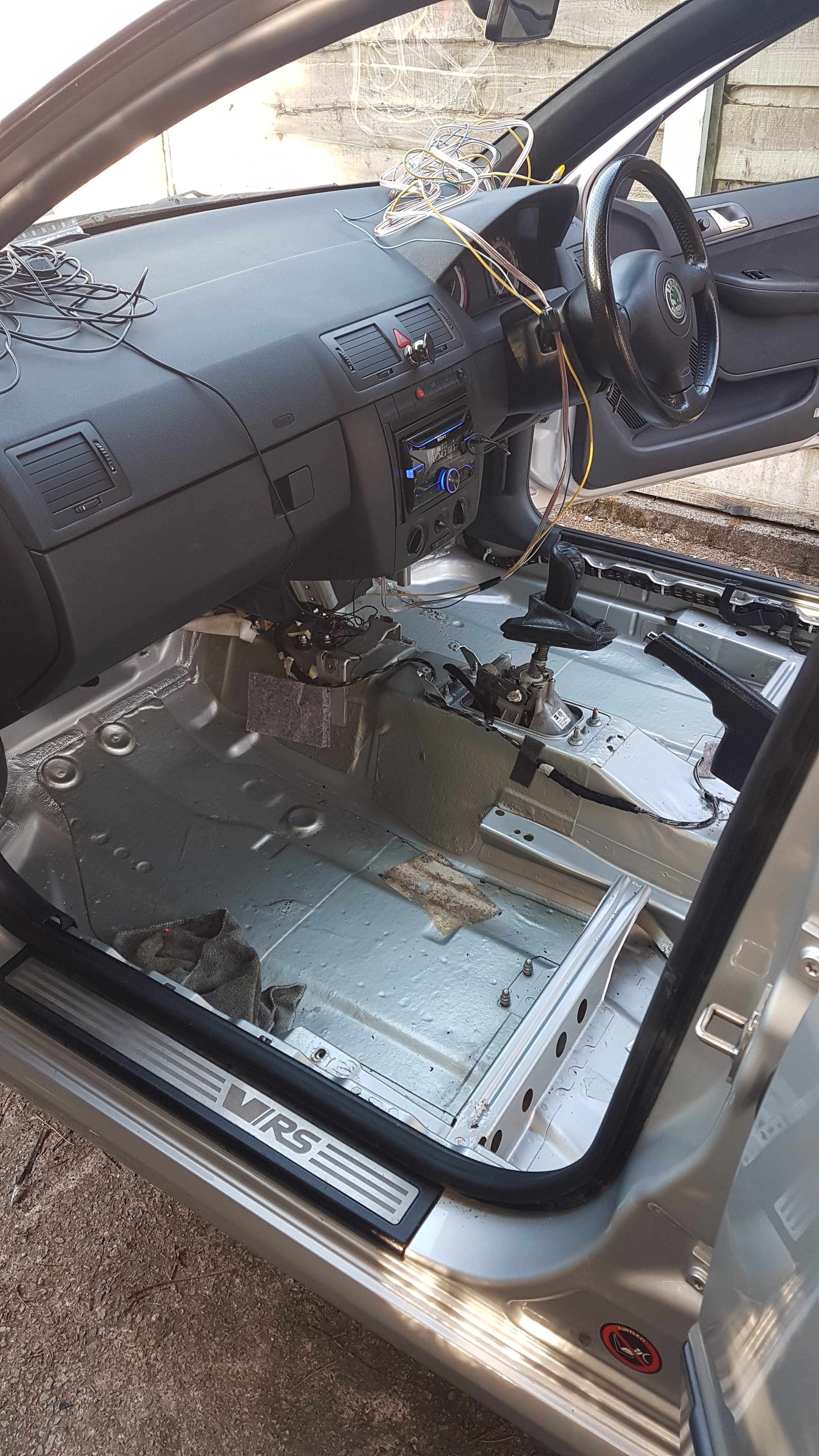

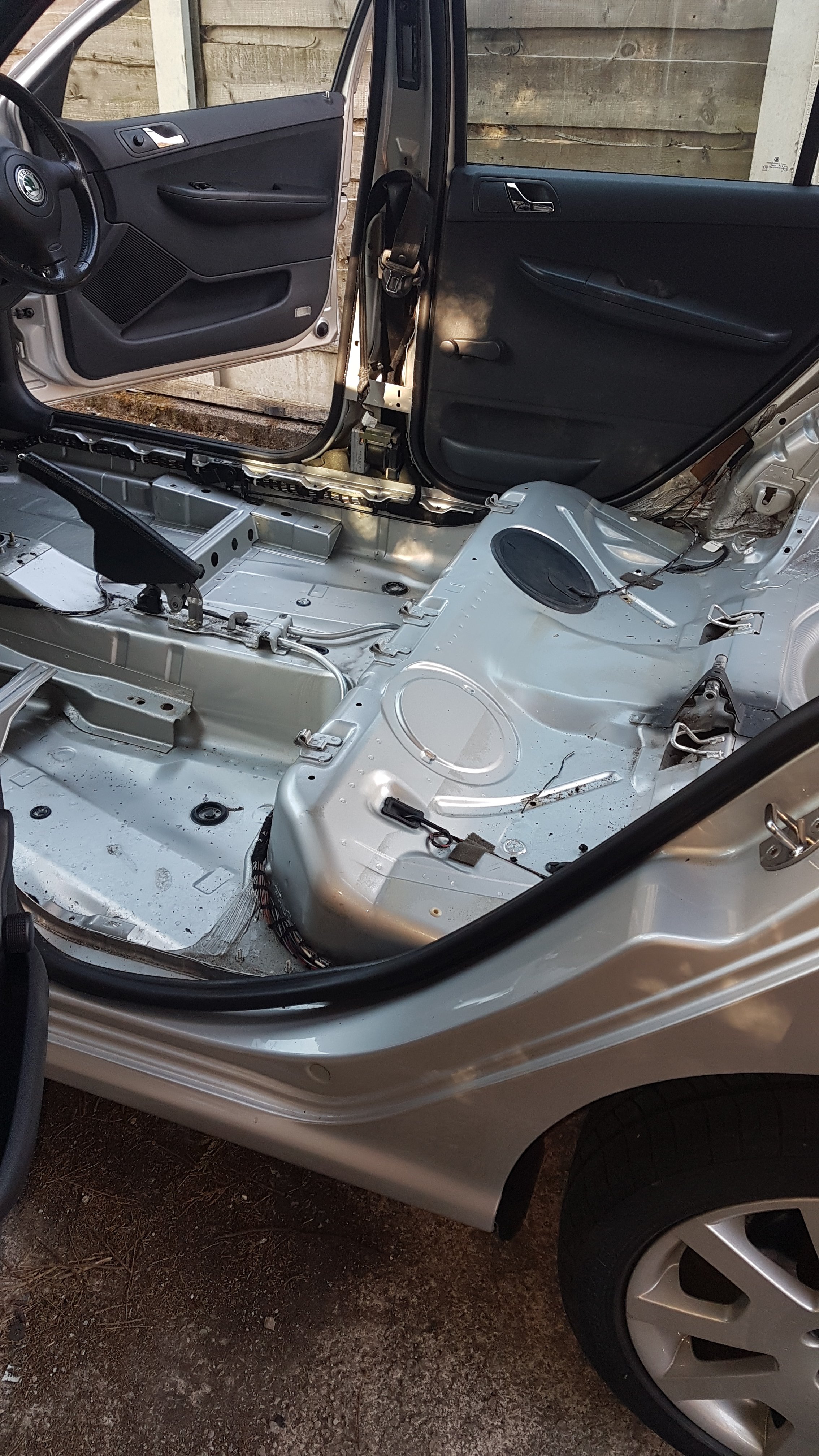

We are in the middle of soundproofing the car. We have completed stripped out the boot area in preparation as this seems the area that would mostly benefit.  Just now looking at purchasing sound deadening and then adding closed cell foam.
Can anyone share any tips or tricks? Suitable thickness of foam? How much actual sound deadening material to add? I read so many conflicting ways to do the job effectively without going overboard. I'm mainly trying to eliminate in cabin noise , but some audio benefits would be a bonus.

Never thought of doubling it up. Good idea. Car completely stripped out today. I found a good level of sound proofing in the front. Deadened, felt and vinyl matting on top. Nothing much in the rear foot Wells or boot though
Yeah, they don't put much at the back.

Looks like it's the same as yours then. The deadening and sound proof looks decent to me as well. I think iure right about the rear as it's got basically nothing except abit of felt under the rear foot Wells
