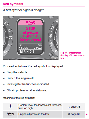

Red warning is generally low pressure, never heard of a red oil light meaning anything else; a read of the Owner's Manual would help.   @Scoutuser how far above max was the level?

I would have to guess at about 1 inch. However it is difficult to pull the dipstick out without dragging it on the side of the tube meaning I couldn't be certain.
In terms of warning light, manual suggests only one warning light relating to oil pressure being too low. It just so happens that the oil warning light is often due to lack of oil. It is definitely related to pressure issues, regardless of volume. You can still have a low pressure warning with increased oil volume.
