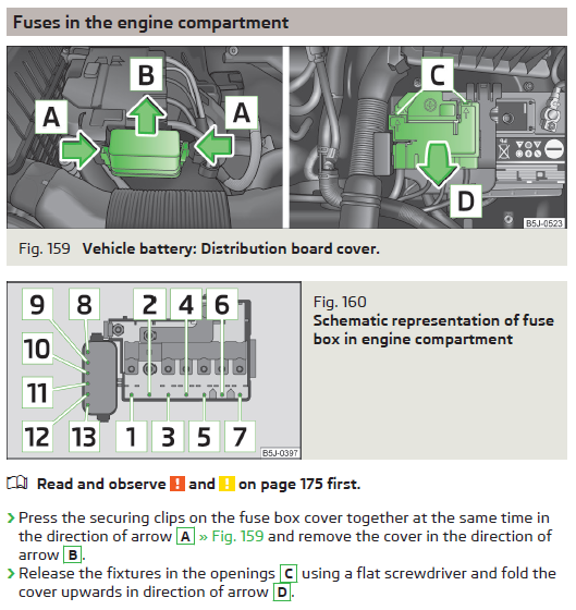

Could the noise be emanating through the bulkhead from the engine bay? There are a selection of relays in the secondary fuse box close to the battery.
Try inducing the noise with the bonnet open and the lid off the fuse box...
