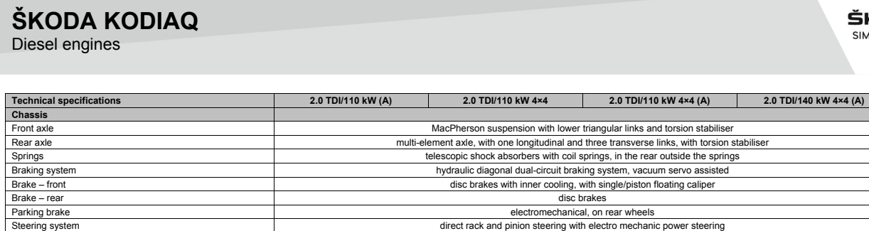

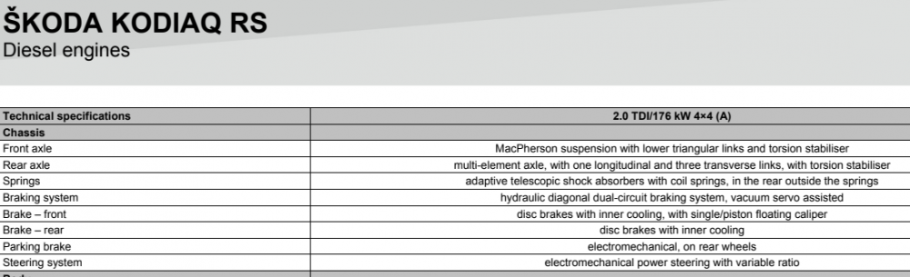

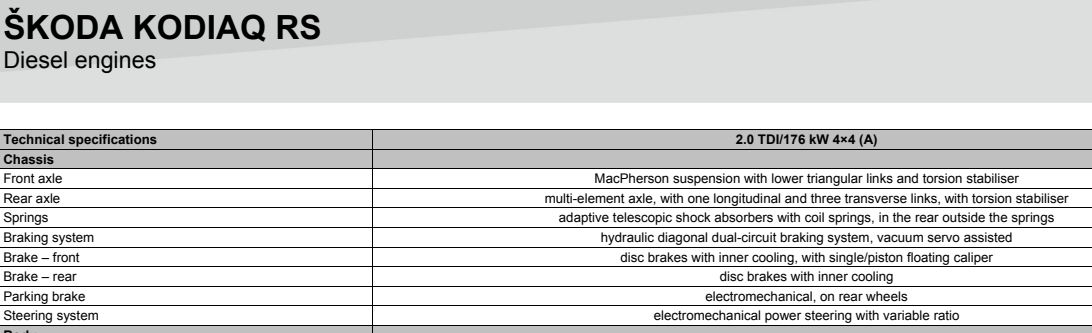

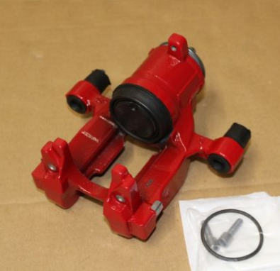

Where's your source on this? Looking at Skoda's technical data sheet, they list single floating piston for the calipers.

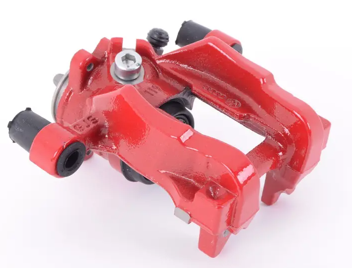

I've also taken a look at the part numbers (front: 5G0615123B/5G0615124B, rear 8V0615423A/8V0615424A) and they're both single piston floating calipers, fronts from the Octavia RS and rears from the Audi RS3.
5G0615123B,SKODA 5G0615123B Brake Caliper for SKODAimage.png.4b458eadfde537b5f466e113a71aa599.png

Are they?
Just the front caliper size says they have 2 pistons each. If only one, why to bother at all? Yeah, bigger piston and red paint, but anyway?

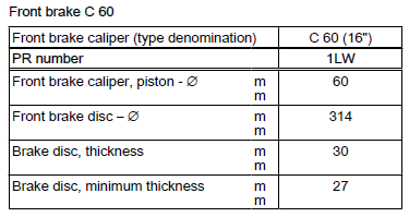

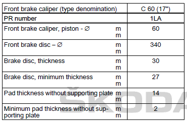

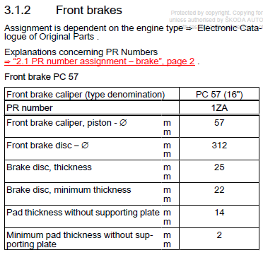

If the vRS has the same size discs as the non-vRS then these are the non-vRS brake specs for the UK.
However there are three different front brake disc sizes depending on the engine fitted.
Presumably the vRS will use the largest of the three...
1ZA @ 312mm
1LW @ 314mm
1LA @ 340mm
1ZA...
1LW...
1LA...

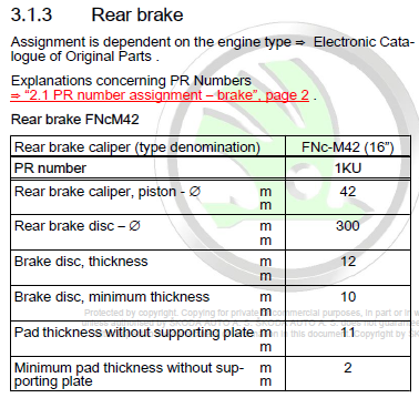

The rear discs are all the same, 1KU @ 300mm.
1KU...

The TTS calipers have 4 fixed pistons while the Kodiaq RS ones are single floating/sliding calipers. There will be a big improvement on clamping force, obviously at the cost for increased pad/rotor wear.

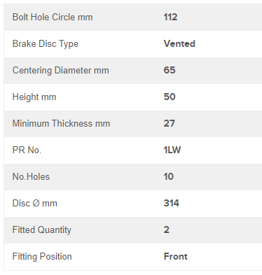

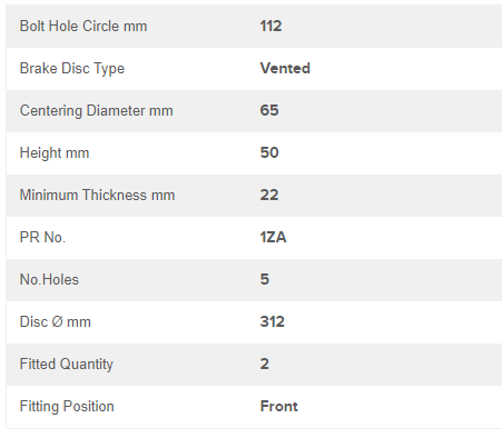

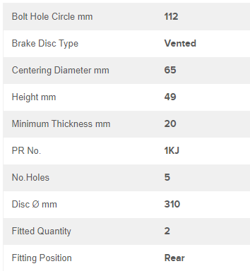

Kodiaq vRS front discs, according to Euro Car Parts are available in two diameters...
1ZA @ 312mm
1LW @ 314mm...
Kodiaq vRS rear discs, 1KJ @ 310mm...
Not that ECP can be trusted all of the time!
So, conclusion - Kodiaq RS has the same front (and rear) discs as other Kodiaq top models (340 mm), maybe slightly bigger piston in caliper.
And red paint, which dosn`t give any extra horsepower unfortunately.
340 mm definitely, just measured.
Eurocarparts seem to be desinformed.
