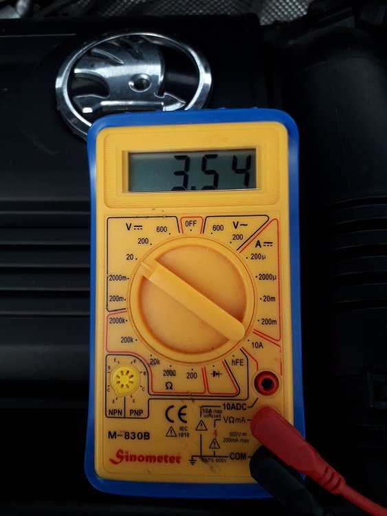

I then touched the positive terminal on the car battery with the red probe, and then the negative terminal (both the seperate jump start contact point, and the battery terminal itself) with the black probe.
The voltage was reading on the multimeter display somewhere between 3V and 4V, which threw me.
The engine was off, the engine hadn't been started since a few days prior. The ignition was off and again hadn't been turned on for a few days.
Later today I used to car to pop to the supermarket and it started fine, so presumably the battery is OK.
With the engine off I was expecting to see something close to 12.6V, with 12.2V or below sign of a severely or dead battery.
So 3V has me confused. What was I doing wrong?

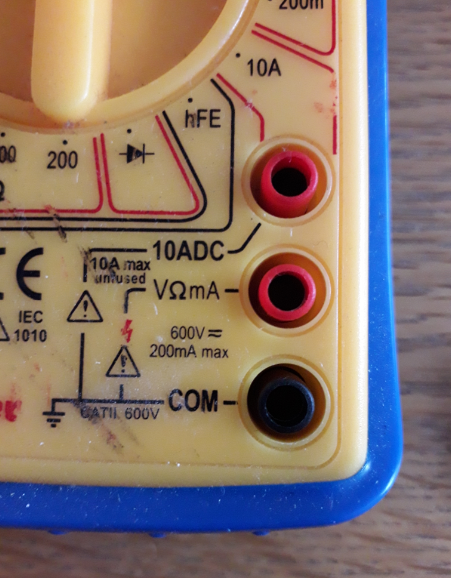

The probes were plugged into (from the top) the second and third sockets (red into red and black into black)...

Not super clear but maybe it should be top connector and bottom one ?

The top one is to measure current and not voltage.
The leads are connected correctly for measuring voltage, the top red connector is for measuring current.

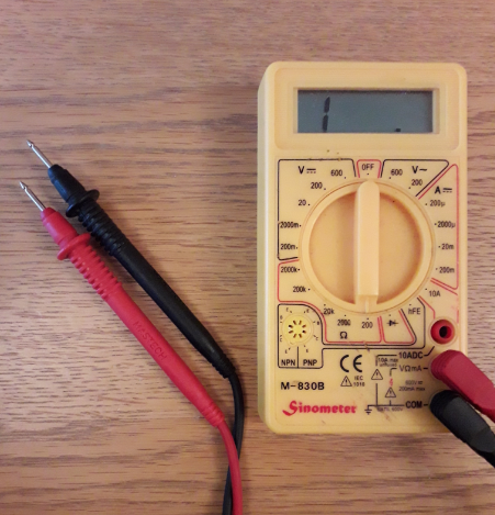

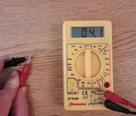

If you turn the selector to the 200 ohm position and touch the two probes together, what is the resistance of the leads?
Without the probes touching...
With the probes touching...
4.1 ohms not perfect but close enough not to influence voltage readings by much.

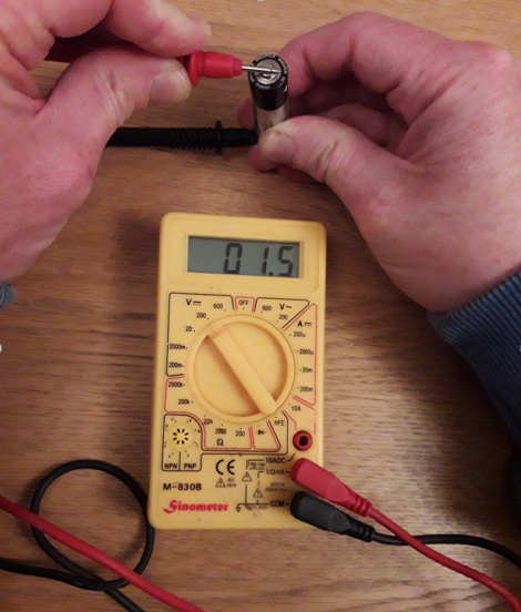

Have you tried measuring the voltage of say an AA battery or such likes to see how much the readings are out.
Also If testing using probes on the car battery terminals you might need to rub the probe across the surface to make good contact, or test on the bright battery cable connectors.
Good idea Kenny.
A brand new 1.5V AA battery...

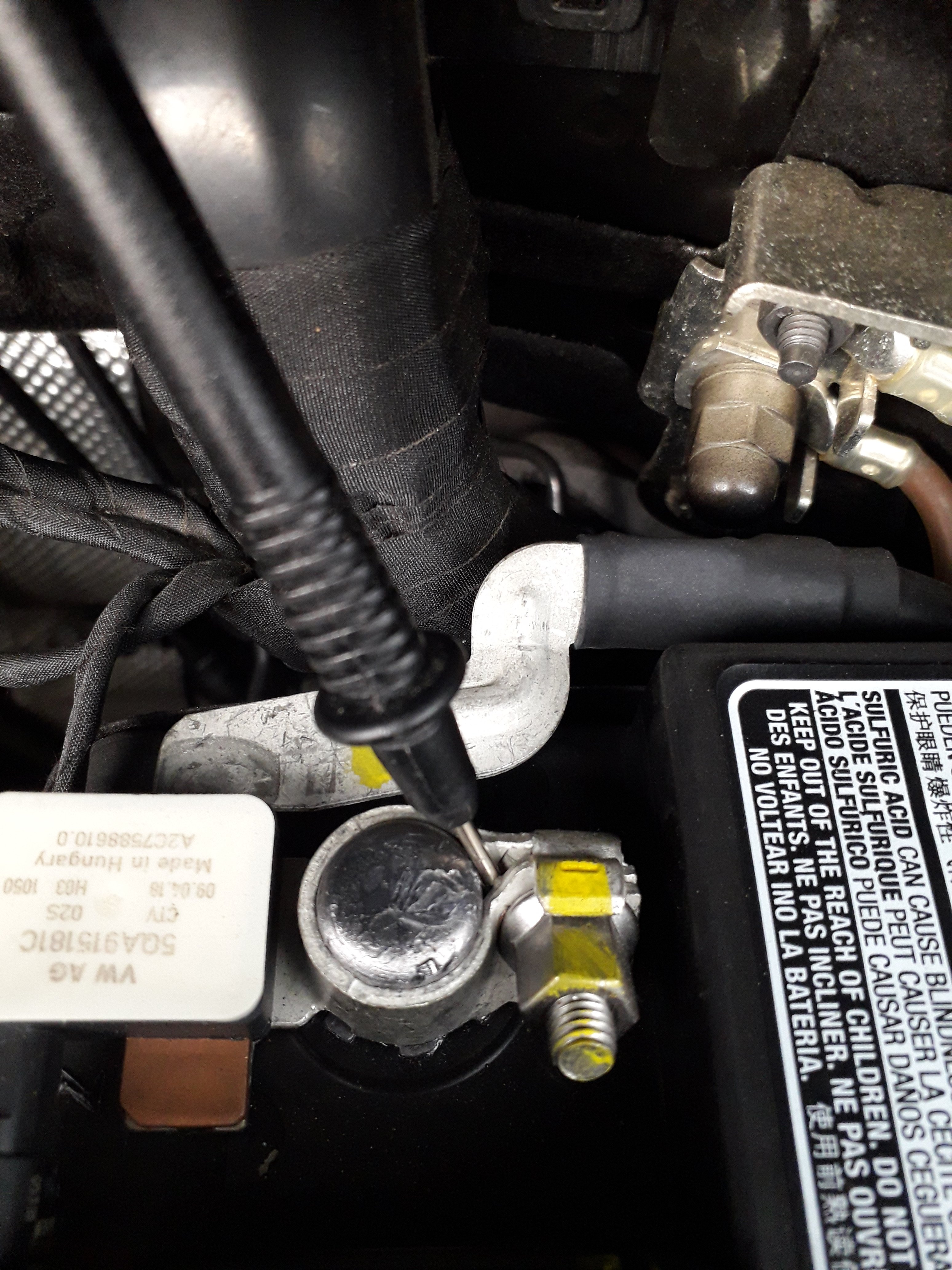

I'm clearly not getting a proper connection from the car battery terminals, although aside from loosening them and squeezing the probes down the sides of the terminals I'm not sure what more I can do.

The terminal posts are soft, just scrape the surface a little with the probes to reveal shiny fresh metal to contact.
little bit of sand paper and rub the tops of terminals. and press the probes hard onto them.  should give a decent connection

I have the same multimeter. black in the top one, red in the middle gives correct readings on voltage and resistance.

Mine is the same generic one. The DC voltage and resistance work with the black lead in either the top or bottom positions, just checked it.

Do not under any circumstance try to measure your battery voltage using the top connector marked 10A!! This connection is joined to the bottom black connector via a very low resistance current shunt, its unfused and is used for high current range measurement only. If you did try to measure your car battery with leads connected top and bottom connectors you would be effectively shorting the battery out! You will then briefly see some sparks, an interesting combination of melting meter and leads and weld the probes to the battery posts at which point you will probably start screamimg before things start glowing red and.....💥   🚑

Thats because of the current shunt. But it is the incorrect way to connect it.
To measure ac or dc volts or resistance use the bottom two connectors only.
Meter probes don't work well on lead posts unless you prod hard, instead use the tensioning bolt on the +ve terminal connector and the charging ground tab for the -ve probe.

Use only the terminals for what they are labelled as, also make sure the setting on dial is correct before testing - else the magic smoke escapes, sometimes noisily ⚡ 🌟🌪️

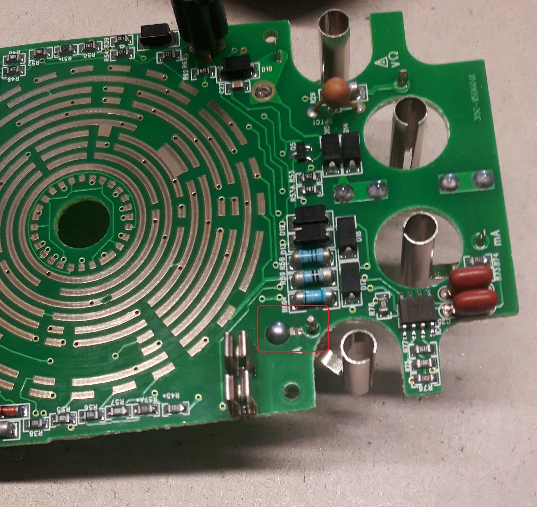

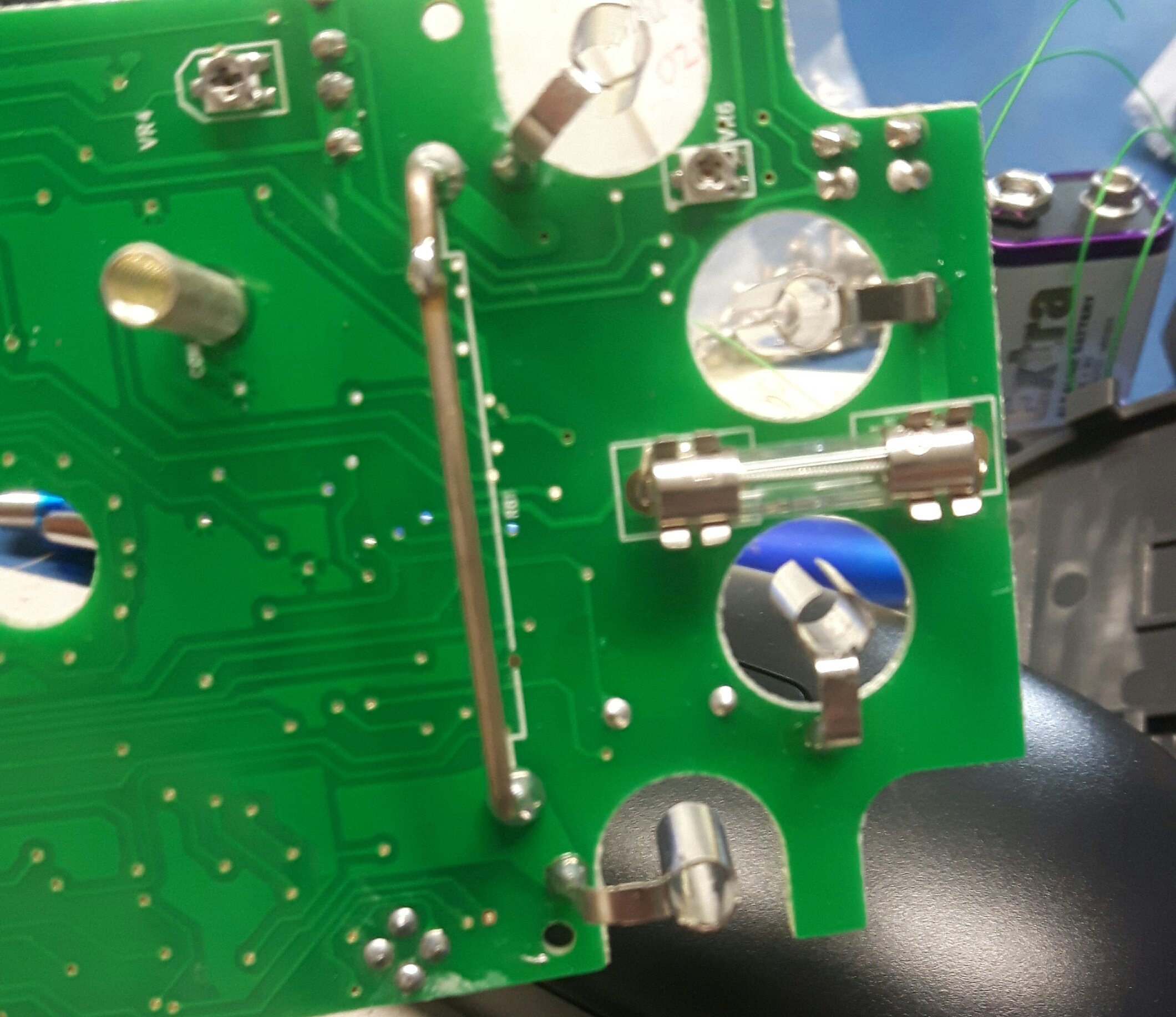

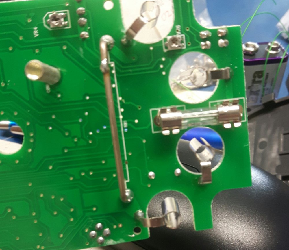

A few weeks ago while checking elderly neighbours' batteries I was swapping between current measurements and voltage measurements with insufficient care and attention when I managed to do this faux-pas on a cheap meter.  There was the subtlest of 'phut' noises from within the meter followed by an unexpected reading of 0.  Realising what I'd done, there was a slightly louder sound approximating 'phut'...

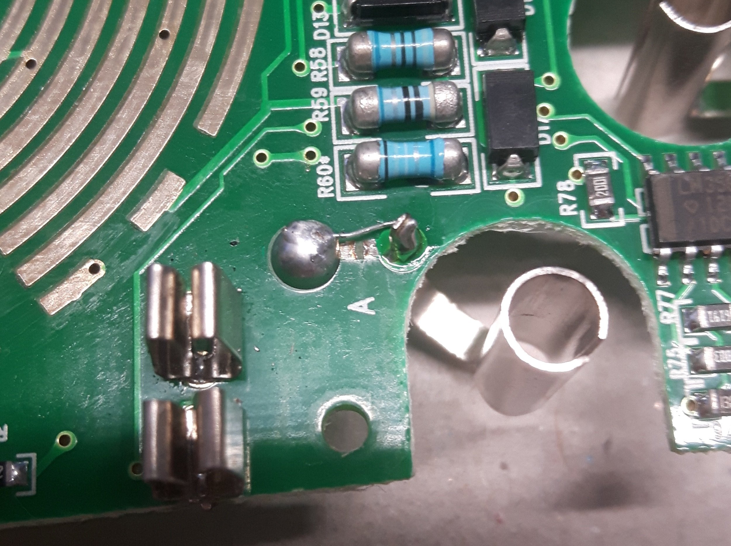

I finally got round to fixing it just now.  A not-so-wide PCB track links the 10A DC socket to one end of the current shunt, and it had 'popped' as it would be expected to when presented with lots and lots of amperes.
A thin bit of wire soldered in its place and all is back up and running.  Including a picture of the current shunt (thick bridge of wire linking common and 10A input skts, top and bottom ones in last, blurry pic) for the hell of it while I have it apart, to show what xman means.  That wire has a small, but known resistance which causes a voltage to be developed between its ends when a large current flows through it, which the meter measures and converts into a current value.

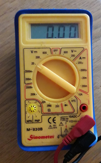

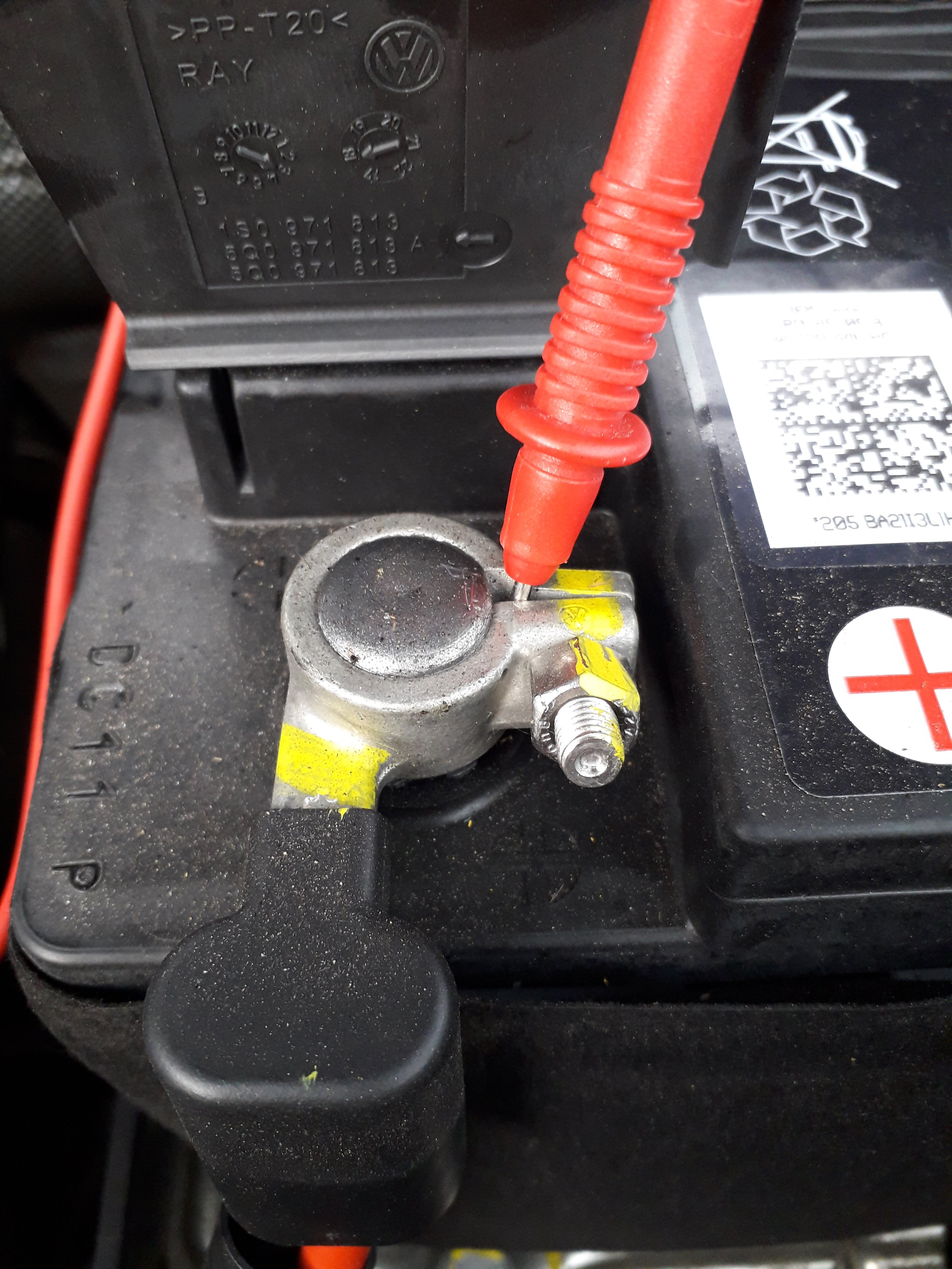

I had another quick try, no real improvement...
Tried several different locations for the probes, none of which seemed to make any discernible difference.
The only potential positive is that the voltage was fluctuating between 0.5V to 1V every second or so, each time it returned to the higher voltage reading it was slightly higher. In the 2 or 3 minutes I left the multimeter connected the voltage increased from around 2V to just over 4V. If I'd left it connected it might have eventually reached a normal reading, but not one I'd probably be able to trust as being accurate...
I'll try my other car tomorrow to see if that results in the same readings...

See what reading it gives on the 200 volt range. (thats what you used with the AA battery test)
Could be the 20 volt range is fubared.
