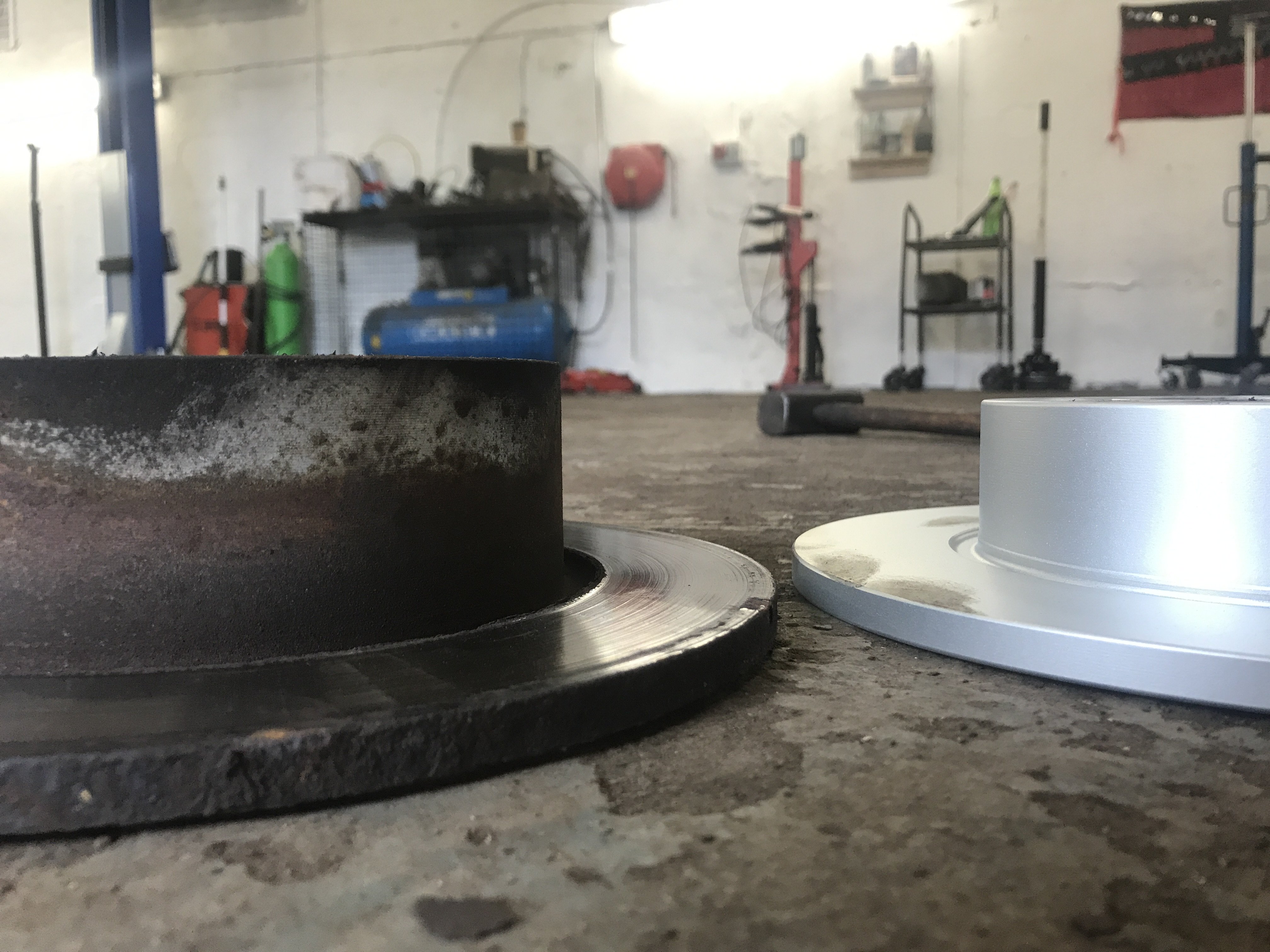

I’m needing to change my rear discs and pads.
got a set before lockdown but it appears that there is a later different disc that the factors don’t list yet so might be a trip to TPS or the dealer.

Unfortunately not, facelift 1.6 diesel estate.the disc was the exact same size but the hub was a different thickness can remember which way the pads were the same.
The guy at factors though he had a similar issue before.

There appears only one listed but the hub is bigger.
