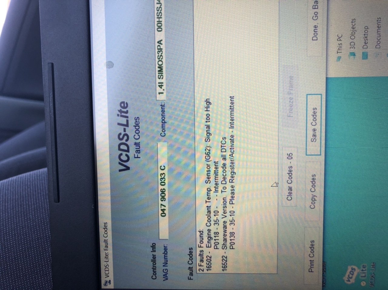

can you make sense of any of them codes in the pictures?
  • Sponsor
Either the expansion tank sensor prongs, or there's something amiss about your coolant.  Does it look nice and clear and pink?
Try the following experiment the morning after you next drive the car. With the engine stone cold, remove the cap of the expansion tank whilst listening for any hiss of escaping pressure. It's usually readily audible if there is residual pressure, as long as there aren't too many background noises going on.
Your post above came in while I was typing the above, so all I'll say so far on those codes is that it's interesting that there is one from the coolant temperature sensor circuit.  My neck isn't quite flexible enough to study them properly just now.

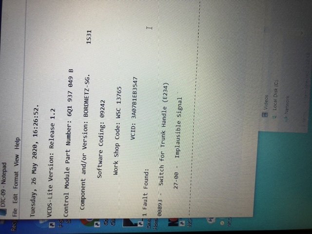

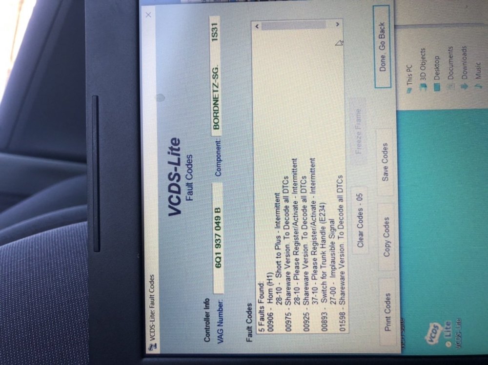

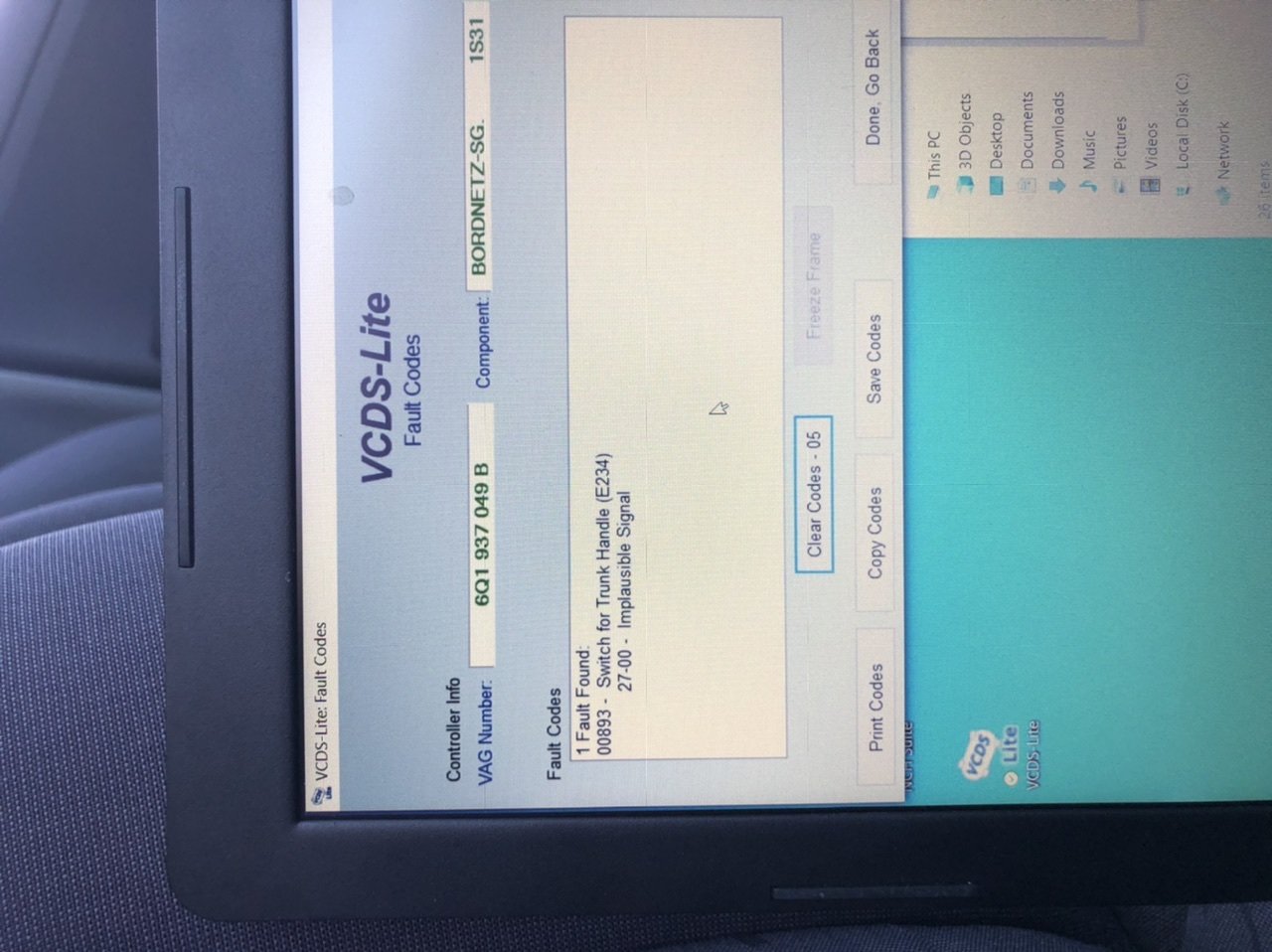

Try reading fault codes from module 17, Instruments, and see what it says.
Did that before whilst looking at a few things today including cleaning some connectors.
instruments came up with 2 faults.
1) 00896-Trunk lock unit
2) 00893 (wouldn’t tell me that one without registering)
Engine Module 1 fault
16522- Lambda sensor B1 S2.

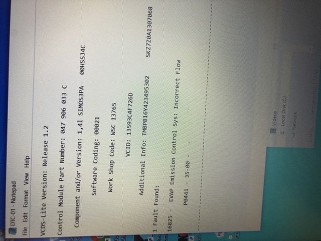

Okay. So been running the car for about 2 weeks now. Had an engine management light come on so plugged in and scanned the engine and instrument modules.
Only the two codes and neither seem related to the coolant system. So no ideas why the light still comes on.
Any ideas?
