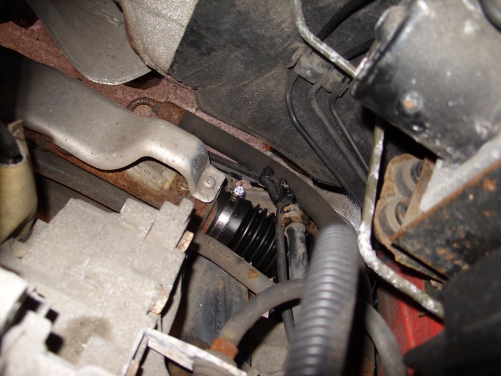

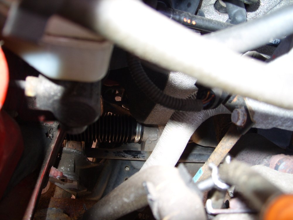

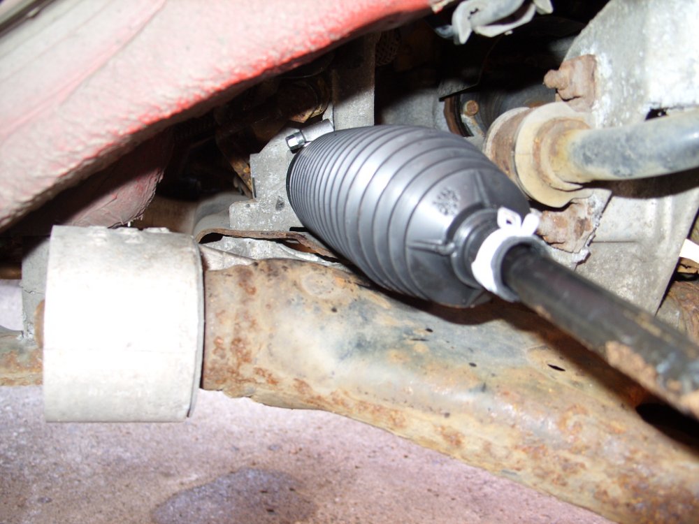

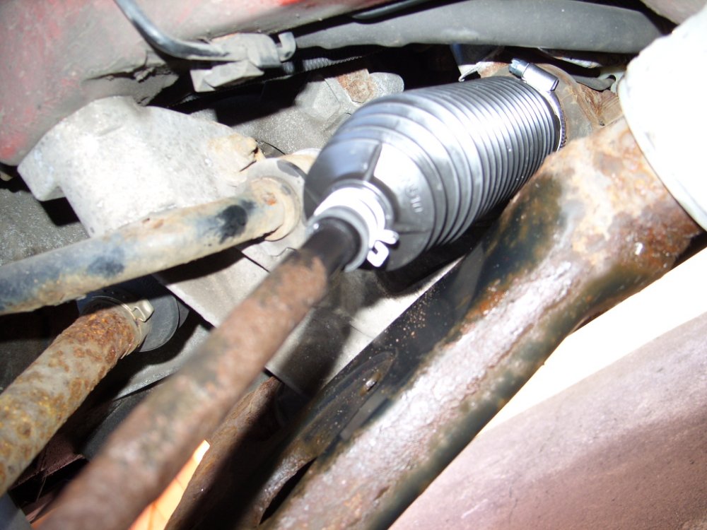

Yes, the level has never dropped again since then! Must have been weeping for years.
Edited by TMB
Thank you TMB, did you also change the gaiters I take it?
Yes indeed.
