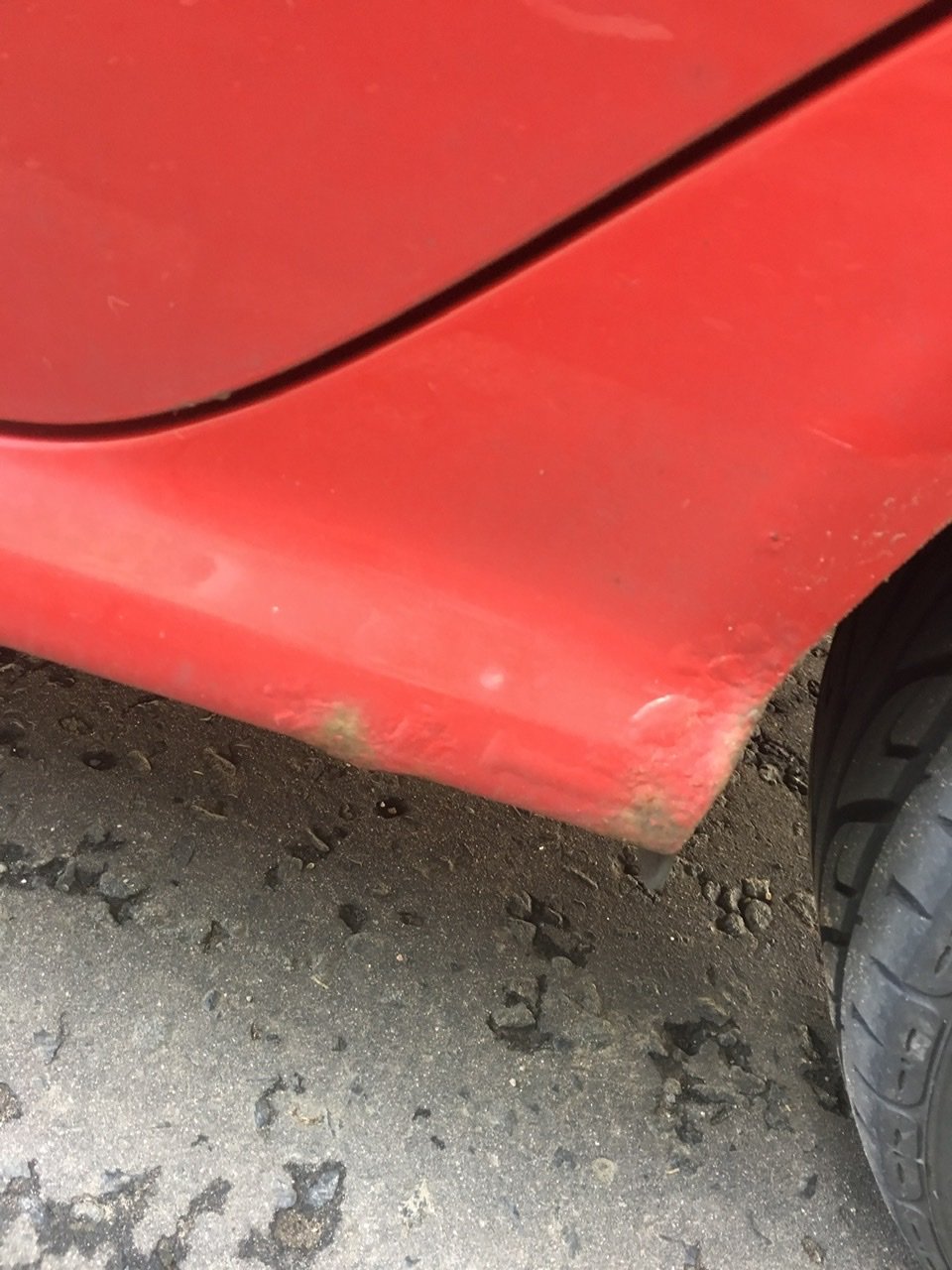

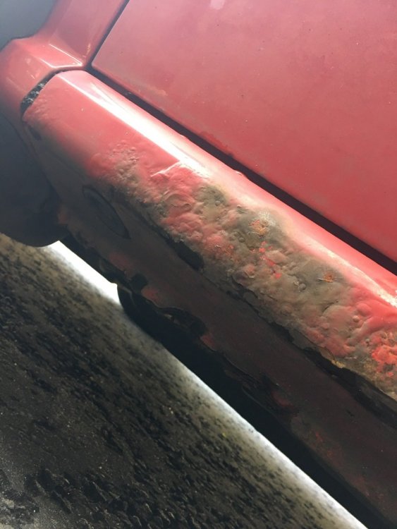

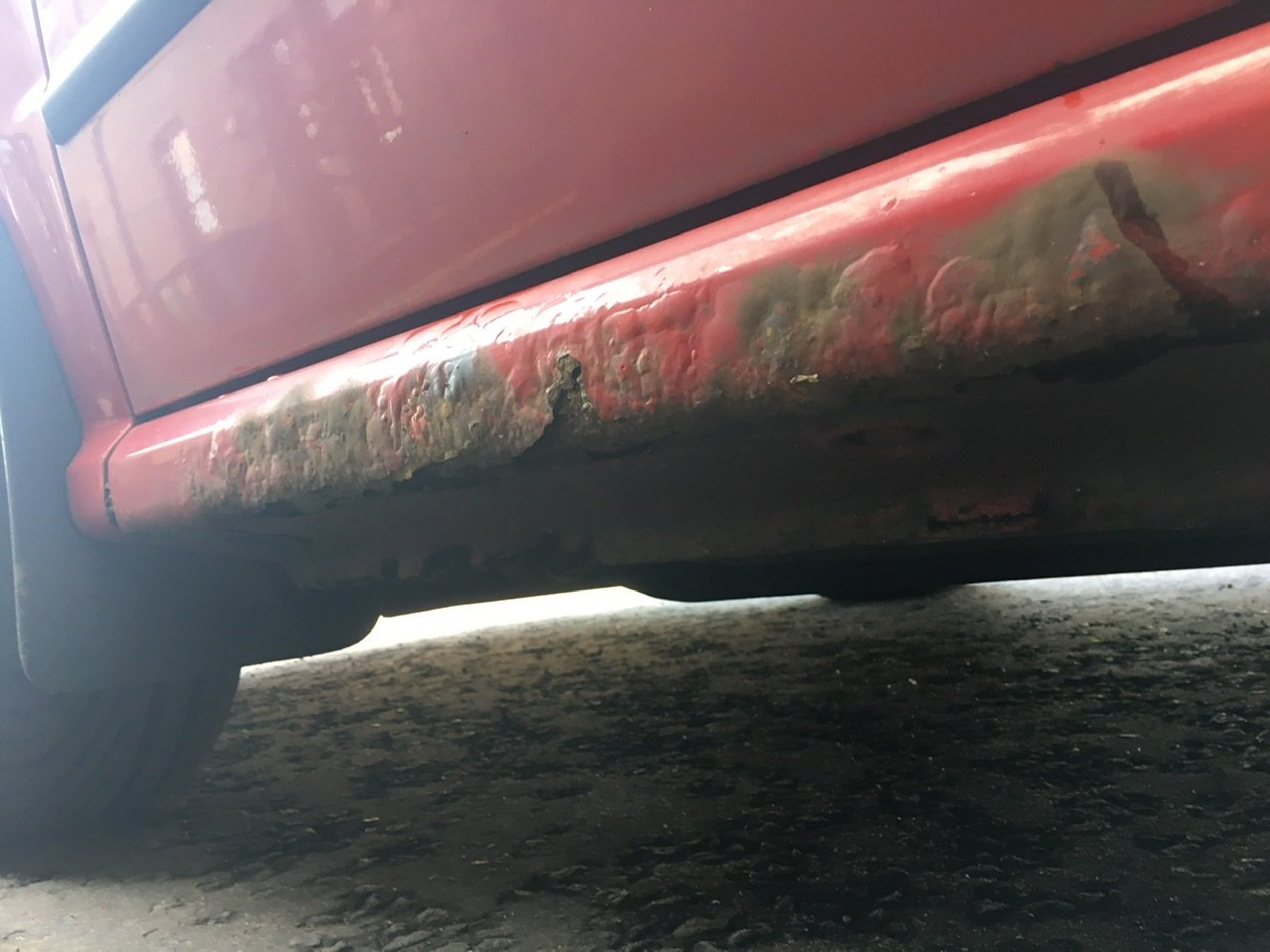

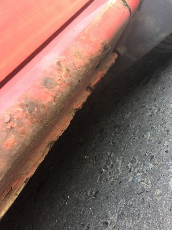

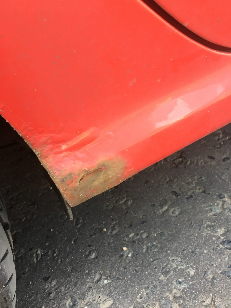

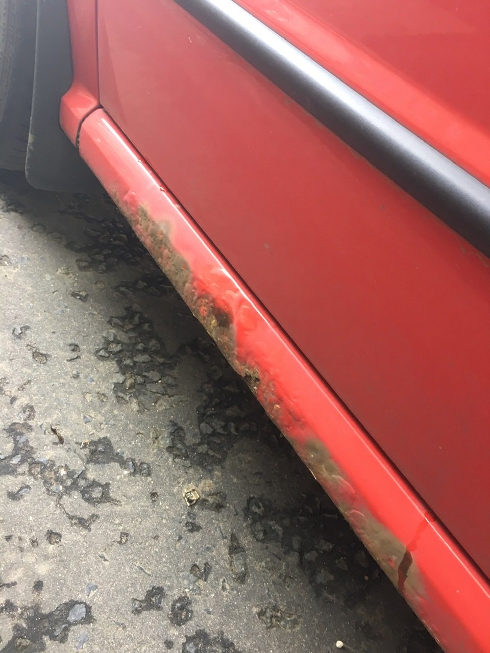

anyway for the last 3 years I’ve treated the poor thing as a workhorse and heavily neglected it while travelling for work. Now I’m not doing nearly all the miles I was I was tempted to sell it but I’ve had a change of heart and decided to tidy the thing up and fix all the little bits I’ve been wanting to do for ages! First up is the sills again after it ignoring the issue. Don’t have any photos of it when I bought it but here are a couple of the neglect.

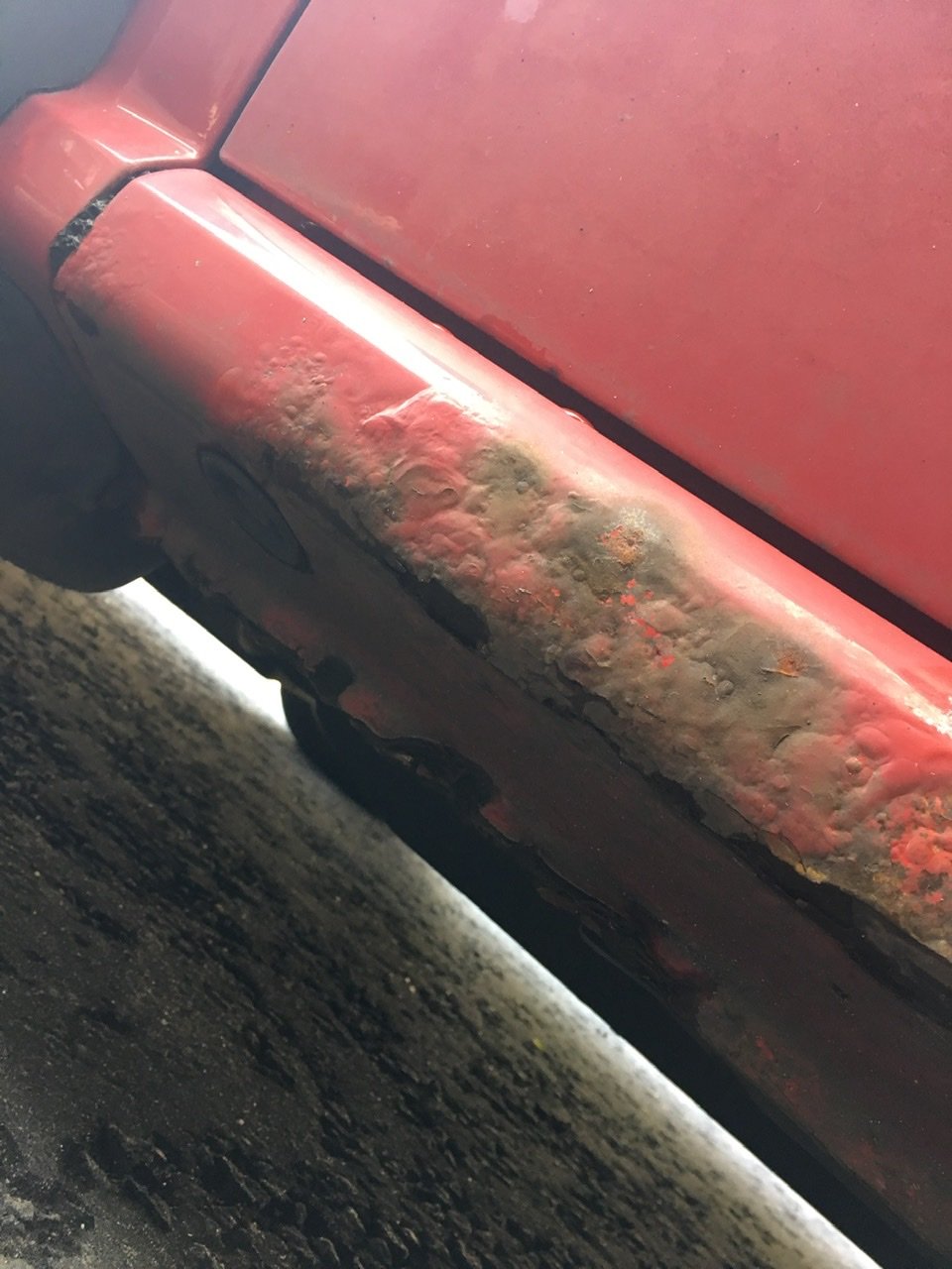

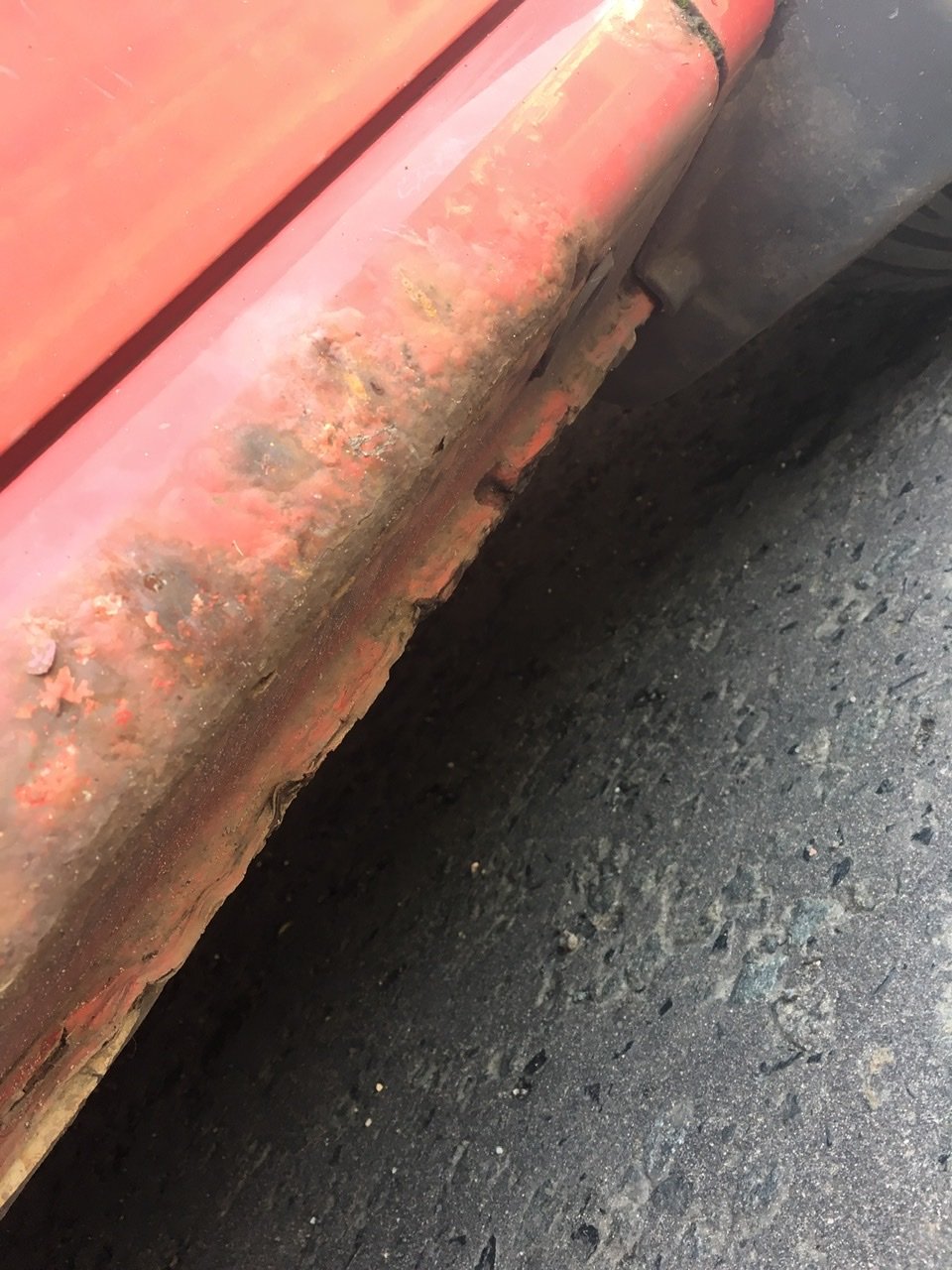

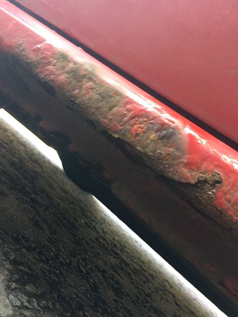

Any the sills were slightly bubbling when I bought it and didn’t think much of it.  Neglected the car some more then was presented with this over a year ago when I bothered to check. Ahh not so good.

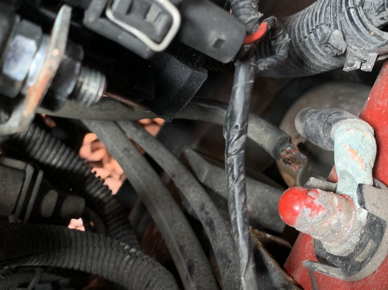

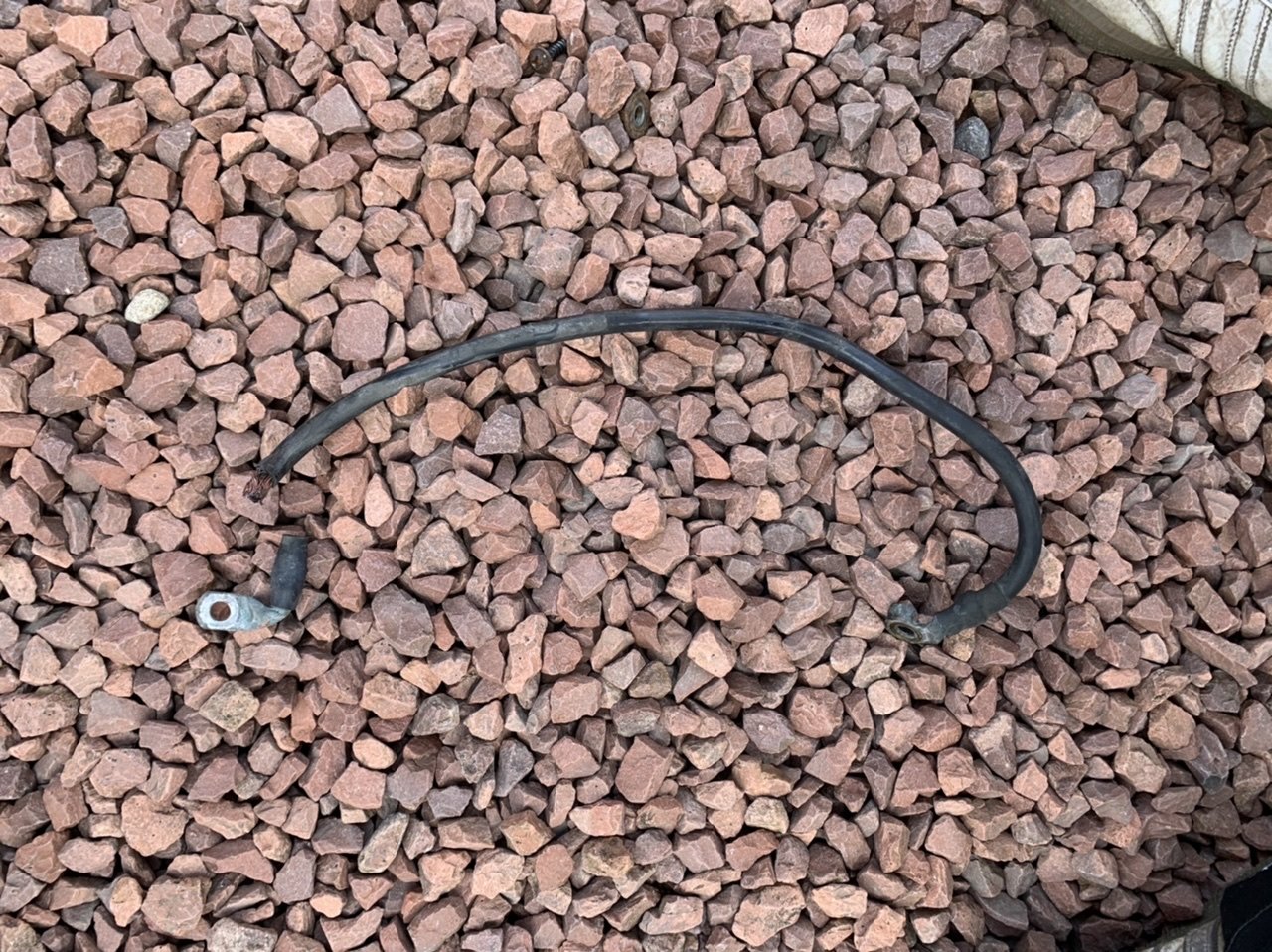

A while back the fabia also developed a starting issue and it was basically a thought of, what can I possibly be bloody now with this thing. Wouldn’t start just nothing happening when I turned the key. The starter was always sticky so went about changing thag anyway. Alas still nothing then I found this..
anyway new cable and it’s back to running and starting normal.
since euro car parts had mega sale I’ve also bagged all the gubbings to service the heap which is well overdue, but first after ignoring the above sills for a further year approximately I thought I best now sort these out.

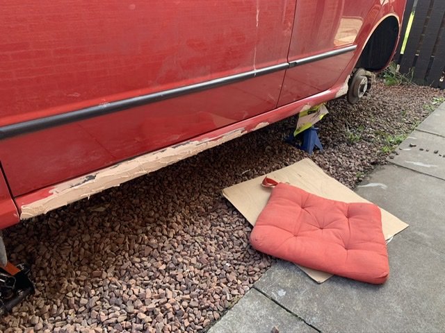

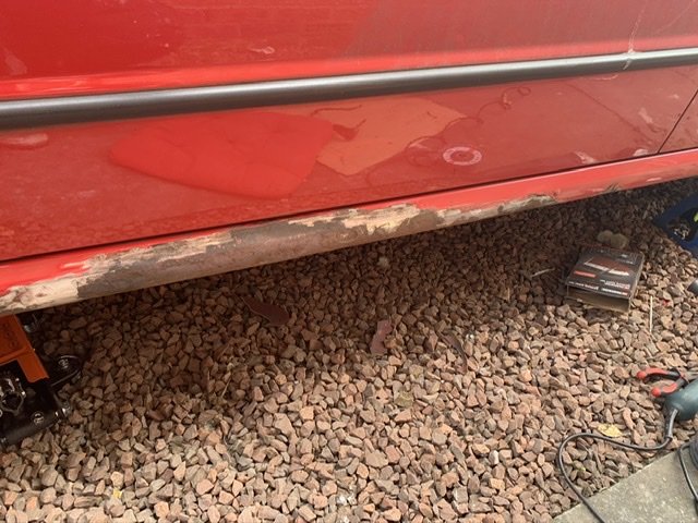

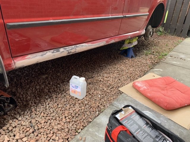

i set about tryin to get rid of the rust as far as I could then once back to metal
i treated the areas with bilt hamber hydrate 80.
some filler was required but not overly a lot. Next for the bare metal areas this was etched with the filler protected as this will just receive high build. Was going to finish prepping tonight but rain soon halted progress.

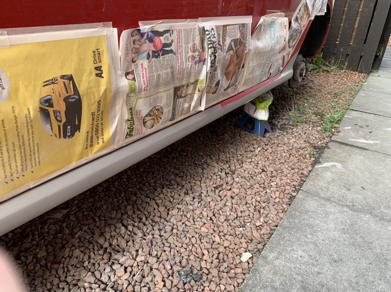

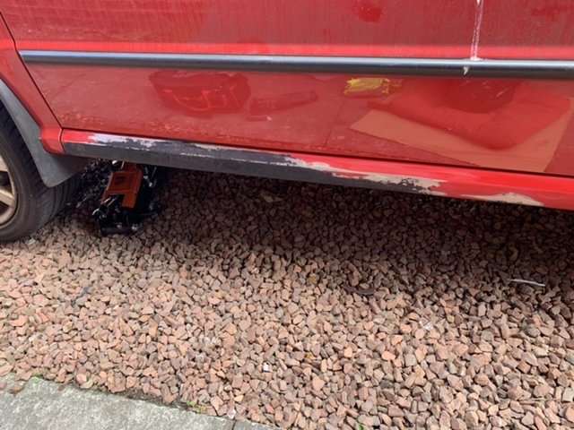

Not much more progress, I’m still fortunate to be working during the current circumstances so just a bit more fettling tonight and primer on. Couple bits that will require redoing before colour but will see how the wet sanding goes tomorrow.

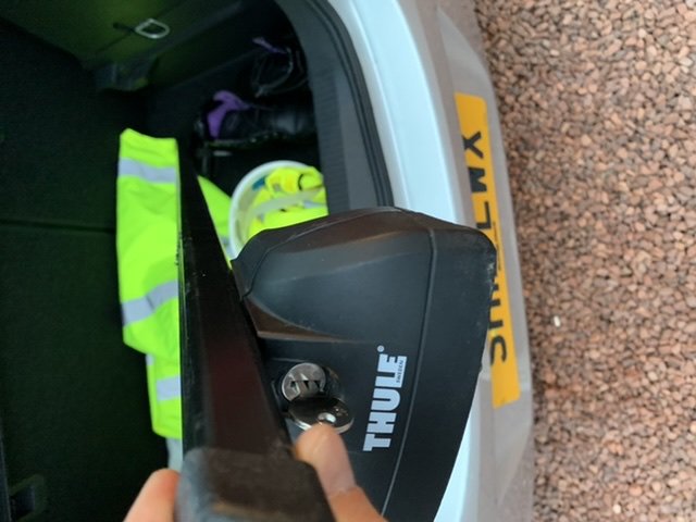

I’m on the hunt for roof bars preferably Thule Aeros. Can anyone tell me the right configuration for fitting kits to what bars fit the fabia? If anyone is selling full setup I would also like to hear from you!
also what foot pack and fitting kit etc?
and lastly can any bars be mixed with fitting kit? Only asking as bars can be sourced relatively cheap,

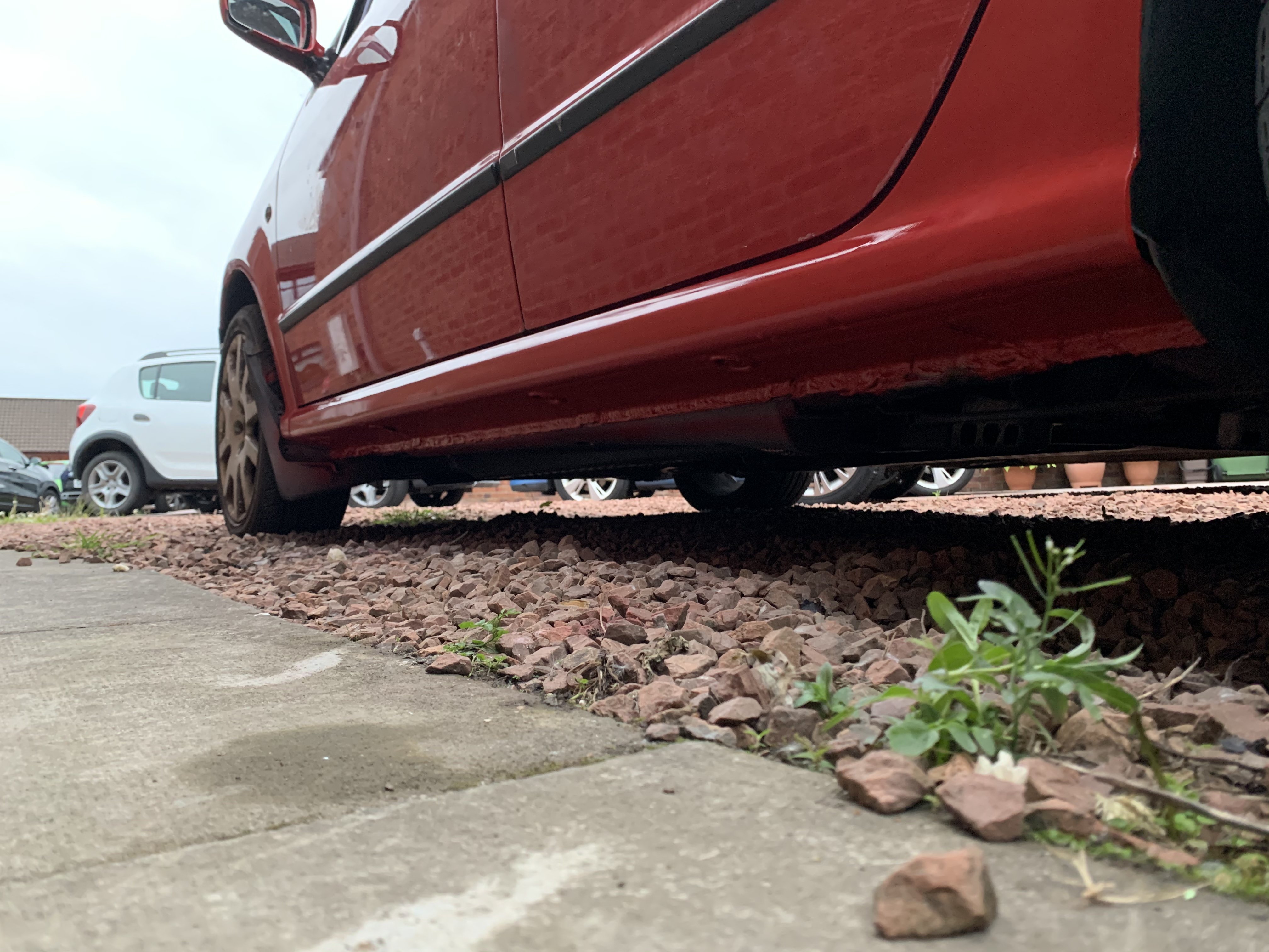

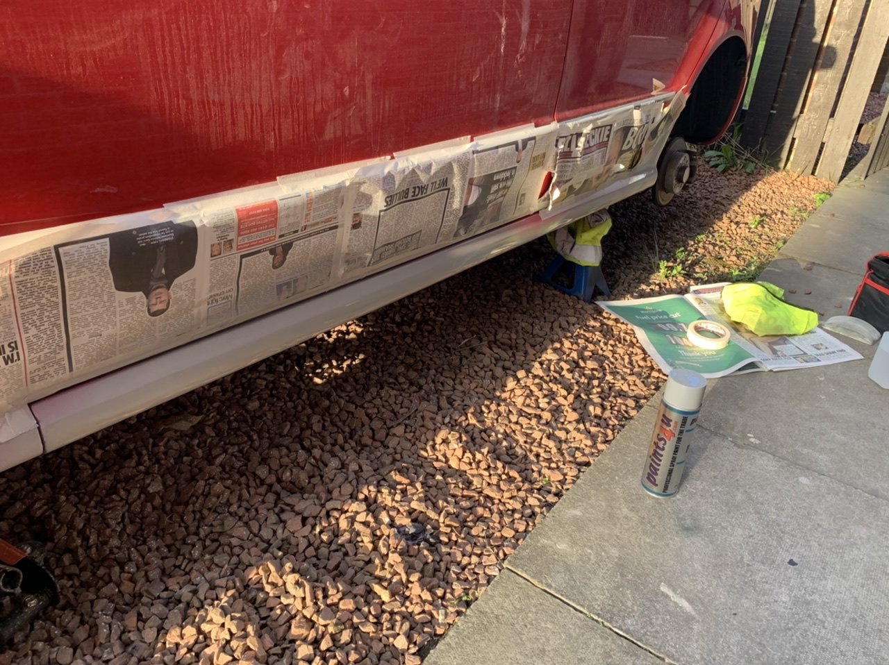

last night I wasn’t happy with a few spots and decided to wet sand the primer and reapply again which was much better application. As shown below. There was some further wet sanding today to feather edge the primer into the existing paint and couple bits of existing paint sanded with 1200 just to be lacquered.
Then here comes the big finale! Since we finally have some sun here in Scotland tonight was the perfect day for it. Got some light coats of colour on, followed by a listing of lacquer and then ultimately a very thick coat as much as you dare without runs occurring as below.
Also bagged these beauty’s for free the other night with the correct foot pack after missing out on some aero bars. All that is required is the 3003 fitting and new rubber feet which are on order 🤠. My upload capacity is absolutely tiny is there anyway to increase?
Ace job Luke, looks very well done

That’s rob! Well get ready cause I’ve still the other sill to do and two spots on either quarter panel 🤦🏻‍♂️ This has given me confidence however pretty pleased how it’s came out.

Thanks seanders im fair pleased! Just goes to show it’s all in the prep
Final photo of it back on 4 wheels, there were some hard edges from the masking of the lacquer so some 2000 and cutting compound here we are.

time will tell how well mine holds up when they start putting salt back down 🥵 I also had to remove some of the factory stone chip to get to some rust spots and have only painted those areas fingers crossed it can cope if not will need to redo if stones break through the repair.
