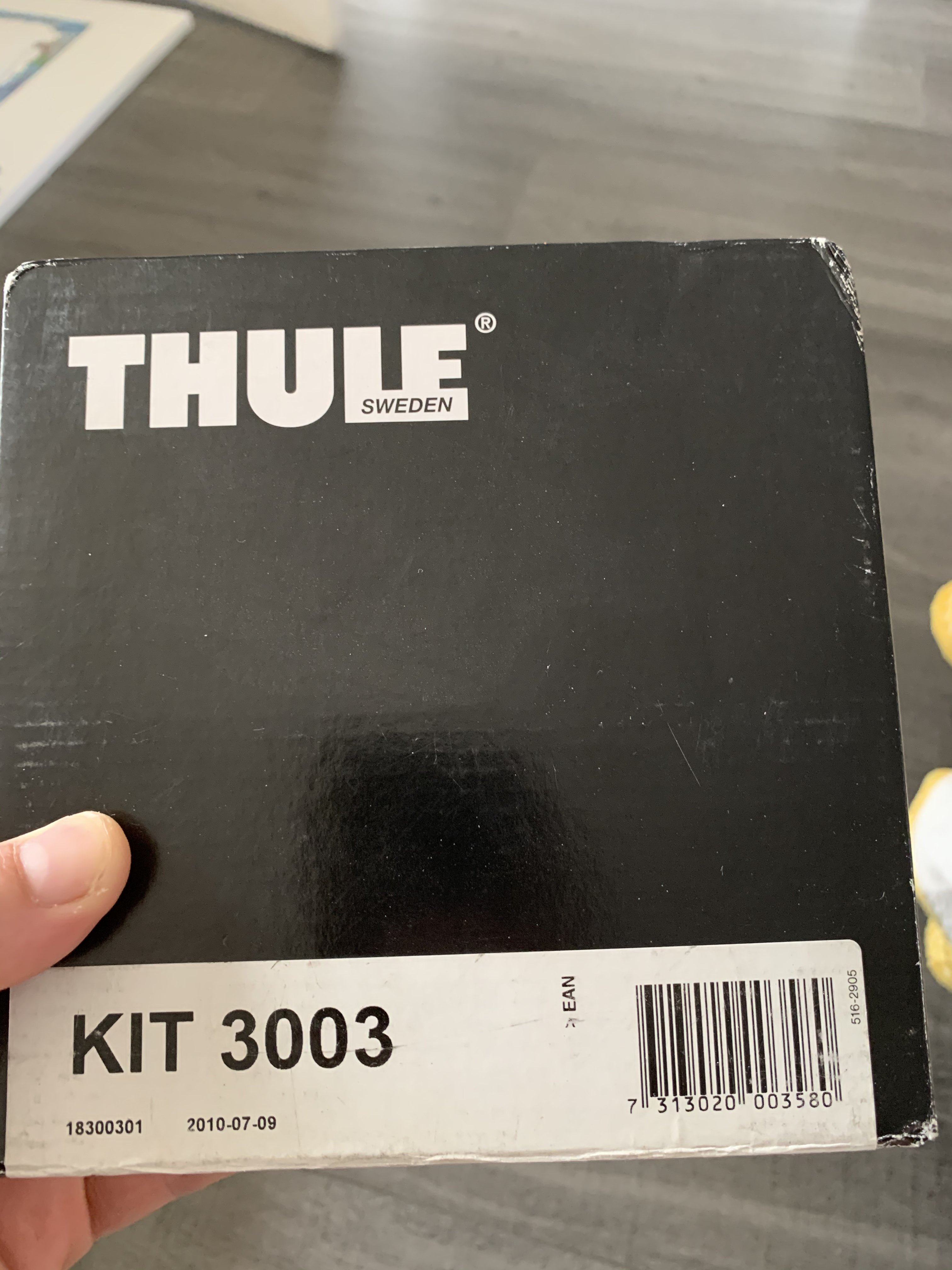

This came today so can probably get the bars on at some point. Struggling to find replacement feet for the 3003 fitting kit though had ordered the wrong replacements so they are returned the search continues. 🙄

Well after a bit digging there apparently you don’t have rubber feet for the 3003 kit so that saves me hassle 😂 once this dreary rain goes away I’ll get the bars on.

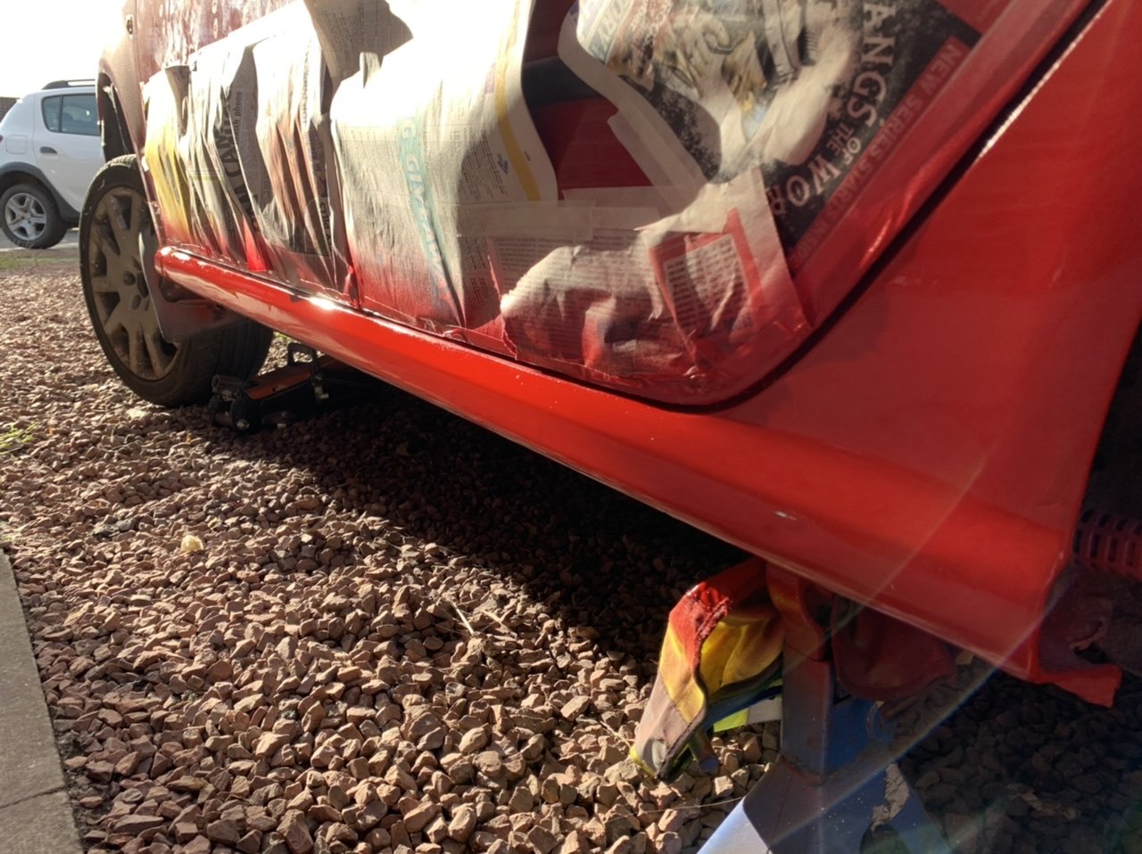

Then here comes the big finale! Since we finally have some sun here in Scotland tonight was the perfect day for it. Got some light coats of colour on, followed by a listing of lacquer and then ultimately a very thick coat as much as you dare without runs occurring as below.

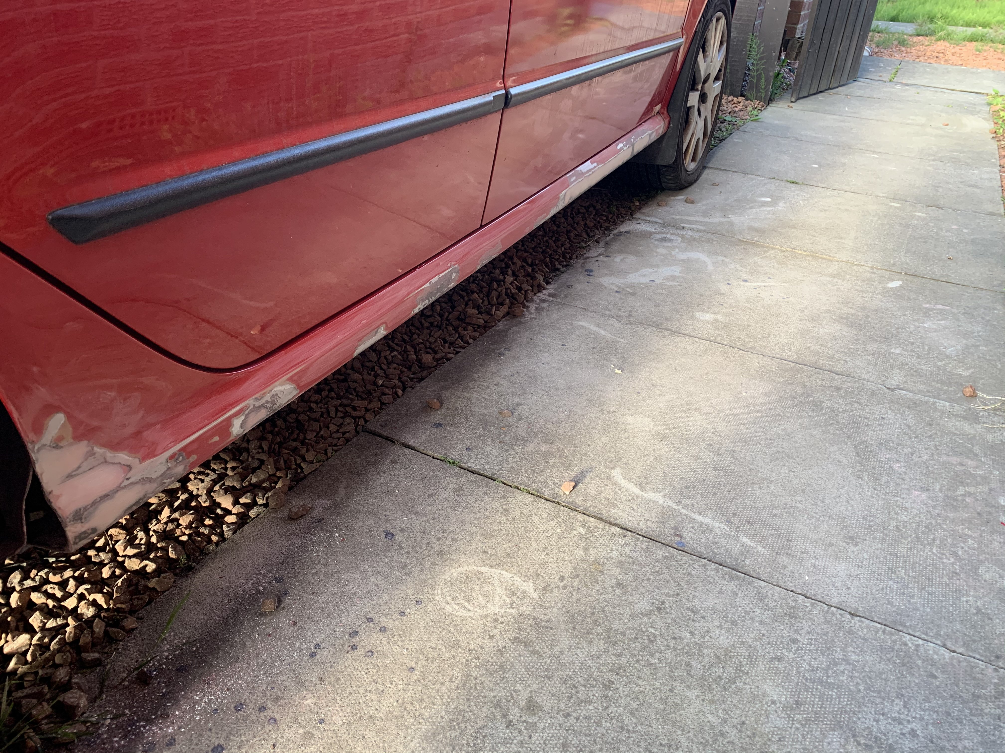

Hi Luke, looks very tidy, I have the same issues with my fabia cills although they don't on the surface look as bad as yours did, never sprayed car body work before  but am thinking of finally having a go after seeing your efforts.

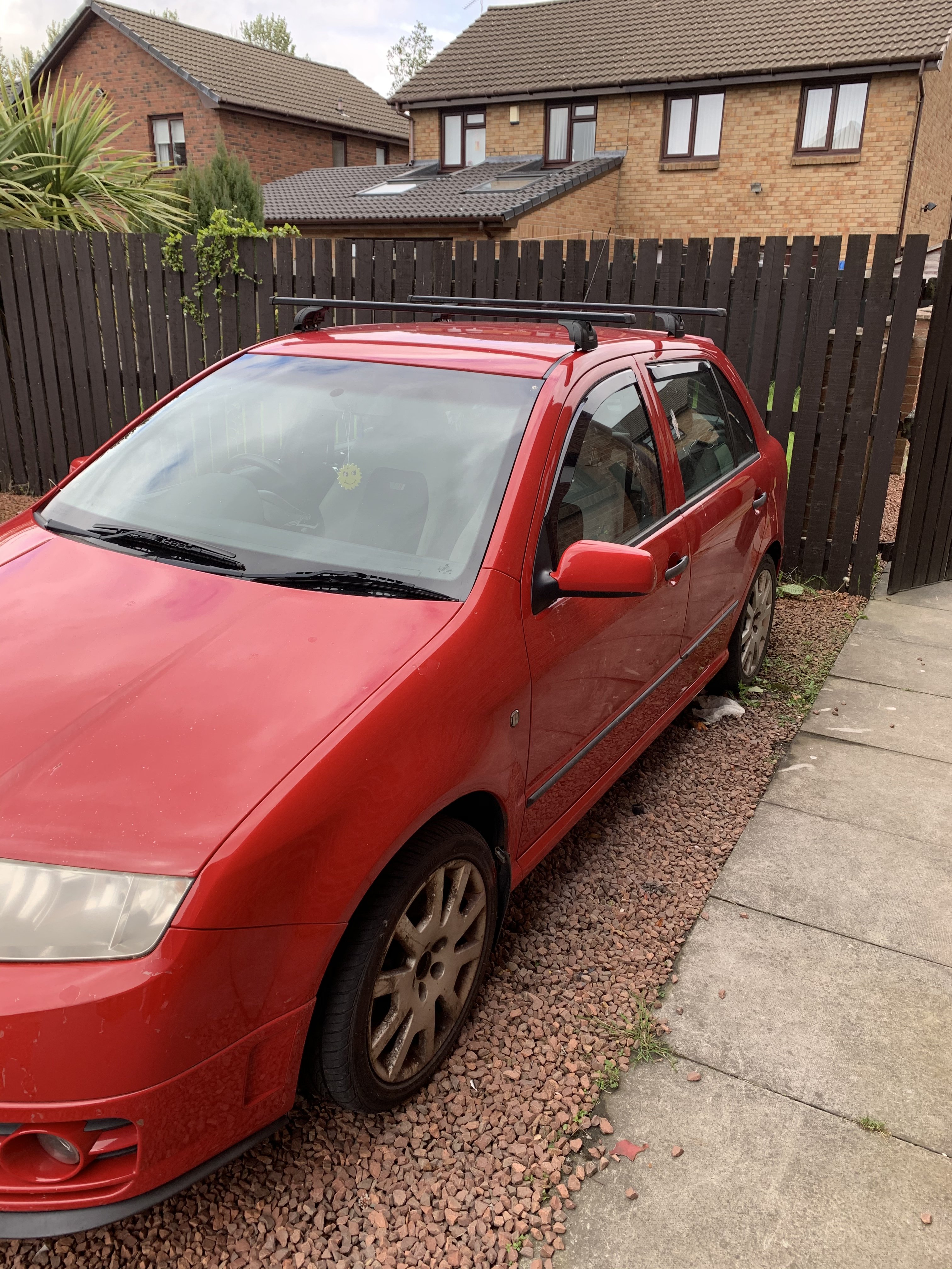

Well got the roof bars on today they were actually the longer 127 opposed to 108 so the grinder had to come out to notch the actual runners 😂 but they are on and il pretty happy.
i also purchased my new bike which actually cost most than I paid for my fabia 😬 so any other upgrades will be waiting for the time being.

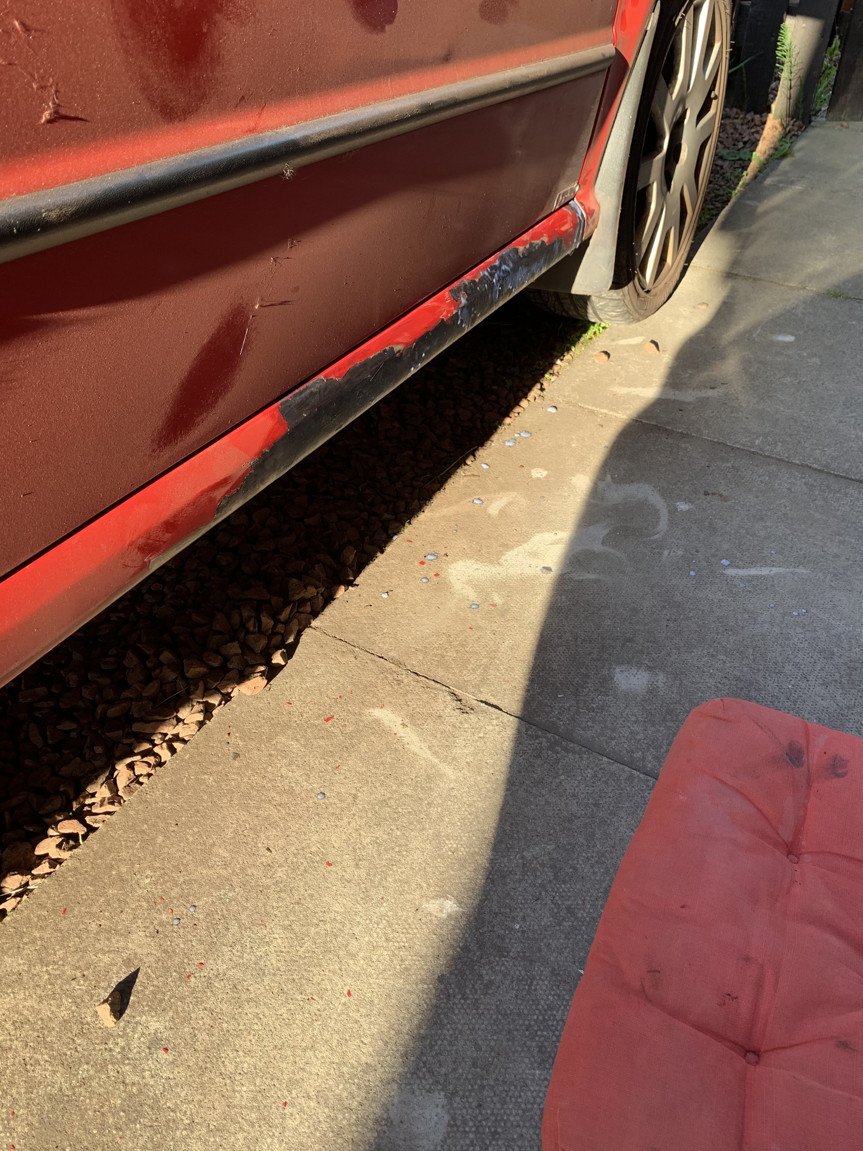

also started the driver side sill but rained off as per usual up here 🙄 tomorrow looks dry so hopefully get it in primer wet sand then colour all going well after work.

Now I used a different high build primer and lacquer for this one and was worried after looking at the final result I had to do a lot more flattening than the passenger side but I think I’ve achieved a reasonable finish in the end after some polishing. I’ll be honest I half arsed the bottom of the wing because those are easily replaced 🤷🏻‍♂️
Ive still got the two bits where the quarter meets the rear bumper to sort now but those can wait. Should only take a couple days to do both weather permitting!

Hi Luke, still not sorted my sills as yet, what make was the high build primer you mentioned, the top coat and the body filler/hardener, also what grade wet/dry paper to use, also is that a tub of cleaning fluid or something?

Hi Martin,
The first sill I done was paints 4 u own can which was okay but went on a little thin. Second one I used was upol and found that to be better. Colour I used paints 4 u and the paint match was great can get made up cans directly on eBay for v reasonable price if a paint shop isn’t close by to mix for you. Filler I used upol David’s isopon p38 I think it was I’ve still some left in one can doing both sills. Easy to use and come with instructions.
to get it down to the metal I used a 60 grit flap disc on the grinder then filled with filler. Used then 80 to get bulk of filler down then 120 through to 500 before primer goes on. Once it’s primered I wet sanded it with 800 all over including existing paint to blow it in. If you are not happy with primer re do I done this a couple times. Paint and then lacquer I used best part of whole can of lacquer to get it shining. One sill I didn’t have to flatten at all but last one I flattened with 2000 wet then polished and it’s been fine since. Hope that helps!

Martin I meant to say that little bottle is panel wipe and is essential to ensure you don’t get any silicone marks in the paint and cleans off all grime before coats. Also mind use rust converter once sanded down. I used bilit hydrate 80 which was good
