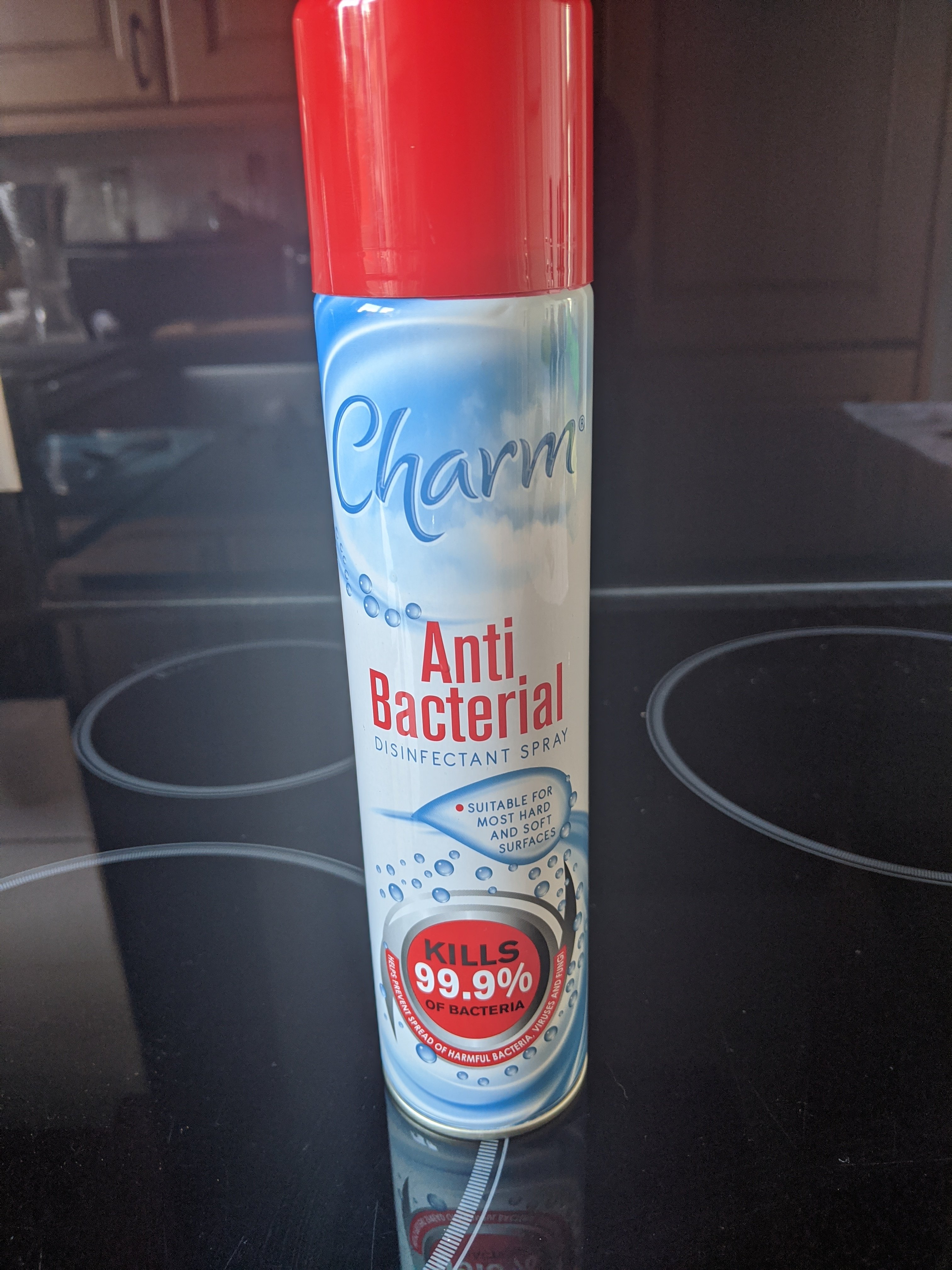

Had my Yeti for over a year now and the Aircon has always had a sickly smell. I tried a few things, Aircon bomb which was useless, an aerosol foam squirted down all the vents and followed by another Aircon bomb which worked for a few weeks before the smell came back.
Last week I was in Tesco and saw this product on the shelf for £1.50. Sprayed it down all the vents and left it overnight, smell has gone.
Even if it comes back in a few months it's a cheap fix to do it again. I reckon there's 4 applications in a can.IMG_20200518_100030.thumb.jpg.7c71e2828d64d676ed52b36bc409a3b3.jpg
Not being rude but is it safe spraying a liquid down inside all the air vents?
Or does it dry out/evaporate leaving no residue?
Is there any potential longer term problems likely to follow from this method?
Just curious if this is a safe method, as my wife’s Citigo has never really smelled clean, it always has a slight “wet dog” odour.
There are other products which are designed to do this, such as the foam I used last year. I can't see any possible issues.
The spray in question is designed to be sprayed on and left to dry, I sprayed some on the kitchen hob glass top as a test and it evaporates and dries quickly.
Long term issues? I'll let you know. It's been a week now and it doesn't show any issues developing.
