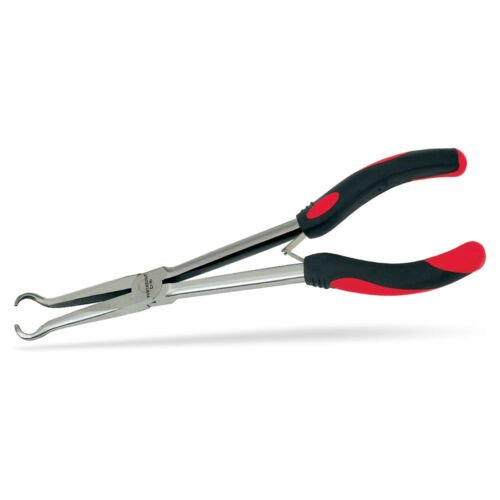

I've tried coaxing the leads off off the plug but they are really firmly attached.  If I'm to change these plugs I'm going to have to use some plyers or dismantle some parts to get a decent grip.

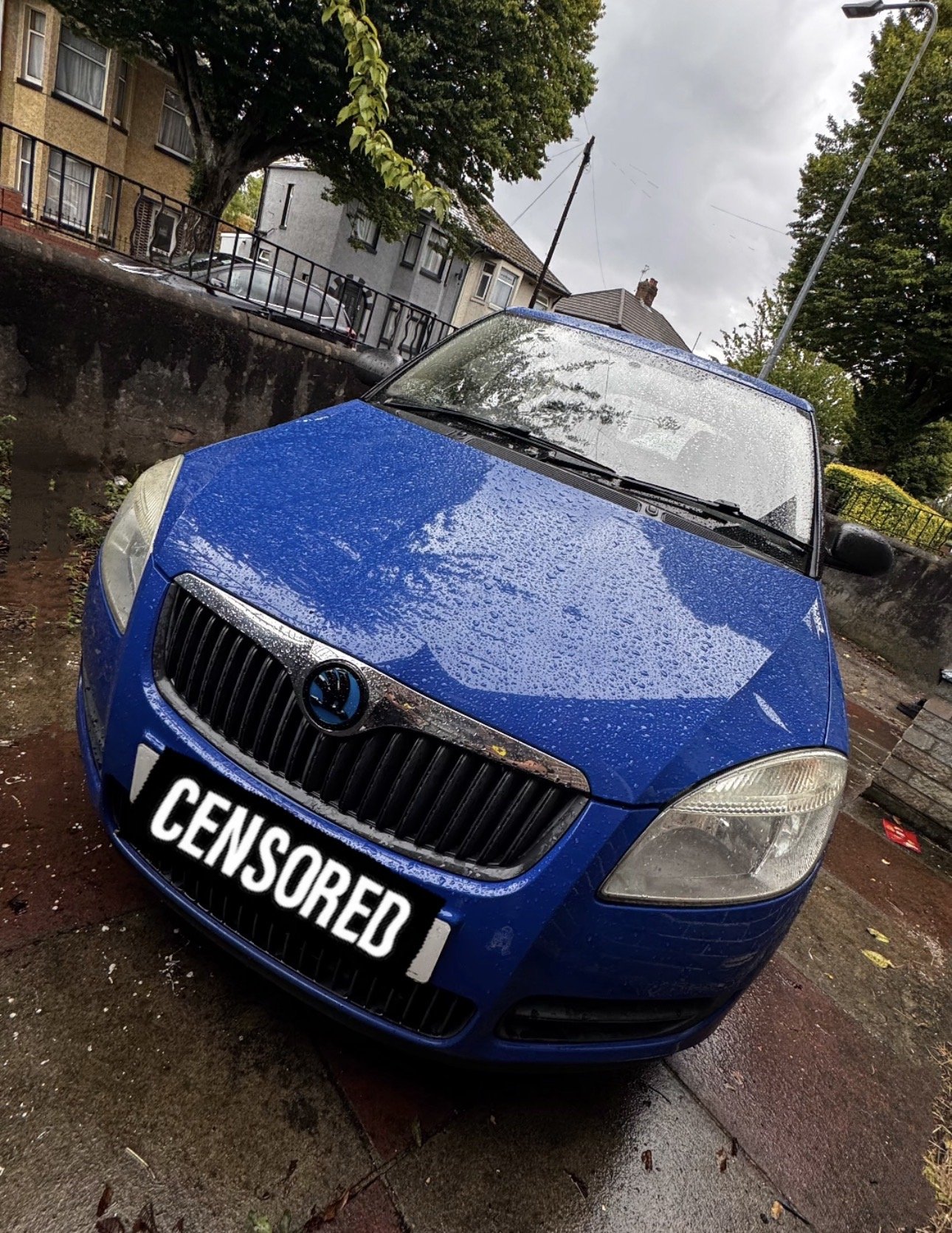

Hi all, my 'check engine' light came on this morning with no errors. I dug out an old ODBII Bluetooth adapter and read the code as follows -
P0684 [0x0684]
Glow plug control module to ECM/PCM communication error - range/performance problem
Status: Confirmed
04976 [0x001370]
P068400: Glow Plug Control Module to PCM Comm.Circuit Range/Performance
Status bits: 1
Priority: 2
Frequency: 1
Unlearning index: 255
Odometer: 213718 km
Date, time: 2024.09.24 06:59:43
Engine RPM: 804 rpm
Calculated engine load value: 88.63 %
Vehicle speed: 0 mph
Engine coolant temperature: 14 ℃
Engine oil temperature: 14 ℃
Barometric pressure: 14.358736062693 psi
Klemme 30 voltage: 11
Paramteric values:  20 96 28 13 BB 82 94 11 89 00 11 1F 00 11 12 BD 00 B0 16 44 02 EE 16 45 00 EF 16 25 0B 2D
Status: Test failed, Test failed (current drive cycle), Pending, Confirmed, Test failed since last DTC clear, Warning indicator requested
I'm really not confident with an engine or checking currents and such, but reading the first post, I wonder if I should just reset everything and see if the error comes back?
Thanks for any advice anyone can offer.
