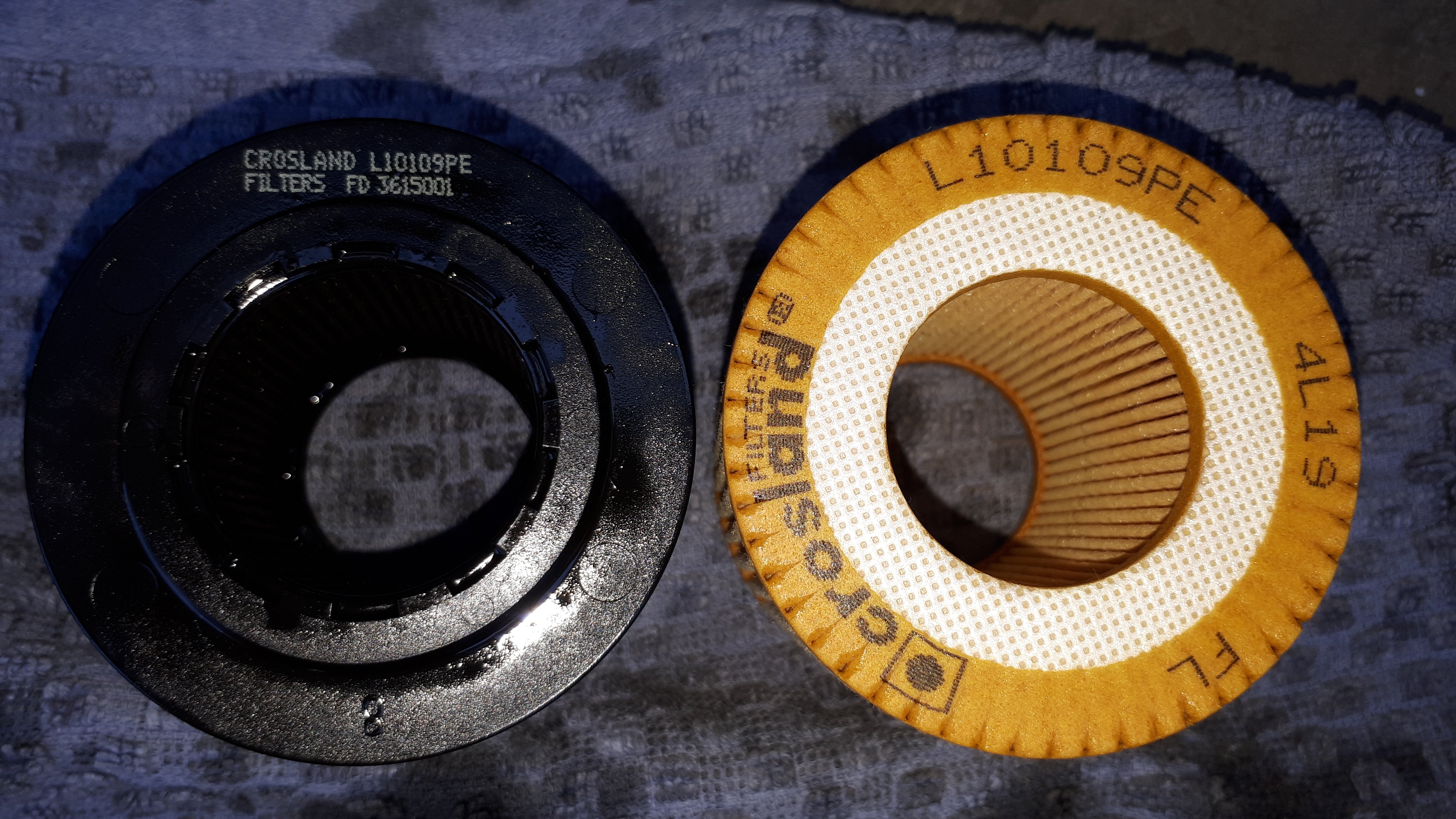

Changed my oil and filter but the oil filter design has changed. Even though both Crossland with the SAME part number.
The old  element  had black plastic on both ends which clicked on whereas the new one was just a paper element that was a VERY tight fit to push on. I trust the new version did not need a new modified cap.
That bit that is in top of the filter is part of the cap I think, not part of the filter.
If you look at the black version it is stamped crossland and no way does it remove, I have fitted just the bare filter on the right. Should there be something else. The original filter was not crossland.

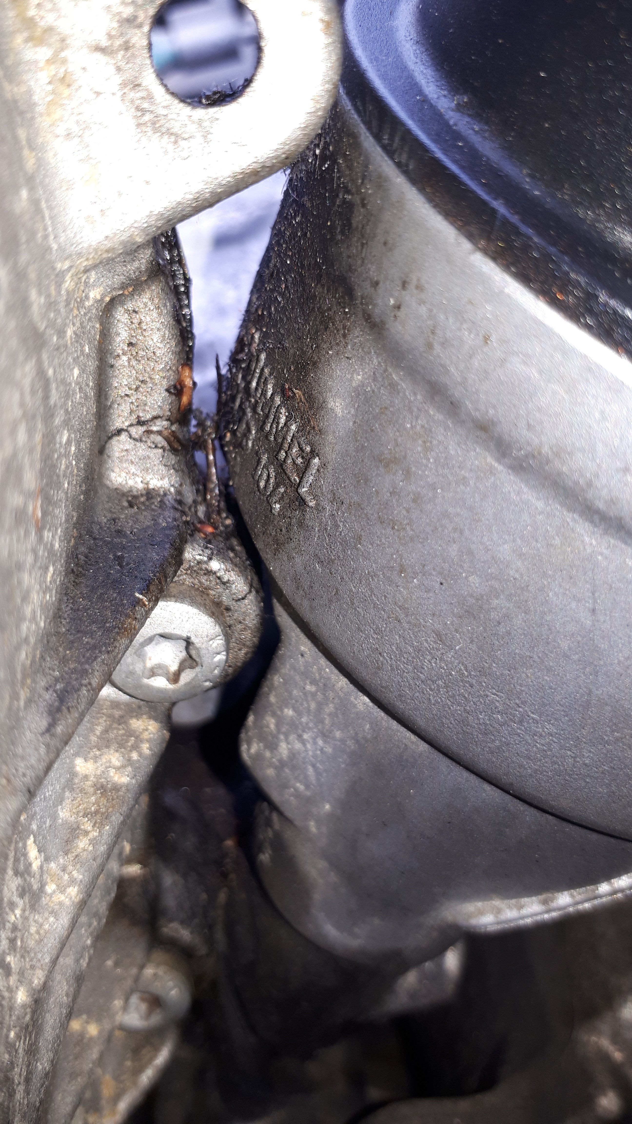

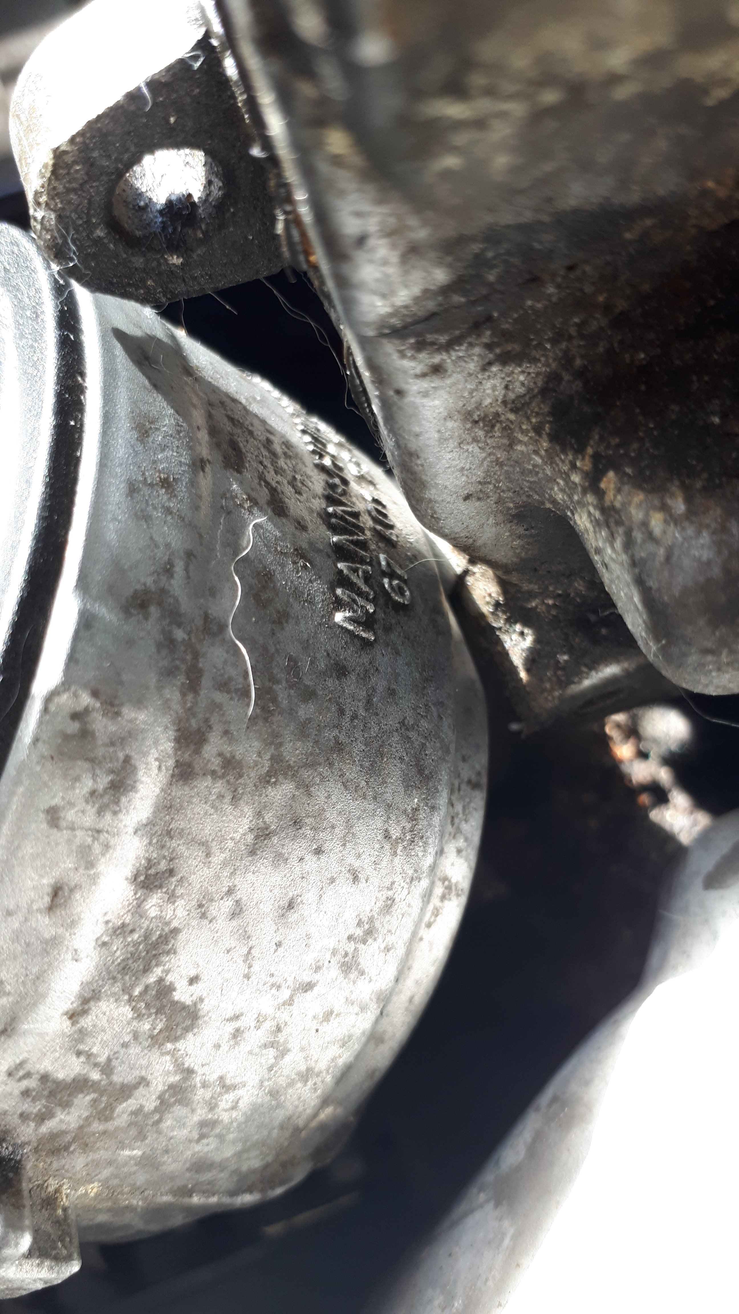

I have only ever fitted the Mann filter on fabia mk 1 AZQ and mk2 BZG engines. The oil filter housings have a Mann Hummel logo cast into the lower alloy section.

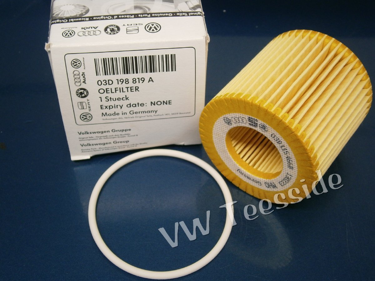

Heres a pic of an OE filter. Note the MHO marking indicating supplier.
Edited by xman
So the bottom line is this, I have fitted the filter on the right in my photo which looks like the OEM one above ,is that ok , were there two oilfilter housing types fitted to my 07 Fabia 1. 2htp. Should I try and source a filter similar to the one on the left, does anybody have a part number?

It will be fine.

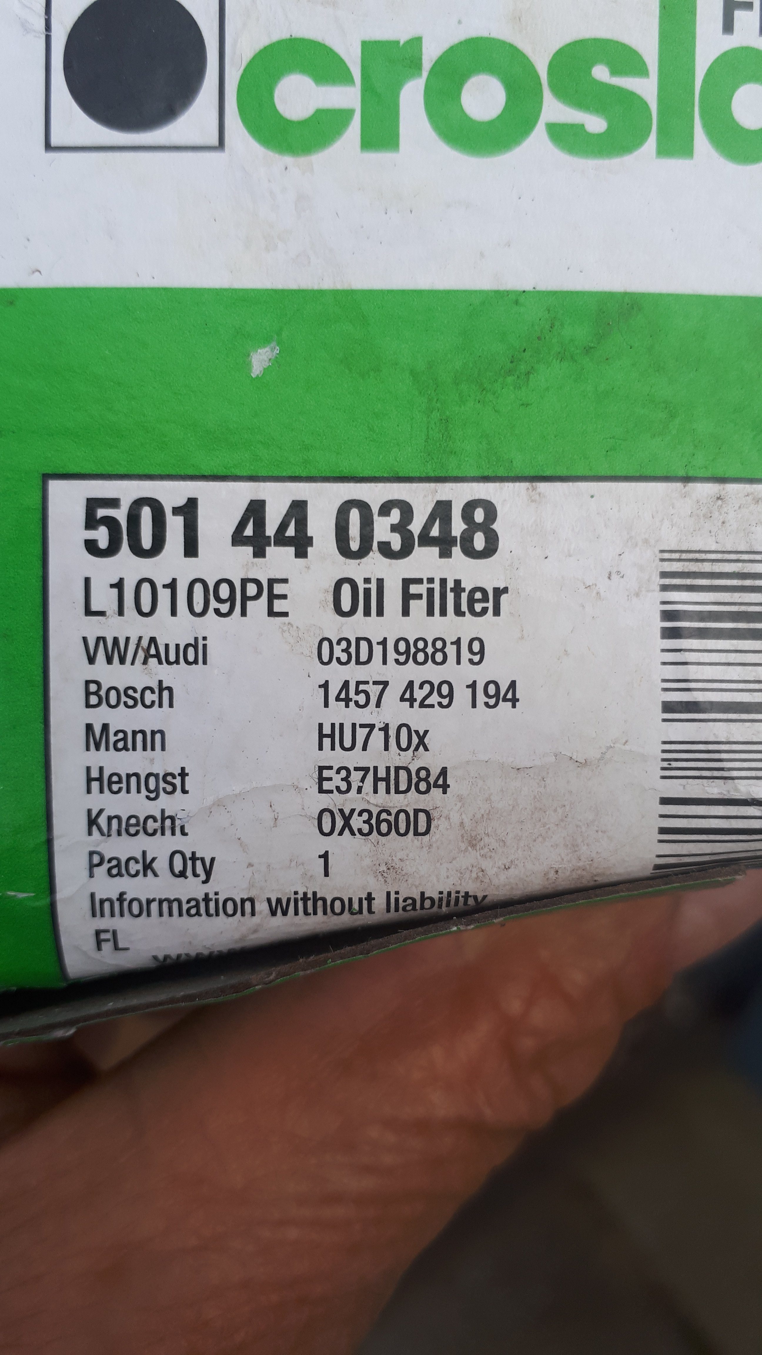

Cross-reference the Crosland part number and see if you get a match with the genuine part number shown in xman's post. If you do; it's fine.
As @Wino says, the right hand filter is perfectly fine and is a close clone of the OE filter. Nothing to worry about.

Part number is compatible but what puzzles me is the radical redesign and as I remember the original was the same as the black version. Does VW/Skoda produce a version similar to the black version and can anybody give me the part number.
Photos of filter housing
The only ones I've seen with top and bottom plastic end caps like in your pic, are cheap budget brand filters, mostly from China.
I've had two HTP engined fabias, the OE filters have always been as per the Mann Hummel design.
As you have seen the oil filter housing is made by Mann Hummel. So it makes sense to fit a Mann filter as OE.
