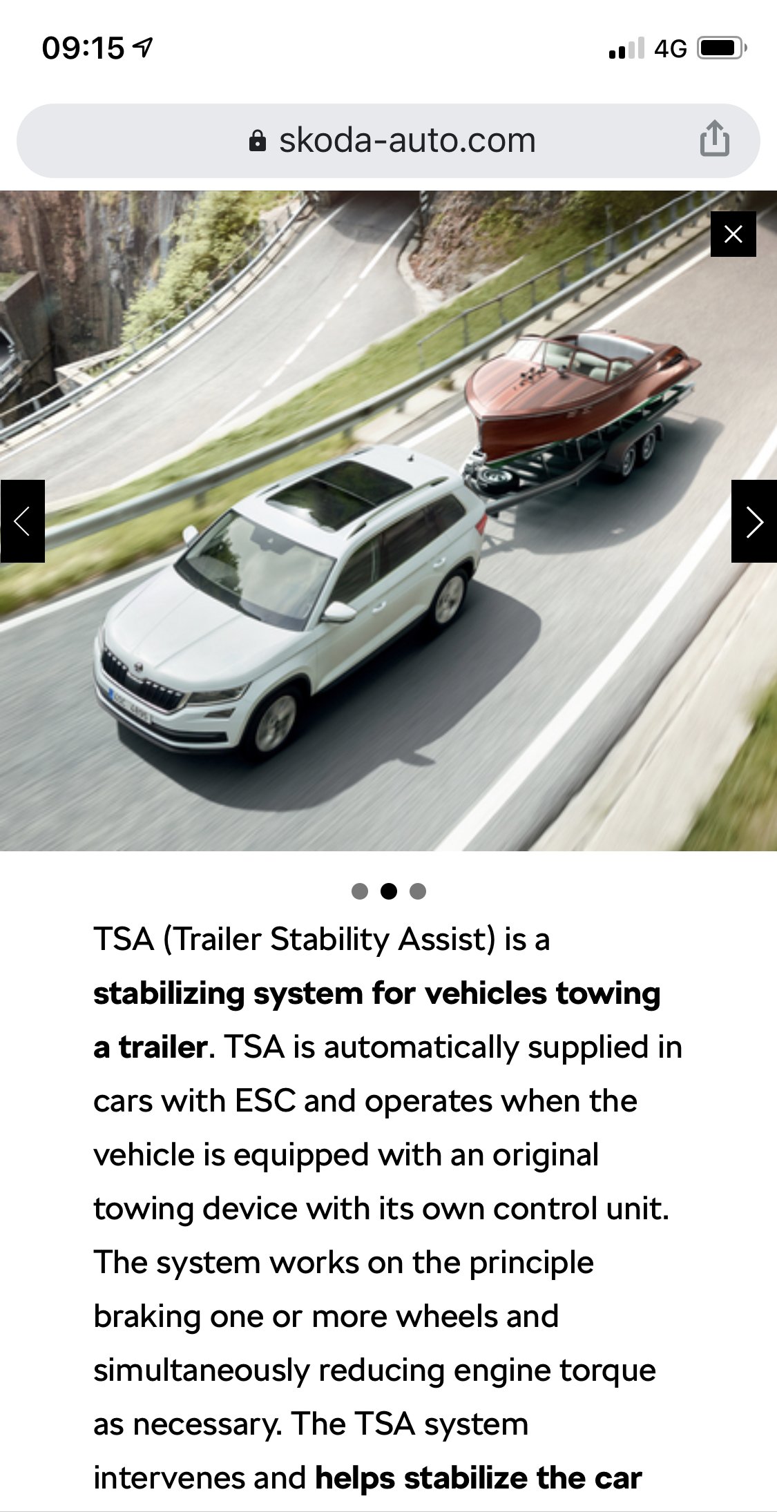

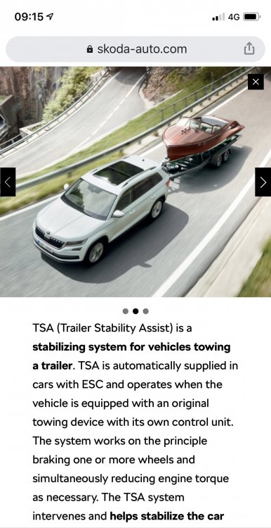

Trailer Stability systems detect when a trailer is starting to oscillate, or ‘snake’ as it is commonly known, while you are towing. It will attempt to correct any dangerous trailer swing through a combination of either torque reduction and/or individual wheel braking to bring the trailer and tow-vehicle back under control.
5 hours ago, puhleese said:
Tks. I didn't know that! With my very poor 'trailer' backing skills I am looking forward to testing that out!
Have you got a link to an official source that states this is available on the Octavia? I am genuinely interested in the feature as I tow a relatively heavy caravan.
That's a Kodiaq!

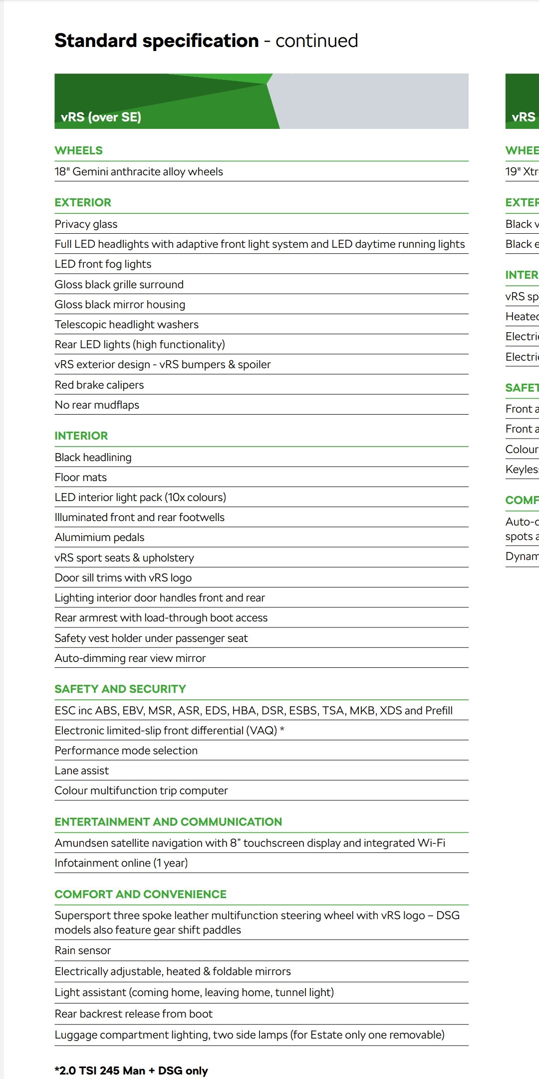

Looking at the pricing and specification document dated May 2019 for the Octavia, only the vRS states TSA (in brackets) with the ESC system. See screen shot below. Although not sure how accurate this is as even the Scout only has the standard 'S' model's ESC system.
