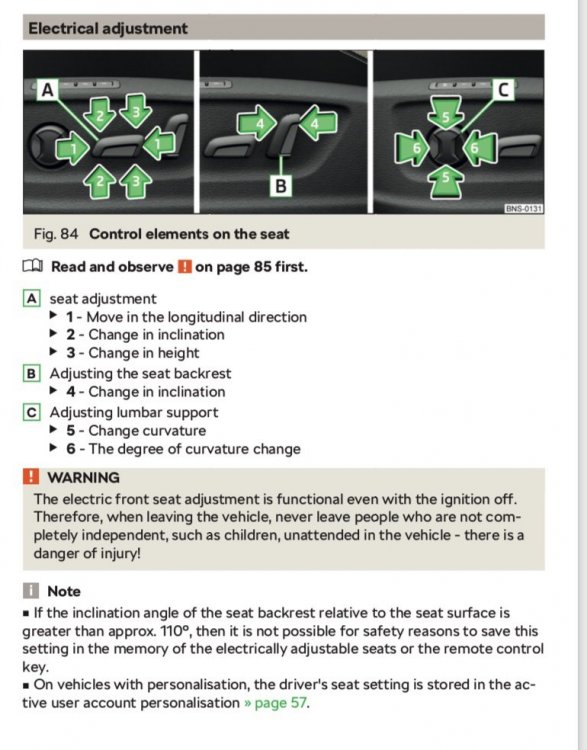

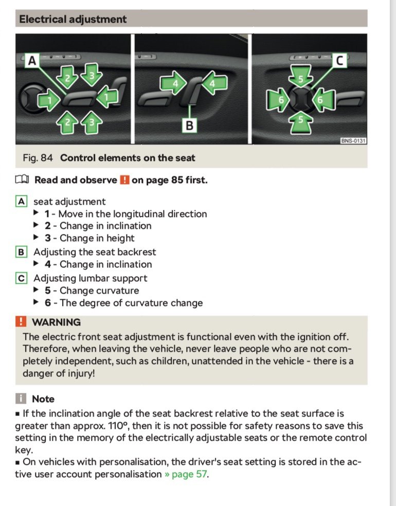

I was thinking you were something like 6'5"  but u say u are under 6ft, the seats go back plenty but cannot be raised?  Either there is something far wrong with the seat adjustment on you particular car or you're not operating it correctly. I have electric seats, the only difference from manual is you are able to adjust them MORE not less.
You're not by any chance pulling the front of the switch ( i.e. changing the seat angle - you'll feel the under thigh support increase ) rather than using the back of the switch to actually raise your arse?
Failing Kenny R's excellent guidance (RTFM), might I suggest a cushion ?  😂
