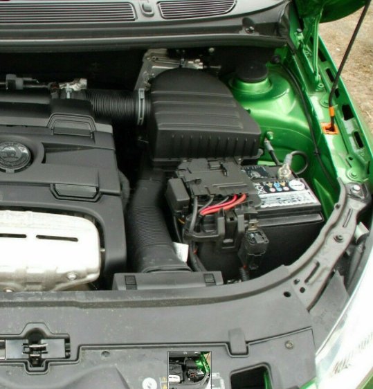

On my Polo R-line, which looks VERY similar. I took the top half of the airbox off with the filter and left the bottom half there. Then I fitted a cone filter to the pipe and it fit really nicely into the lower half of the airbox.
Worked really well for me for mpg, and it felt faster (could be placebo effect) and a nice induction woosh too. But not too asbo

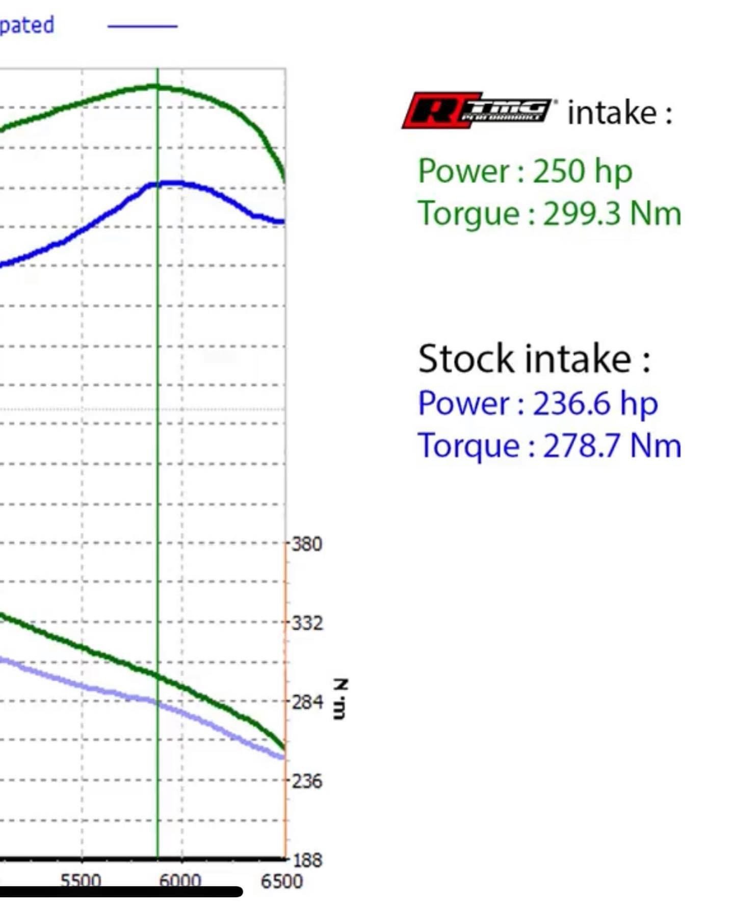

Personally I’m willing to listen to manufacturers figures and dyno runs albeit even if they are not independent. It’s a massive industry with god knows how many millions and when you consider probably 3/4 of tuned car’s have custom intakes I struggle to side with you.
Again that’s my only thoughts and I’m not asking you to agree .

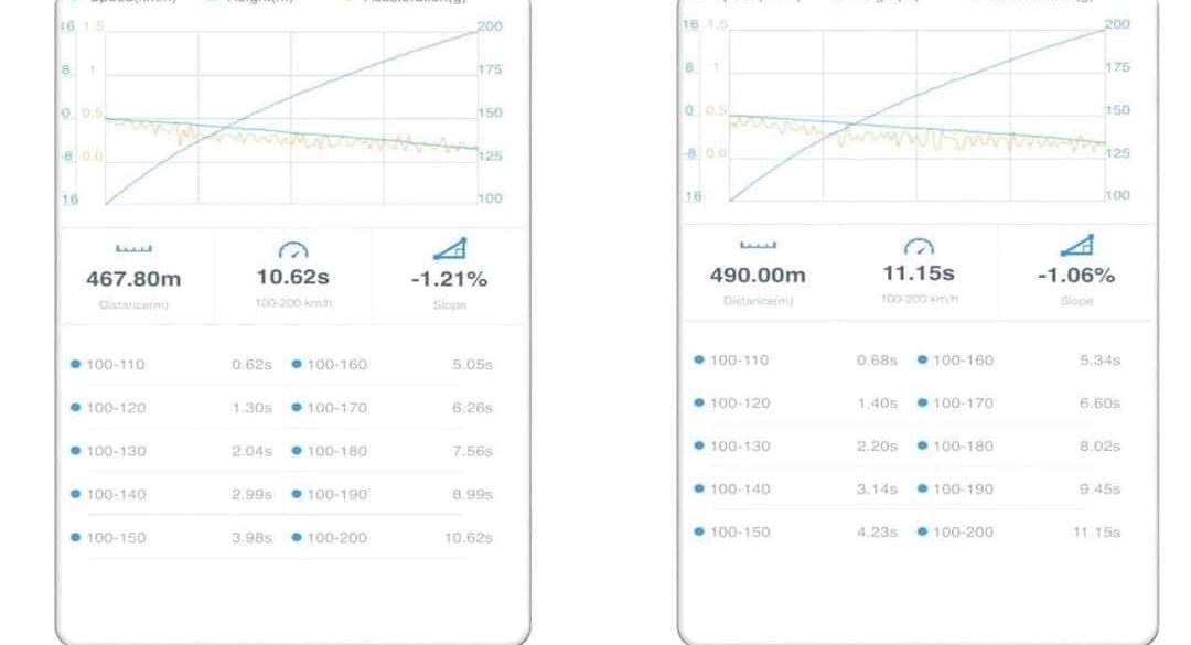

Rtmg for example use dyno and Dragy GPS to prove gains like so:
Dragy

Dyno

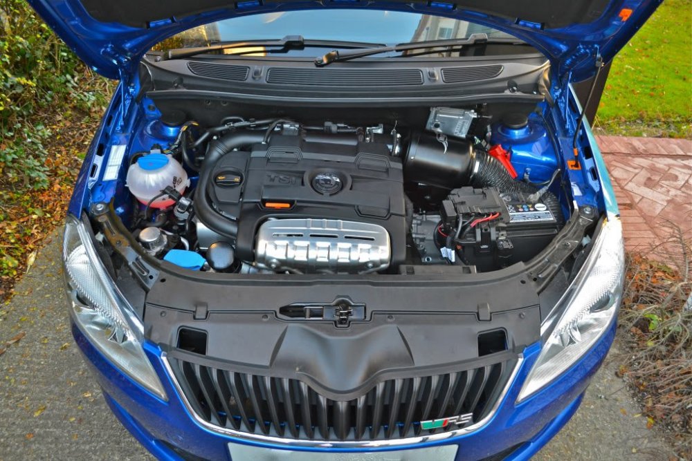

Behind the battery is a very hot area.
Hot sunny days, runnung the car hard, sitting in the sun parked then starting the car again.
A Cold Intake feed is a good move.

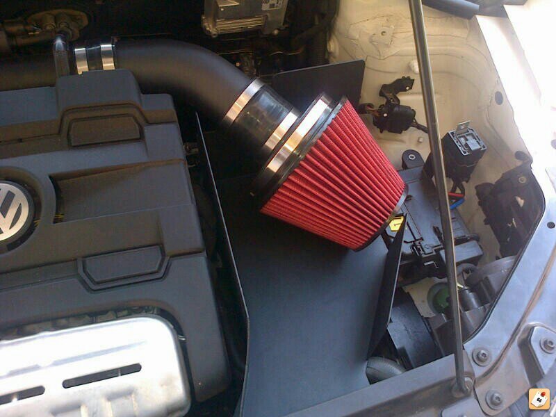

http://briskoda.net/forums/topic/316115-review-fabia-vrs=homemade-induction-kit-ipen-cone-filter
