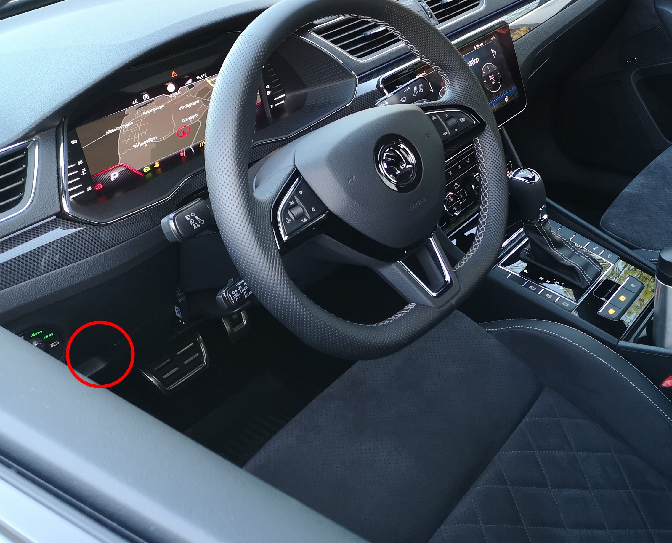

Sorry to jump into this thread but I have just received my DTUK pedal box for my 190 tdi DSG and would welcome any pointers on how to remove the coin holder to be able to hold the controller for the pedal box, or if anyone had any other ideas of where to stow it.
Thanks,
Chris
Thanks,
Chris
If it's the same holder/cubbie as in the LHD models, just below the light switch (circled in the photo)...
...then just open it normally as fully as it gets, then continue to push down harder for it to further pivot and it will come out.
There's going to be some resistance and might seem as if you're going to break something but the only thing keeping it in place are some tabs at the back which are slightly higher and thus behind the outter plastic frame.
They are flexible enough to give in if using a bit of brute force, I have done this 3-4 times already when routing the pedal box controller and JB4 cables.
Brilliant, thanks. Was a bit concerned about using brute force but it came out easily. Have threaded the wire into the back of the cubbie and the controller is now safely stowed and no loose wire that may get snagged on my leg/foot - which was my concern. Thanks again. Chris
