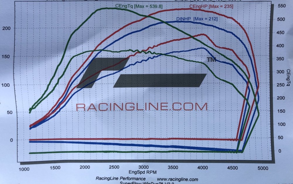

    So as I mentioned earlier, my car went in for a Racingline OEM stage one remap today. Bloody hell is it now fast! The guy said he started with an extremely healthy engine according to the first run on

REMAP DYNO PRINTOUT (1).pdf
Edited by roaddetective
Trying to get rid of my map graph that now appears on every post I make. Maybe someone can get rid of it for me.
