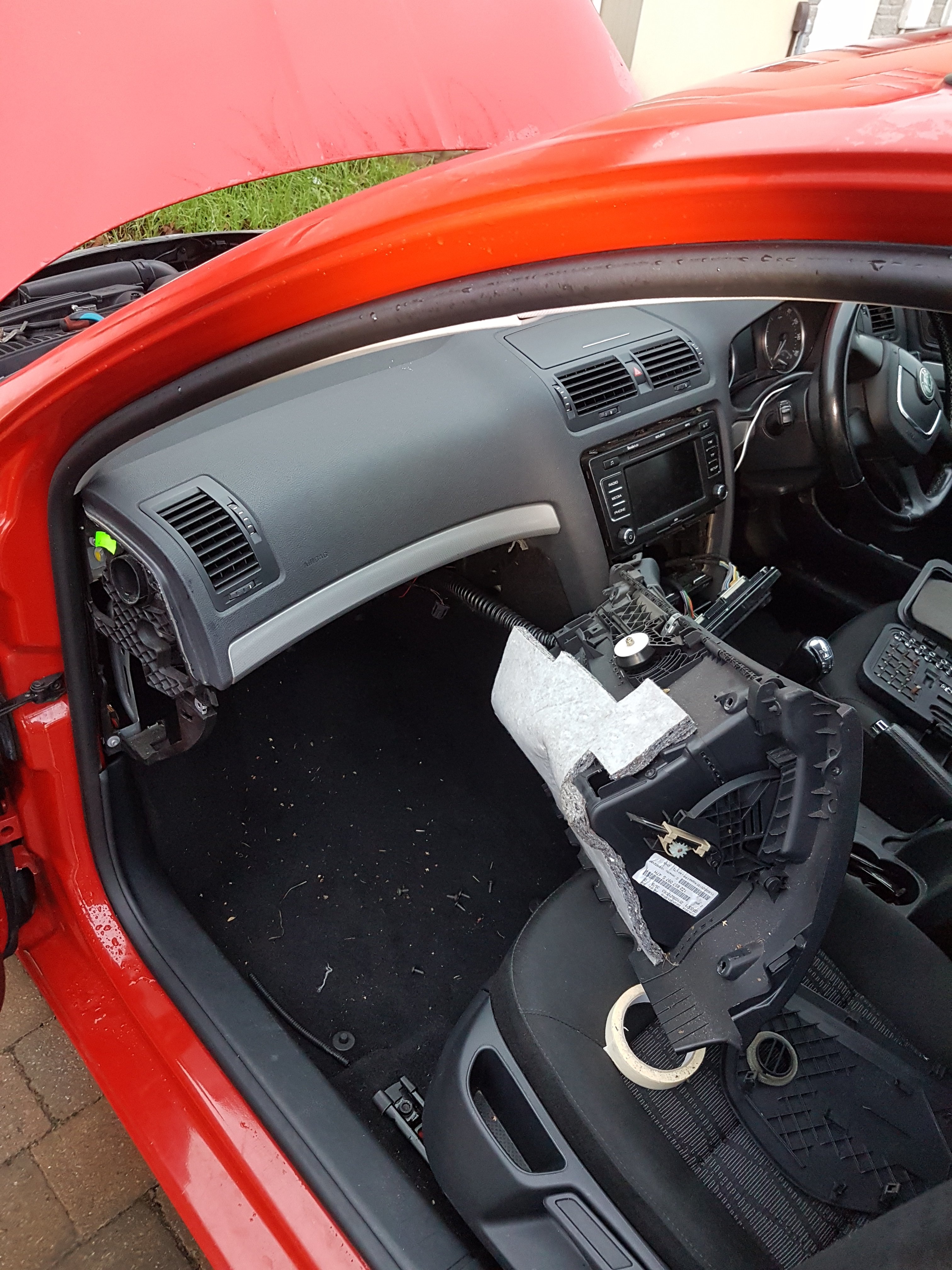

It took me about 2 hours to do the whole job and most of that was spent removing and reinstalling the glovebox which in the end I realise wasn't necessary.

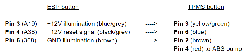

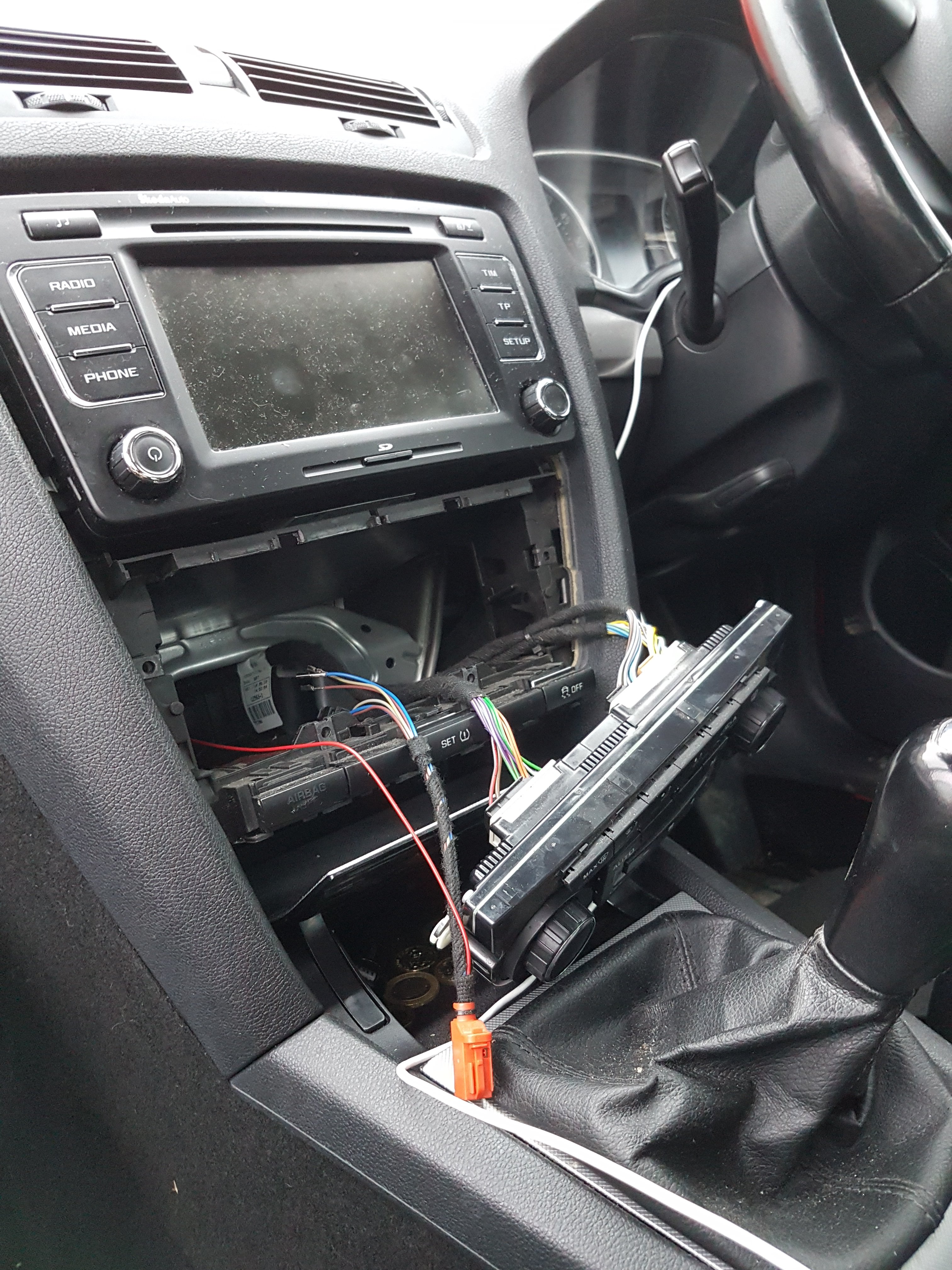

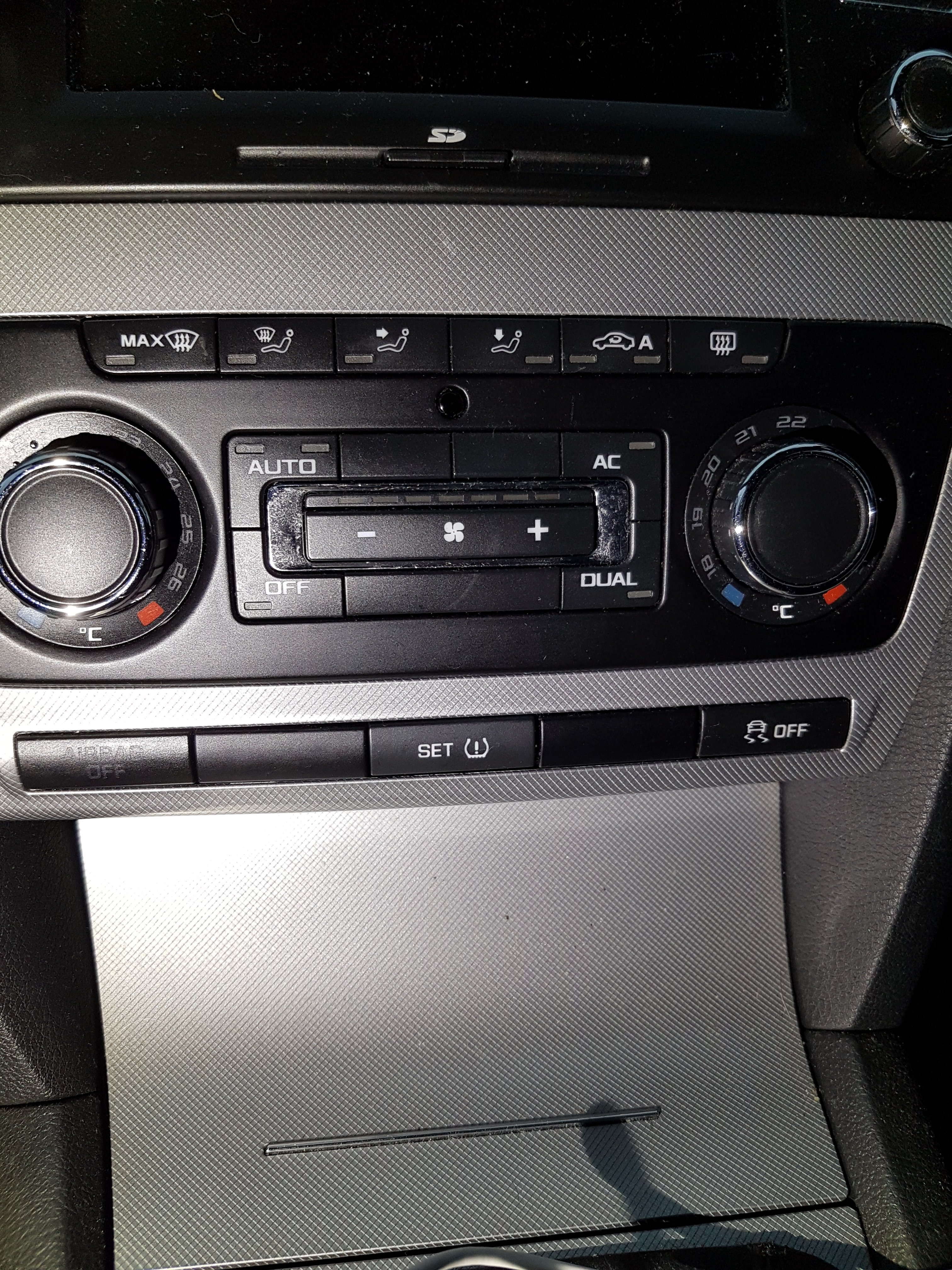

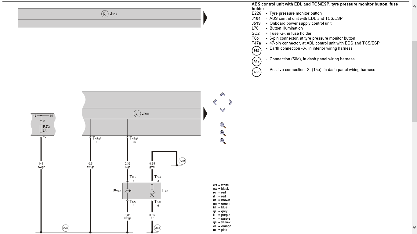

The wiring in the kit piggybacks off the ESP button for its 12V power for the button illumination and also the TPMS reset signal (and ground).  You will need to remove 3 wires from the ESP button connector and insert them into the new connector that comes with the kit. Then insert the wires from the kit loom into the ESP button connector. I seem to remember the wiring loom as I received it had the connector for the TPMS button wired wrong, but I studied the wiring diagrams for the car and corrected it.

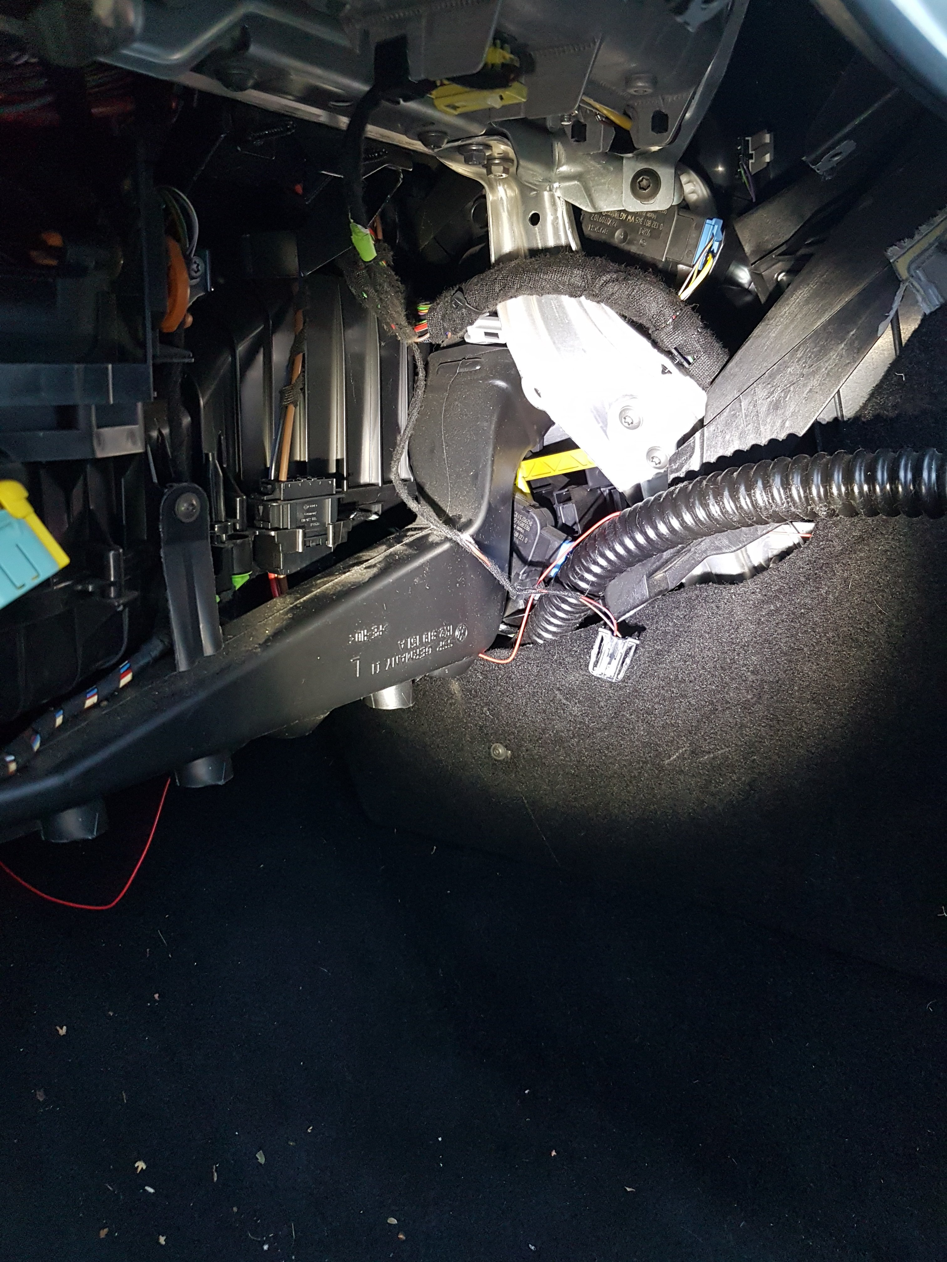

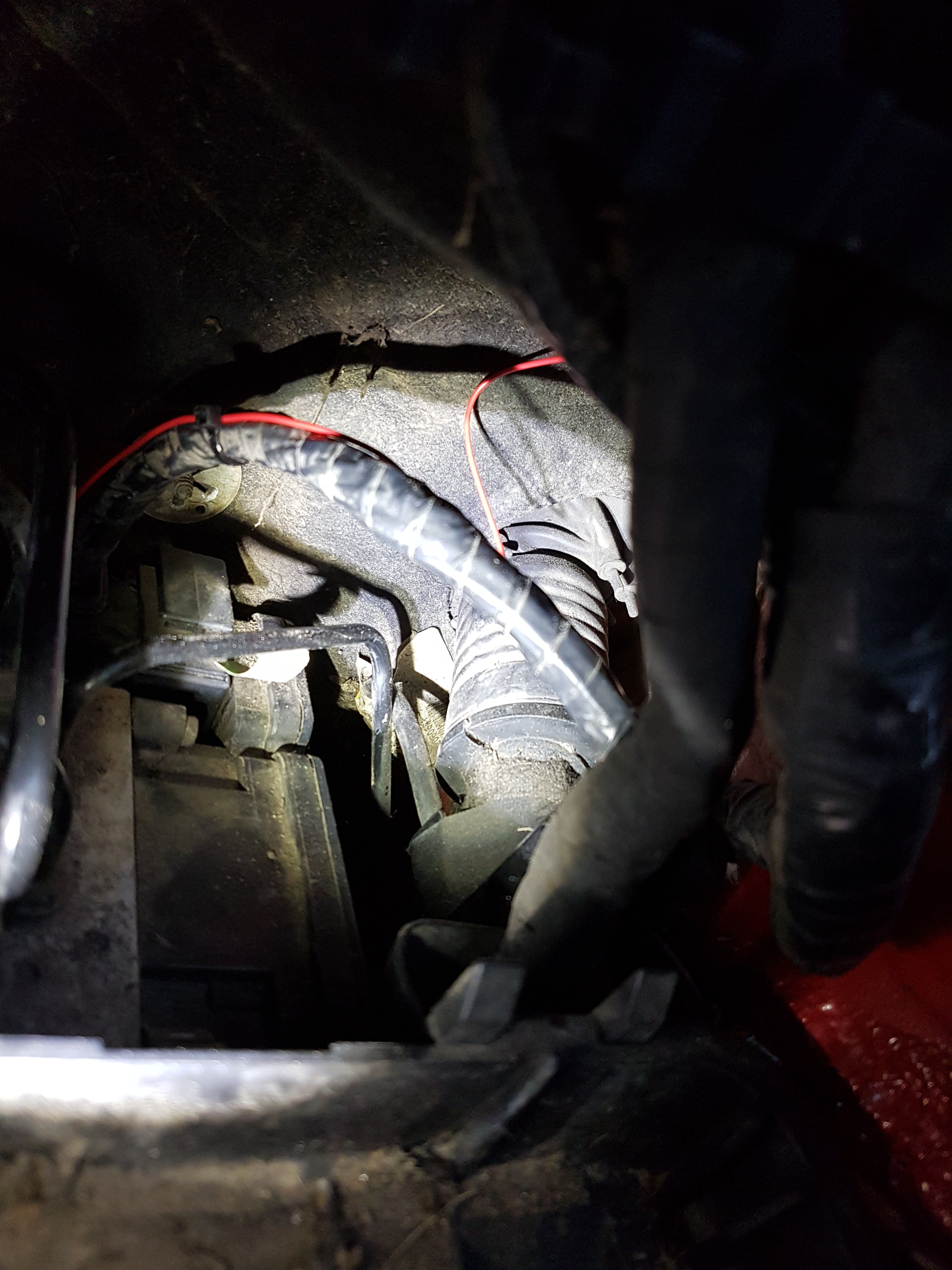

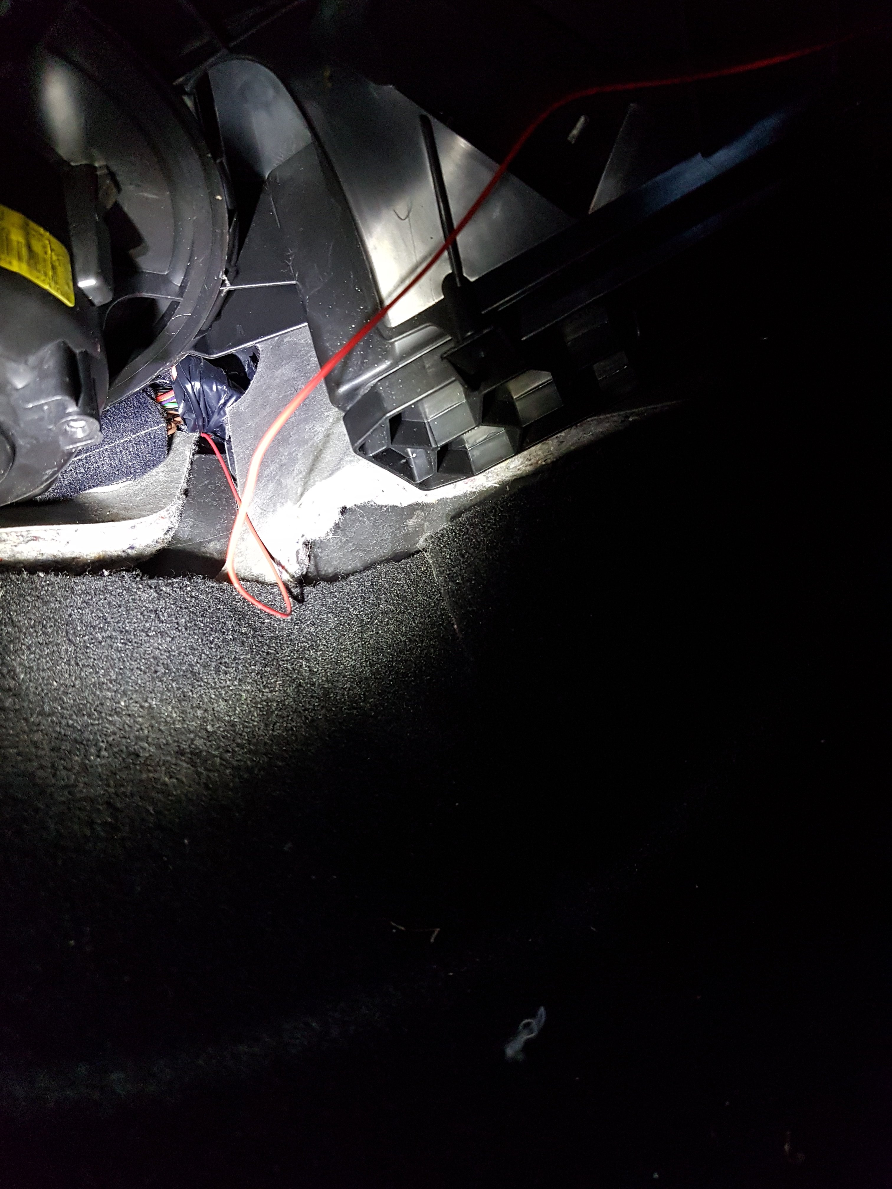

Next you need to feed the long red wire through into the engine bay. There is a grommet through the bulkhead in the passenger footwell up high and to the left. I removed the glovebox to get to it but it is possible to do it without. Reinstalling the glovebox is a PITA and I wouldn't want to do that again.

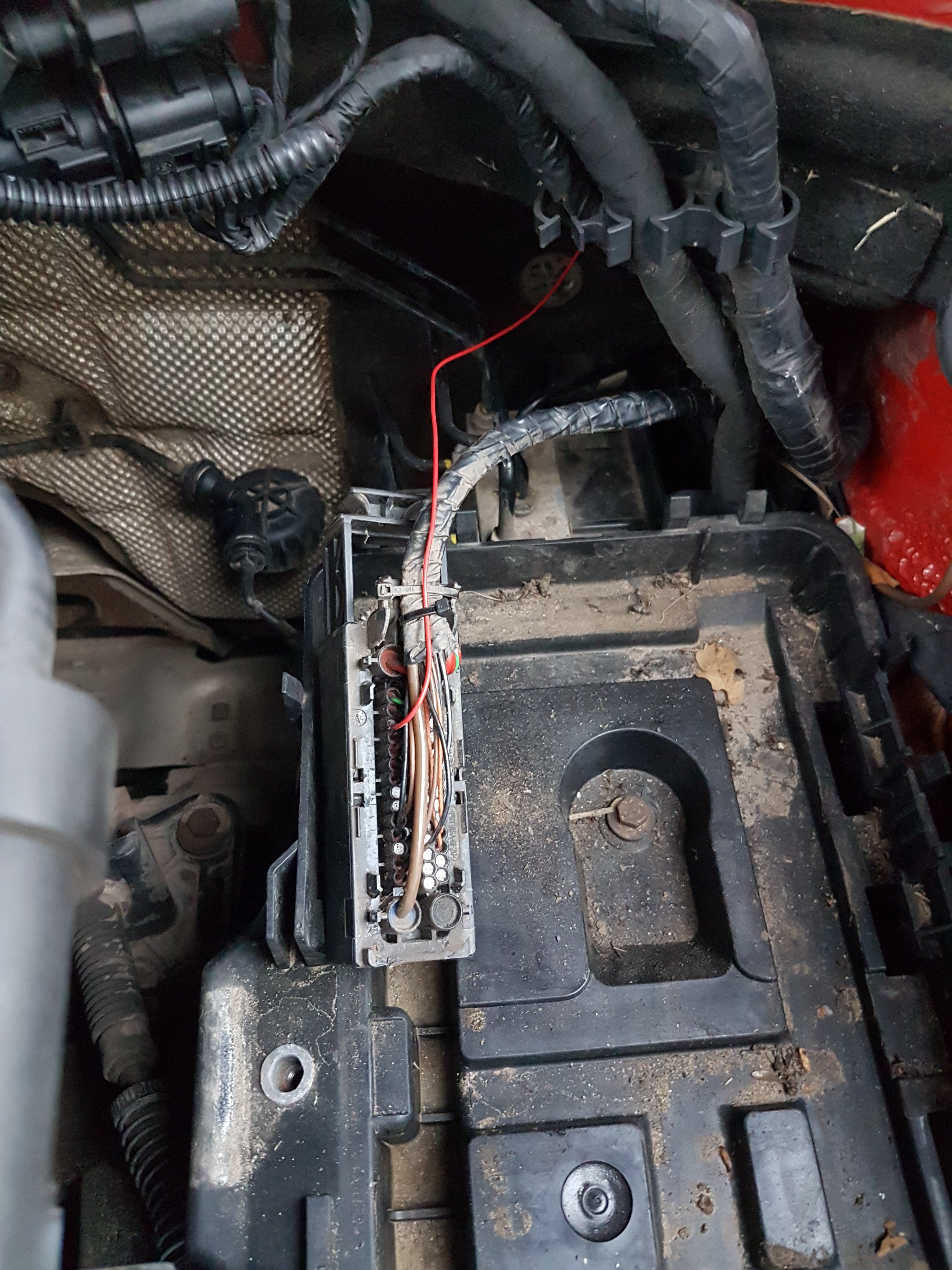

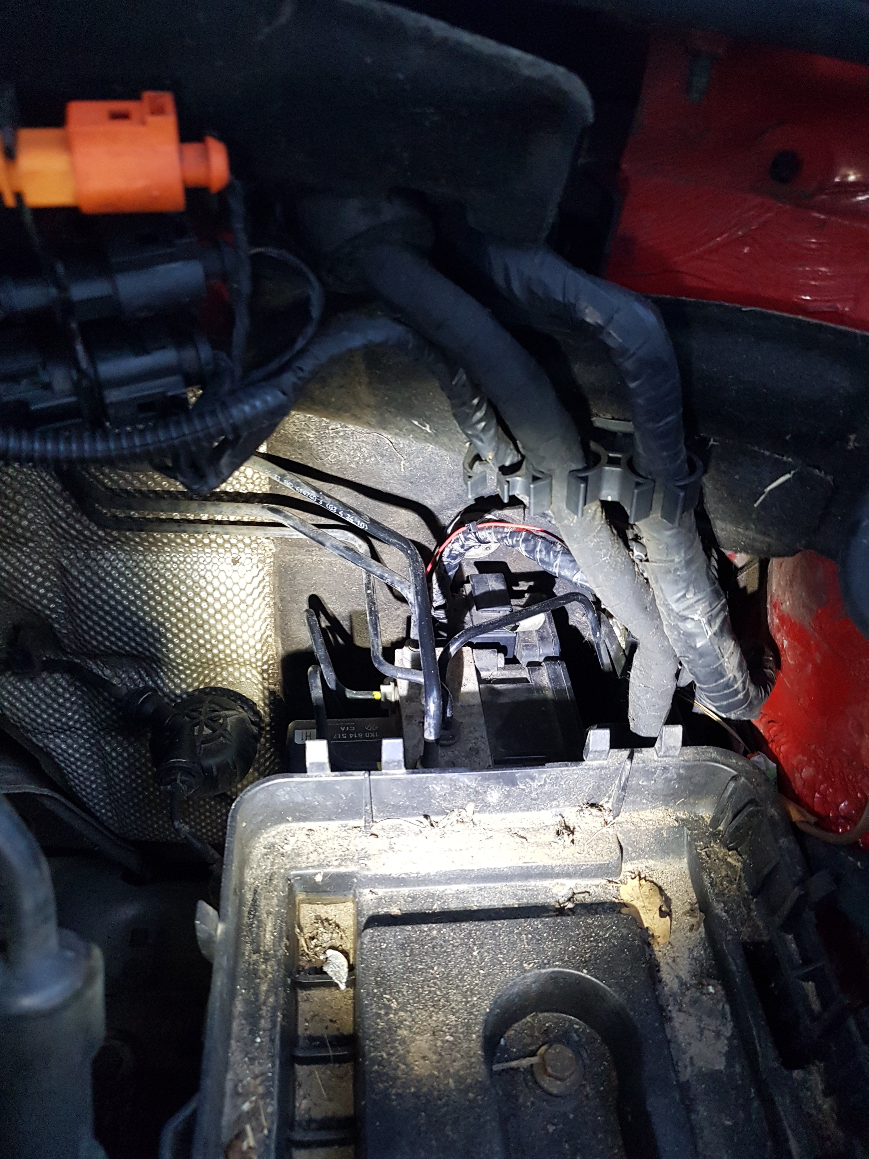

In the engine bay remove the battery so you can access the ABS pump. Disconnect the large plug on the side and disassemble it so you can get to the connector block inside. If your ABS pump is an MK60EC1, you need to connect the red wire to pin 35. You'll have to push out a tiny rubber bung that's in the connector. Put the connector back together and reconnect it to the ABS pump making sure you lock the connector on.

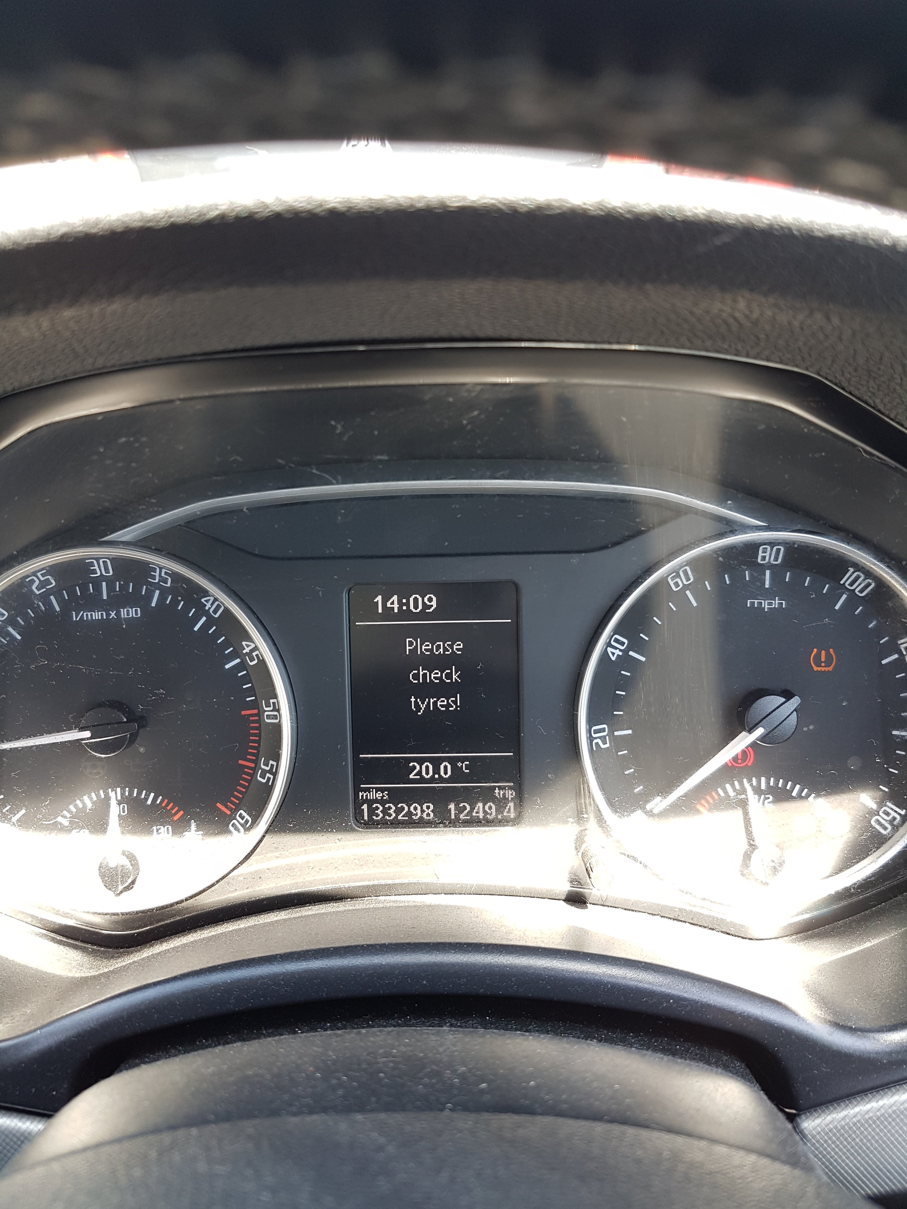

Once coded you should see the TPMS warning light briefly illuminate when you turn the ignition on. Press and hold the reset button and the light will illuminate and then extinguish and you will hear a chime. That means the system is going to learn your current pressures.
