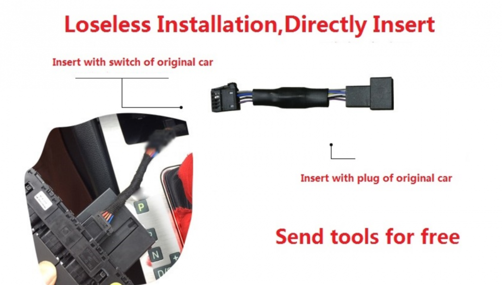

Yes, u can get it coded out permanently using VCDS or OBDEleven, by changing the voltage required.
I'm not interested in doing that as there r times I want the start-stop to kick in, and hence activate it as required.
I've ordered myself one of these devices.  It plugs between the start-stop switch n the car wiring.  It essentially always remember the last selected state of the start-stop, even after turning off the car, n back on.
#Aliexpress AU $38.26 | Automatic start / stop of start / stop treasure default closermemory mode for Skoda Superb Octavia
https://a.aliexpress.com/_dU9riDs
