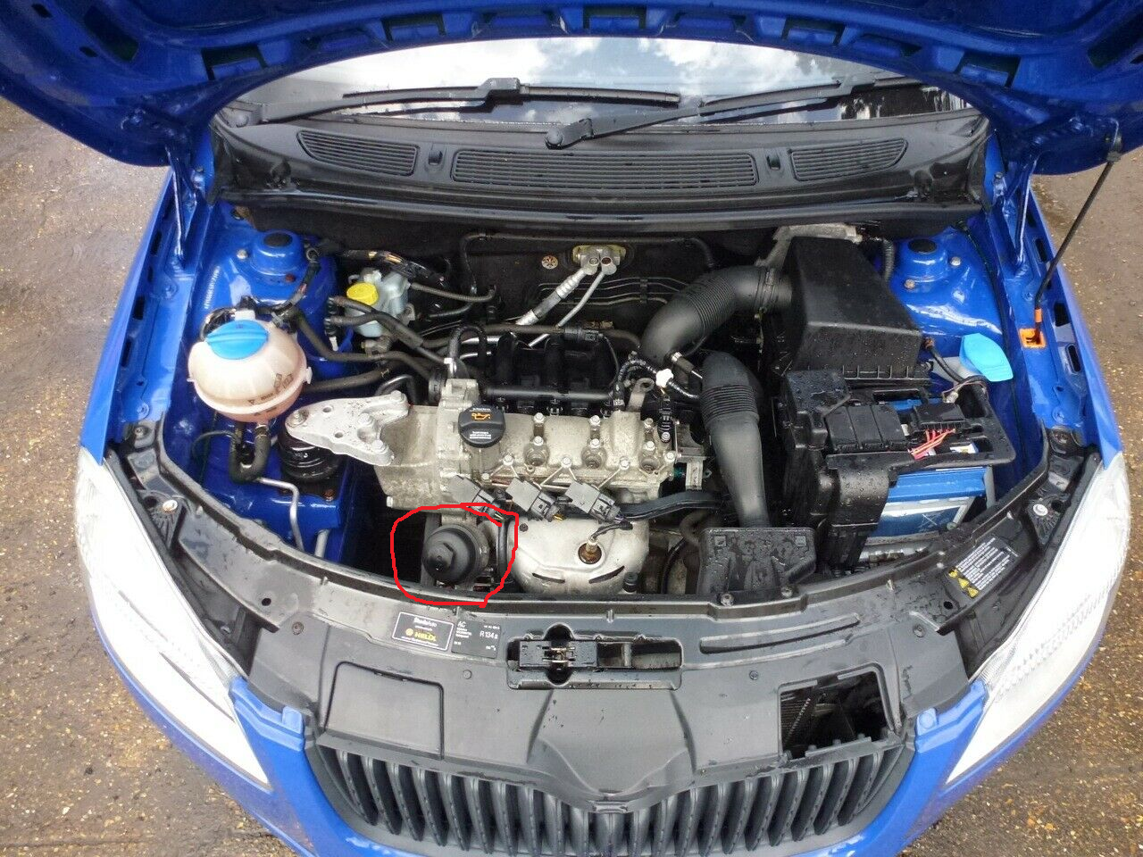

Oil & filter -Absolute canter as the oil filters right in front of you as you open the bonnet, circled below, Only issue is the alternators below the filter, cover the alternator with an old rag or paper towel when removing the old filter to reduce the chance of dripping oil into your alternator. Usual process when replacing the new filter, run your finger  round the seal with a bit of engine oil before screwing back on.
Oil - 14mm sump plug on underside of the engine, Should have a metal washer on it, Sometimes rubber. Should be located more to the passenger side so jack up the car from the Near side(drivers) front wheel and this will ensure you've got a good angle to drain and no oil/debris are left in the bottom of the sump, Again check the condition of the washer and decide if you need a new one or not.

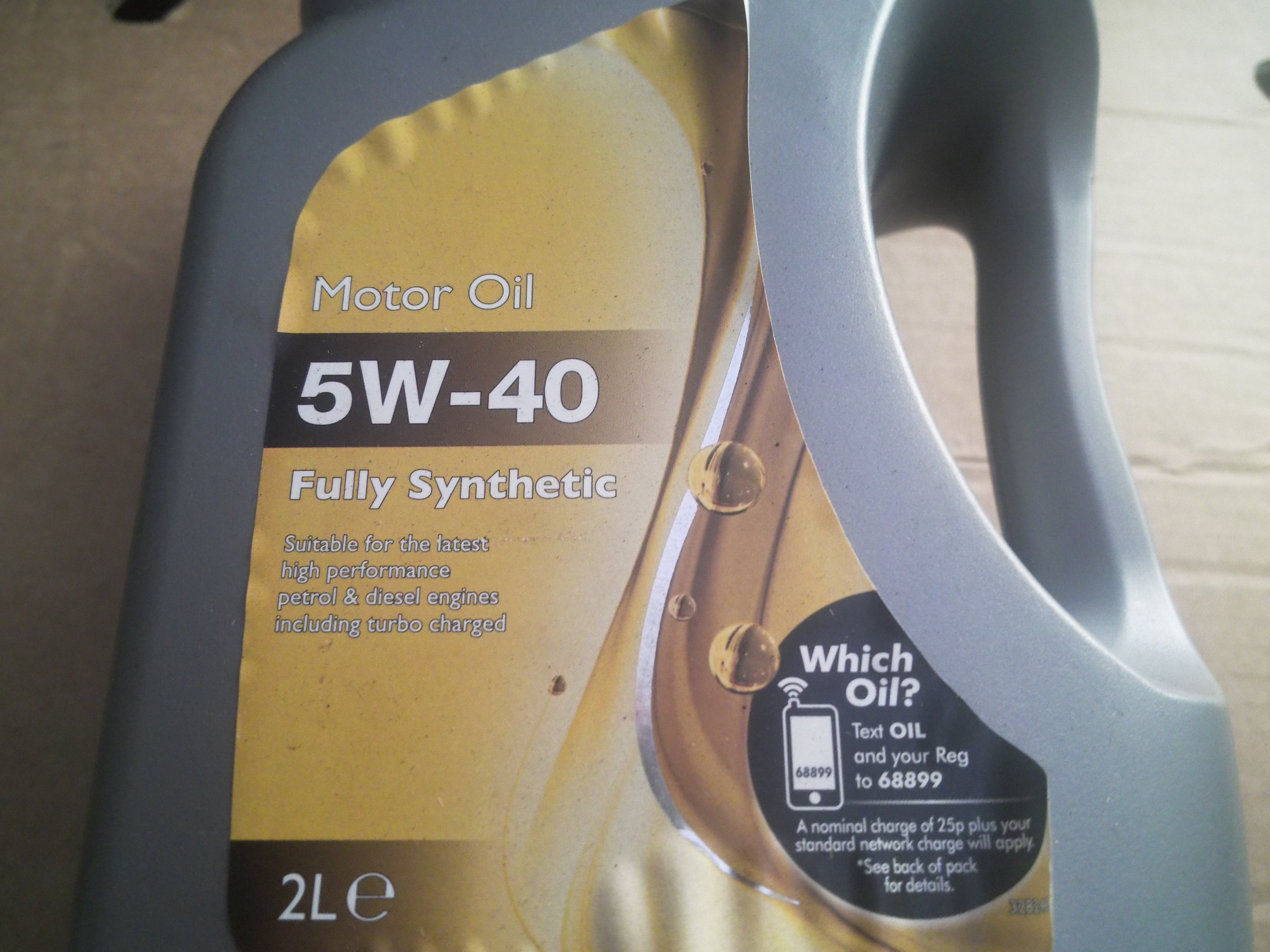

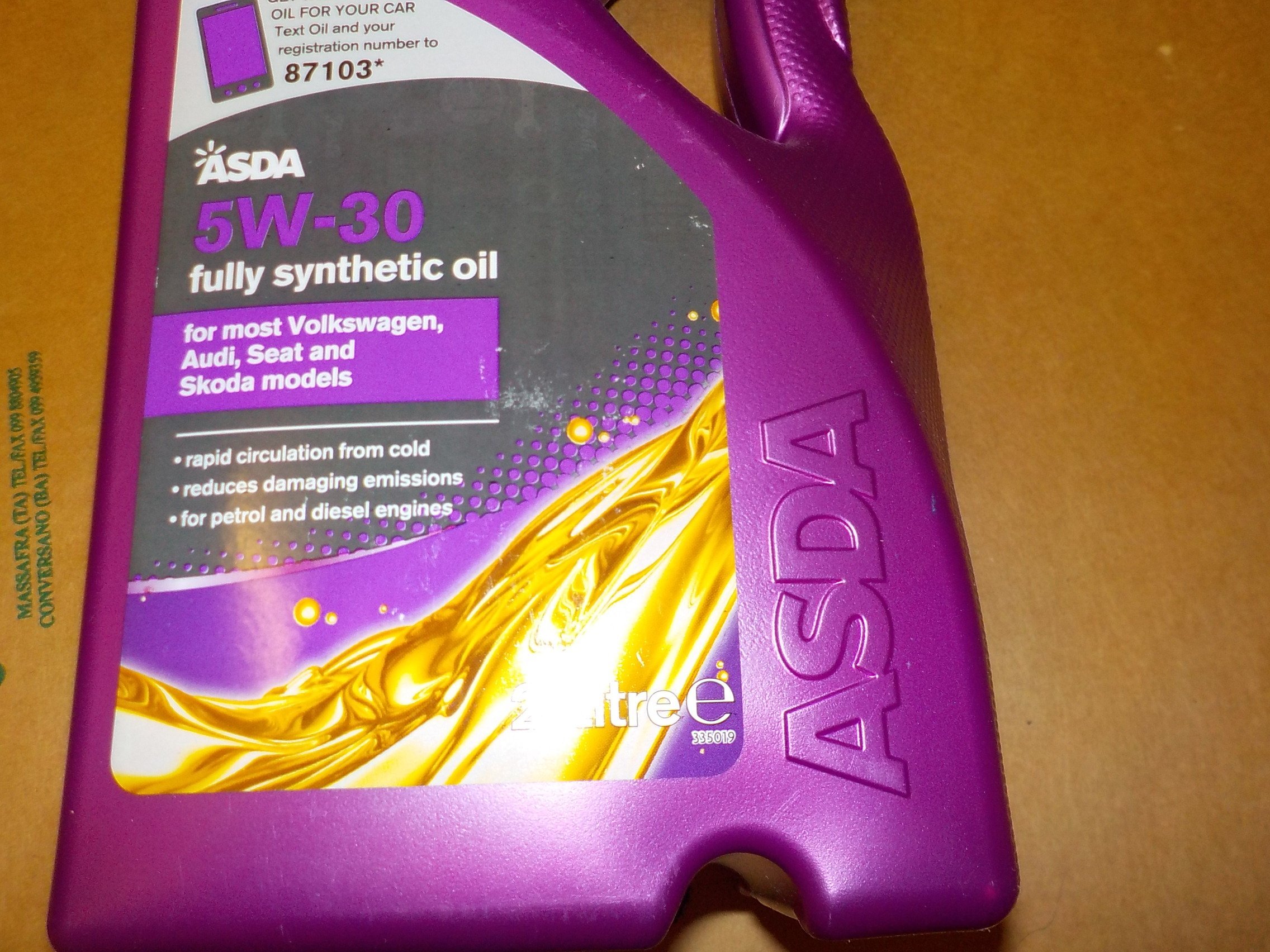

You could pop into Tesco or Asda and there will be 5w 30 Full Synthetic to VW 504 / 507 sitting and quite possibly reduced,
or 5w 40 Full Synthetic to VW 502. If you are going to service annually or at 10,000 miles or under.
Loads of choice about of oil for 'much cheapness'.
& D & A Motor Factors or Dingbro for your consumables.
Support your local businesses. But then using 'Multi Nationals' is OK if the price is right.

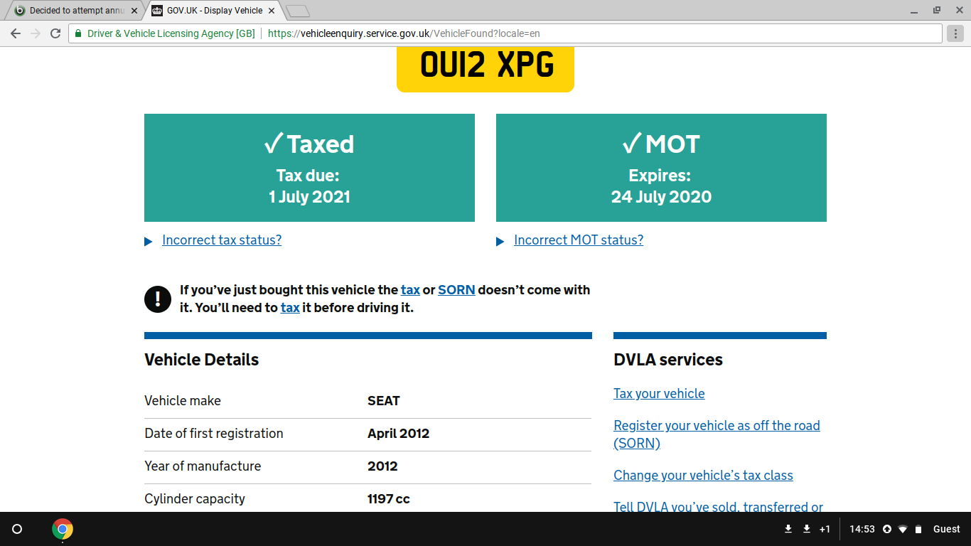

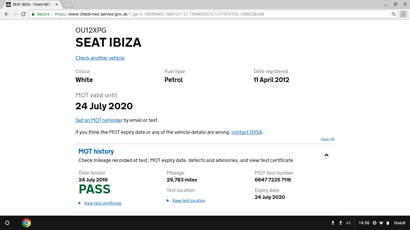

The Reg Number of the one in the picture is showing it as 1,197cc
This was not the one i drove it was blue.
