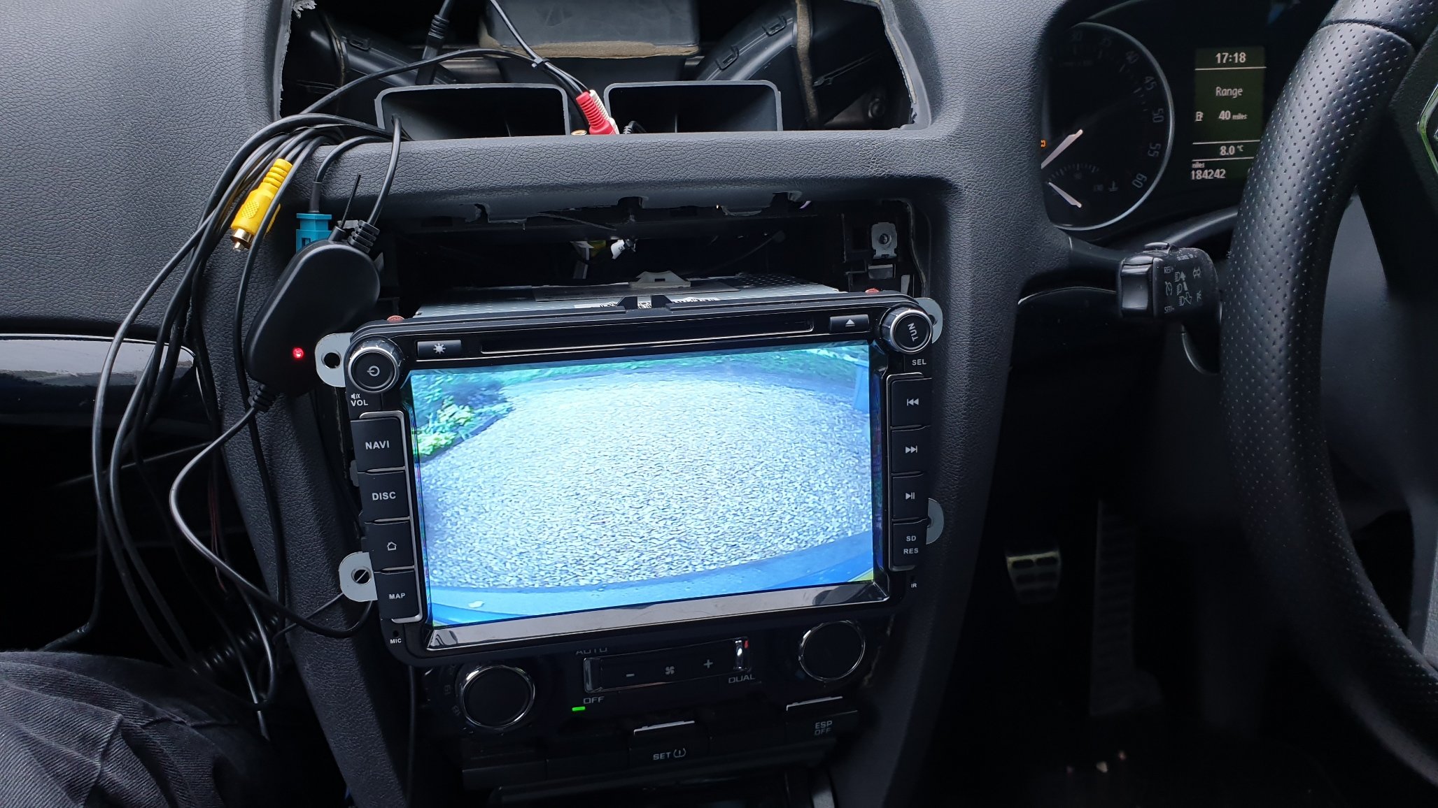

I ran the composite video from the tailgate to the left side of the car body and along the roof line.  drop the headliner slightly at each end by removing the A and C pillar trim and feed a stiff wire along the roof from back to front.  You can then use this to draw your wires/cables through.
My video cable has since broken in the tailgate rubber gaitor... so I've gone back to wireless
Exactly my planned route, cabling along the passenger side roof join and down the a-pillar, and across behind the glove-box into an android unit (to avoid my dashcam power feed out of the fuses and up the other a-pillar)
Please do post piccies. Mines a combi, but I'm guessing tailgate movement could cause a headache with cable flexing breaks ... I plan to fit a connector at the end of the run along the main body - will most likely use a sat-tv screw together union ... and hide that inside the gaitor with the other factory stuff.
I have tried both cable routes and would plump for the roof lining and A pillar.
There is very little room in the bellows, not sure if there is enough for a connector, pulling through the terminated phono plug alongside the existing cables is quite a challenge.
If the connector will go in then it avoids a ball-ache but could cause another, strain relief on the connector or bending the other cables.

Thanks for taking time to reply do.the wireless work ok can you recommend any please?
The cable I ran in broke in less than a year due to flexing.  Maybe a poor quality cable, maybe I left it too tight.  Maybe it will always break over time.  Either way, it's a headache!
Wireless is working fine for me.  I shoved the transmitter up the side of the tailgate alongside the window inside some pipe lagging for protection, and stuck the receiver behind the ash tray in the dash.
