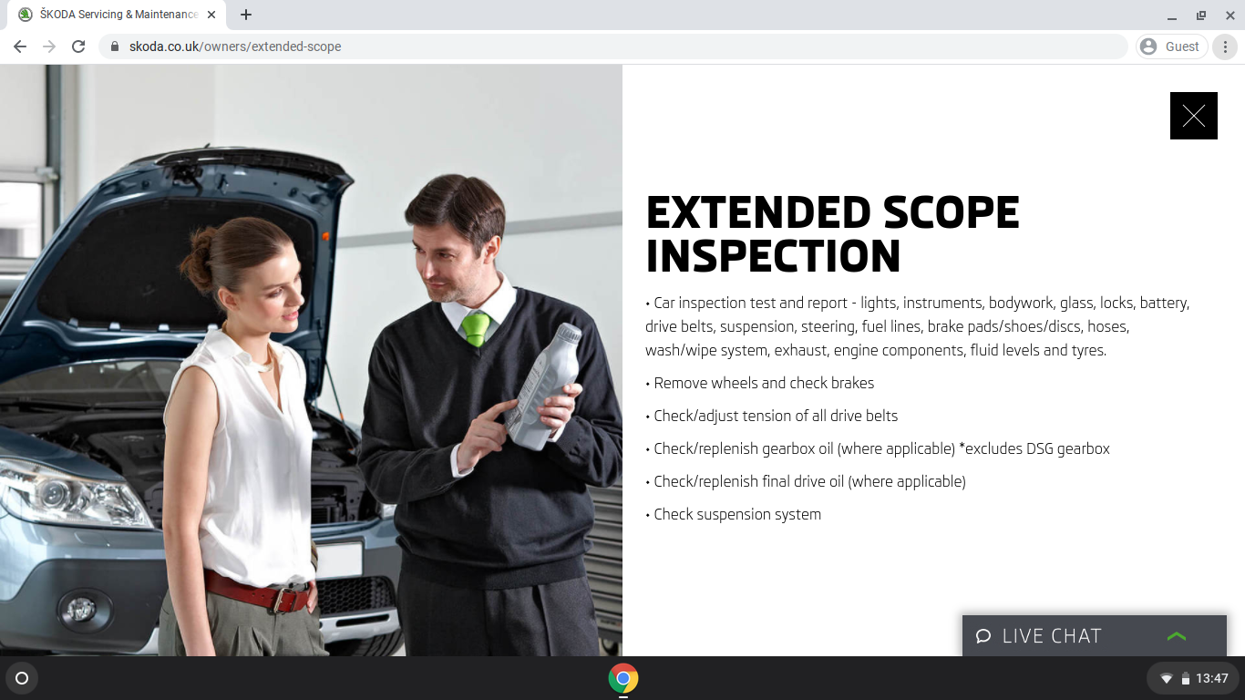

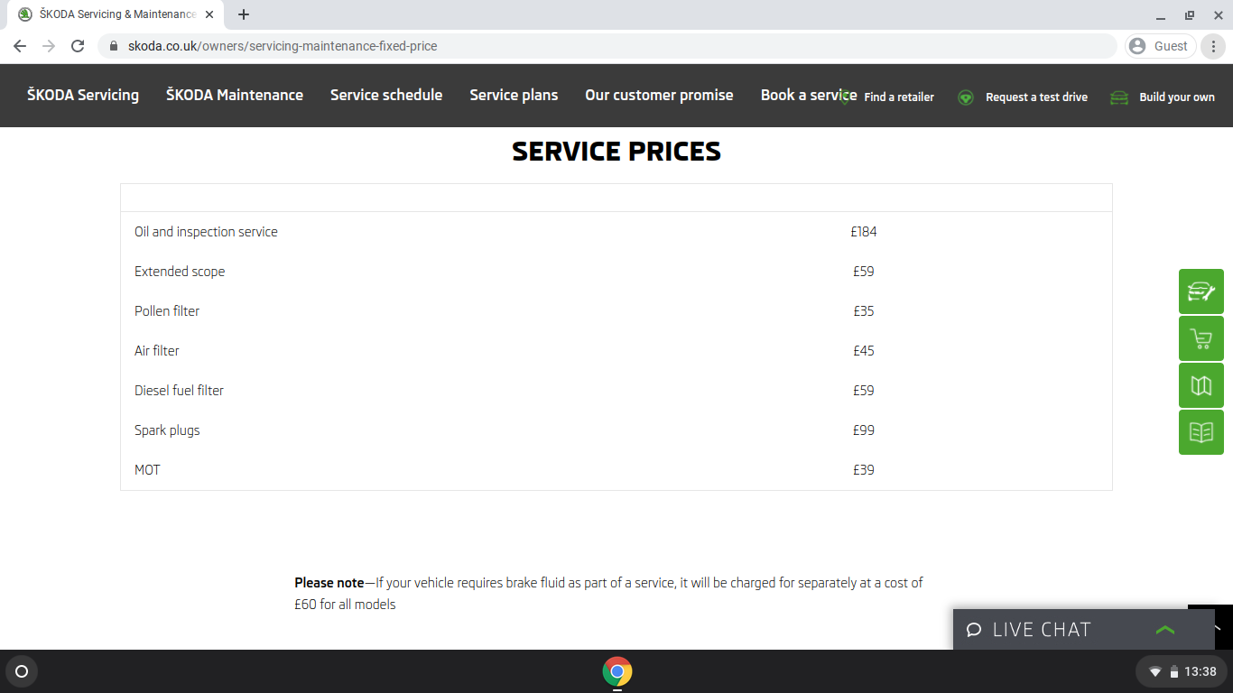

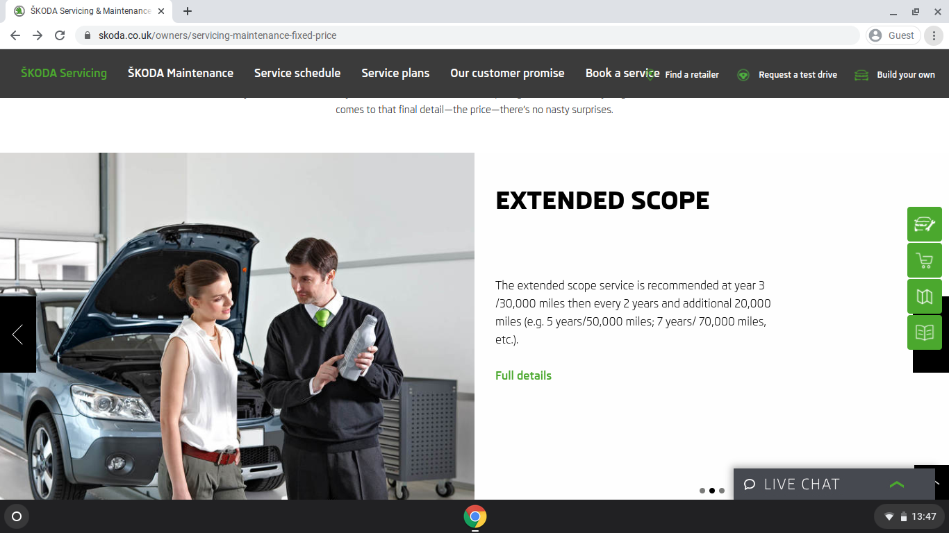

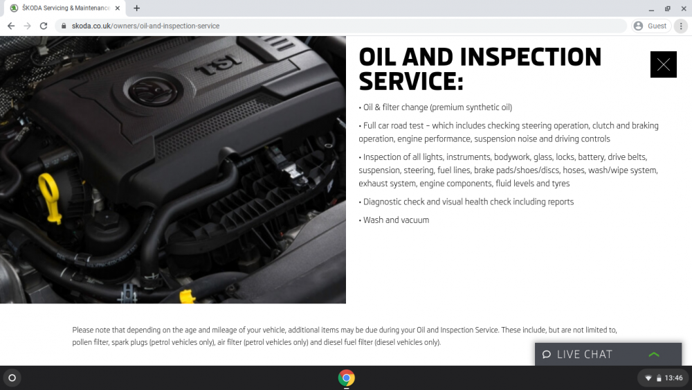

And then when I sit down with my cuppa for 5mins and have a look on Skoda's website, they've updated it again ( must be very recent, never seen that before ) Which means we're both wrong :wall:
NationalPriceServicing according to Skoda UK website
By the time you've read this it'll probably have changed again !
Note how they just say Plugs year 4 and fuel filter year 6.  I'm assuming they actually mean plugs or fuel filter in year 4 and year 6.  Jeeso, what a plucking useless outfit they are.
Edited by Guest
