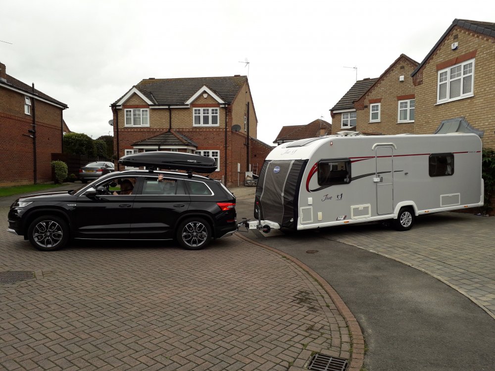

The 1.5 TSI will tow your van just fine.
I have the 1.4 TSI 150PS manual 4x4 Scout and it tows our 1,374kg (MTPLM) Bailey really well...
I've found the odd down change is required to maintain 60mph on the motorway on very steep inclines but with your DSG gearbox you'll barely notice.

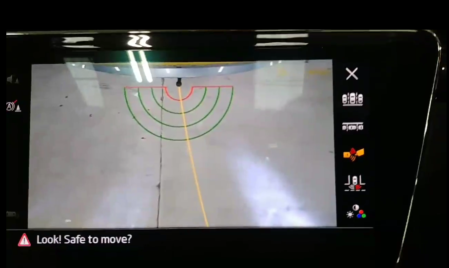

If you get Chris to fit the reverse camera at the same time (I'm booked in on Saturday) then you get this view on the infotainment screen when hitching up, an absolute must if you don't have someone to guide you back onto the hitch...
I would imagine if you had both done at the same time you'd be looking less than £1,000 due the potential time savings?
