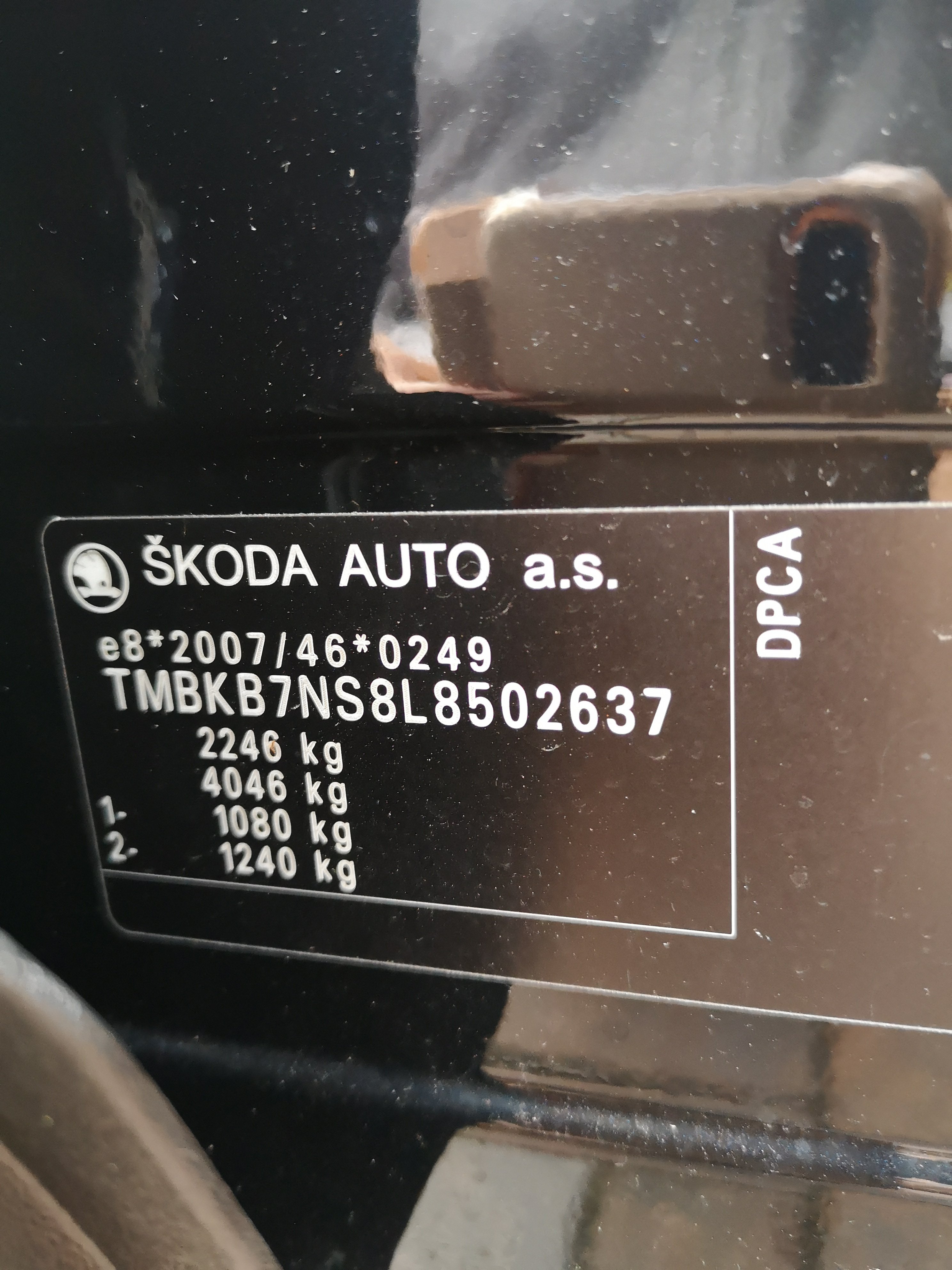

We have the DSG gearbox, I contacted Skoda direct yesterday and they confirmed towing weight up to 1700kg, even though the specification plate of the car dictates 1800kg, not sure why their technical department has reduced it by 100kilo 🤔

xlray
The only difference that I can see for the very similar car Re towing / not for towing, is the extra two seats in the 4WD version............
I'm assuming it must be to do with expected weight inside the vehicle or a different floor-pan due to the extra seating...???
Obviously power and torque values are going to have an effect on the car and how it pulls, but there is no reason you should have any issues if your vehicle is sound and you drive within it's limitations...............
