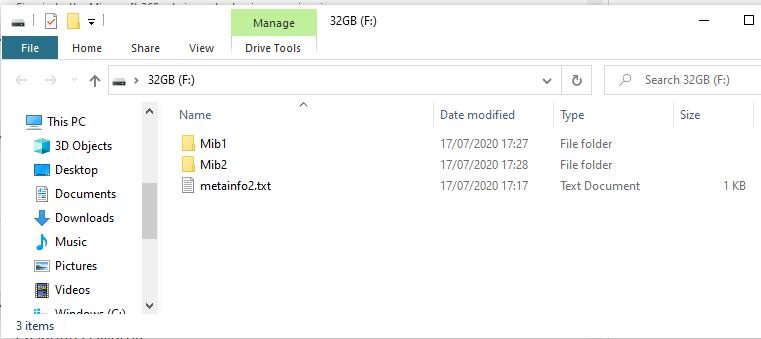

Looking at the files it seems that the Columbus unit searches the root (top) folder of the USB stick or SD card for the file called "metainfo2.txt". If it doesn't find that file in the top level folder then it stops at that point and says that it can't find any data. The Columbus doesn't seem to look inside any folders on the USB stick/SD card - it expects to find the file in the root/top level.
The file "metainfo2.txt" contains information identifying the location of the "Mib1" and "Mib2" folders (basically it says that these folders are also in the root folder). The Columbus then uses that information to locate and read those folders.
So, as long as you ensure that "metainfo2.txt", "Mib1" and "Mib2" are in the root/top level folder of your USB stick or SD card then it should work ok.
If you extract the downloaded zip file directly to the USB stick/SD card then check if the extraction process creates a new folder and copies the files inside that folder. That would mean the required files would NOT be in the root/top level but would be inside a folder and therefore would not be found by the Columbus. This is why I recommend extracting the zip file to the hard drive of the computer first, then copying the resulting files manually to the USB stick/SD card as this gives you more control over where the files are copied to.
This is how the USB stick/SD card should look at the root level
