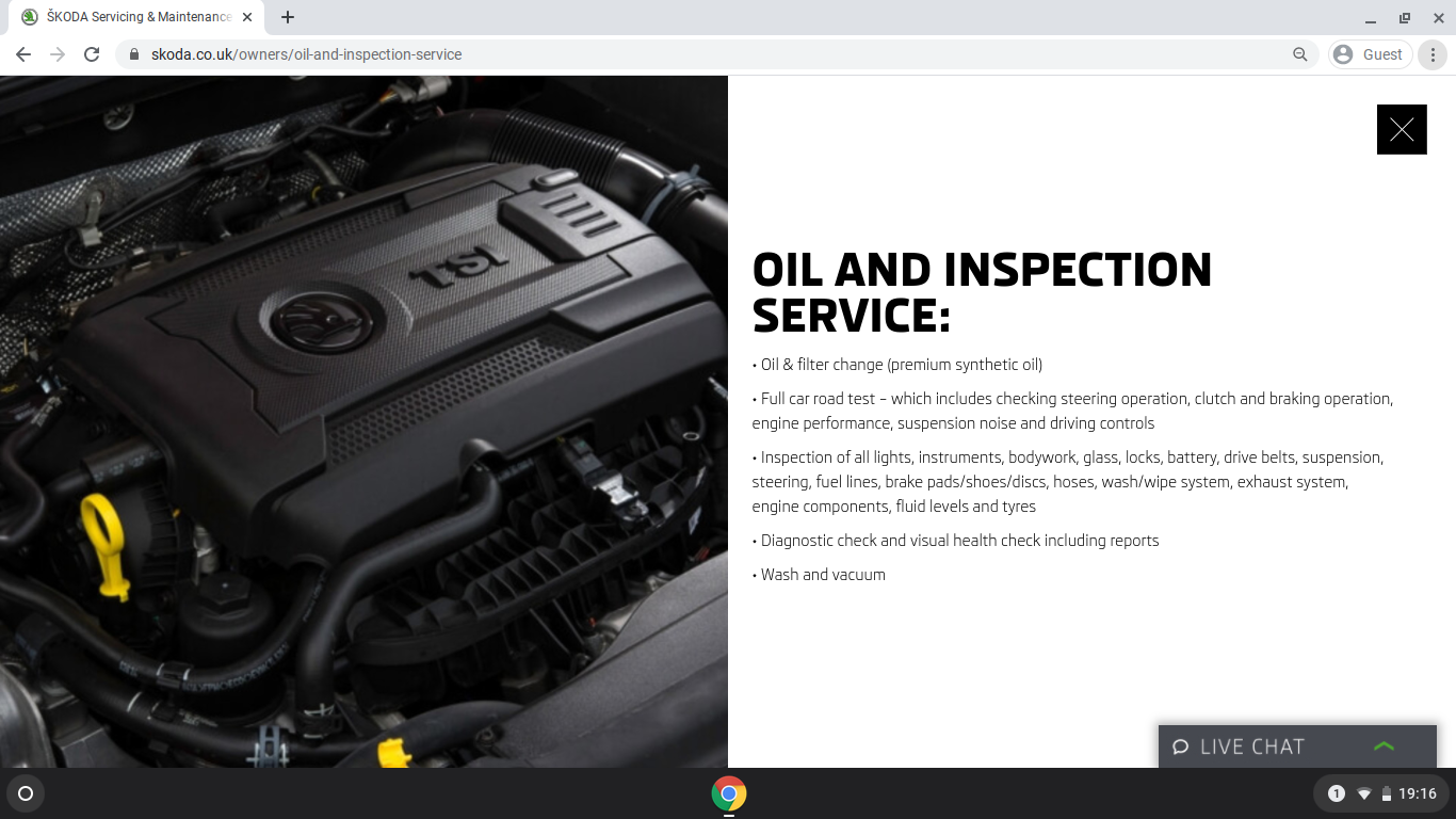

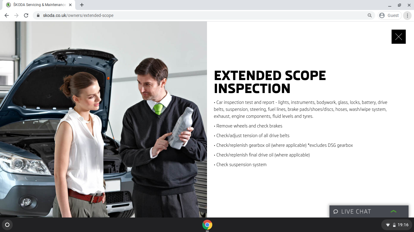

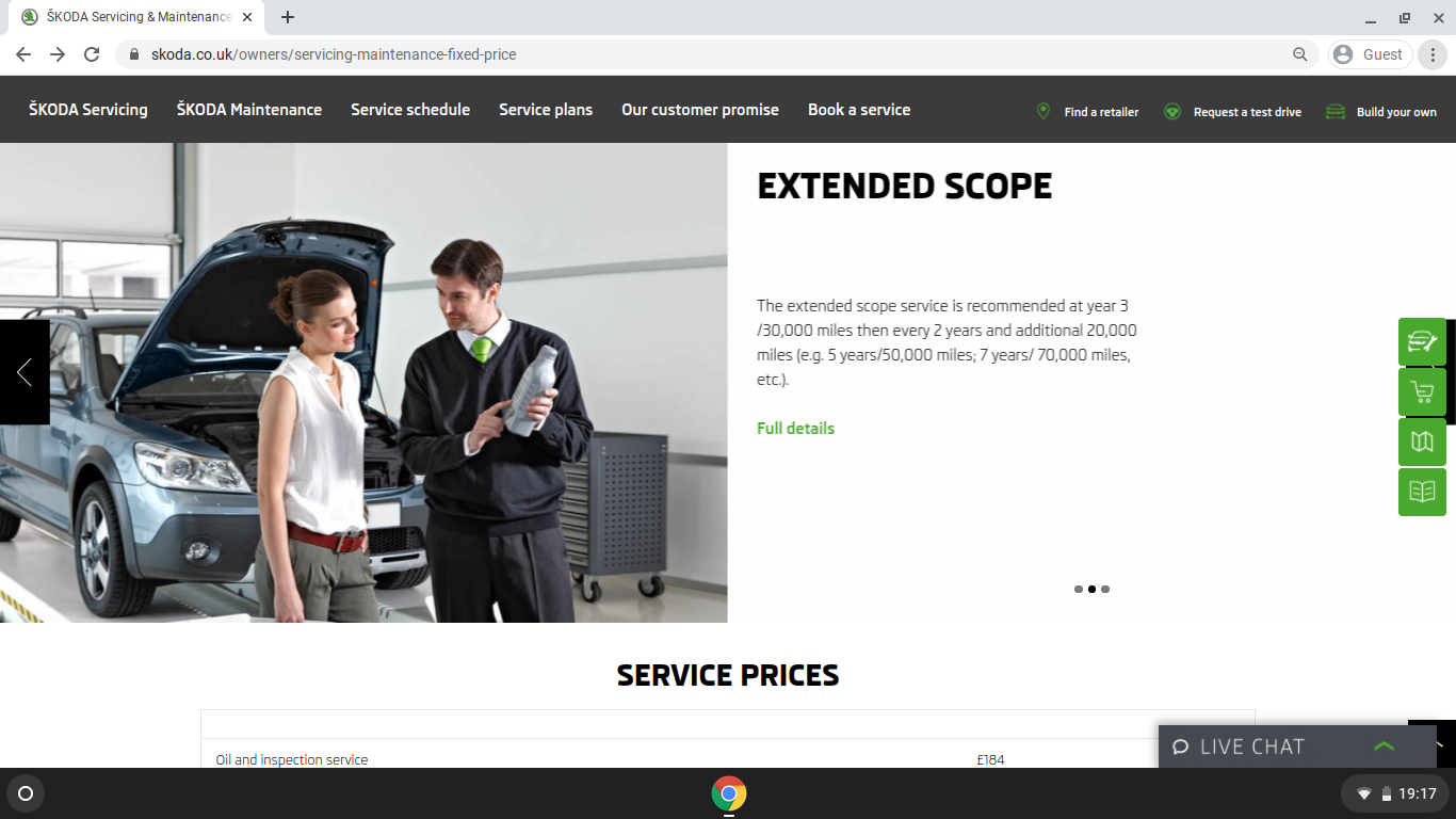

As @Roottoot says, the suggestion from Skoda is actually 4yr/40k. Skoda now publish a PDF they call "Suggested Services Year by Year", covering generic suggested service schedules for cars older than 3 years
https://az749841.vo.msecnd.net/sitesengb/alv1/a06b23b4-1cad-431f-8a9e-9a845954d0e2/NationalPriceServicing.1ca5db45f2690fccdbcc4ad8cae7a857.pdf
https://www.skoda.co.uk/owners/servicing-maintenance-fixed-price

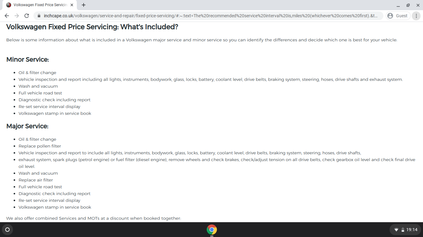

I'm not quite sure why there a problem.  To answer your question directly, I think it's fine. Air filter gets changed every 2yr or 20k.
Where did
the 30,000 miles comes from, perhaps you can elaborate?
And I'm even more puzzled by ROOT's reply re: 40,000 miles because the answer is in the screenshot he posted.
Major service - Replace air filter.
If you are on fixed intervals then basically it's minor, major, minor, major etc.   Servicing is every 10k or 12mth whichever comes first which means the air filter will be replaced every 20k or 2yr.
If you're on longlife servicing then basically it's a major service every 2yr or 20k, whichever comes first. i.e. the same time interval.
Skoda make some maintenance questions really difficult to understand, but this one is easy peasy.  Of course the owner can replace the filter more often if he or she likes.
