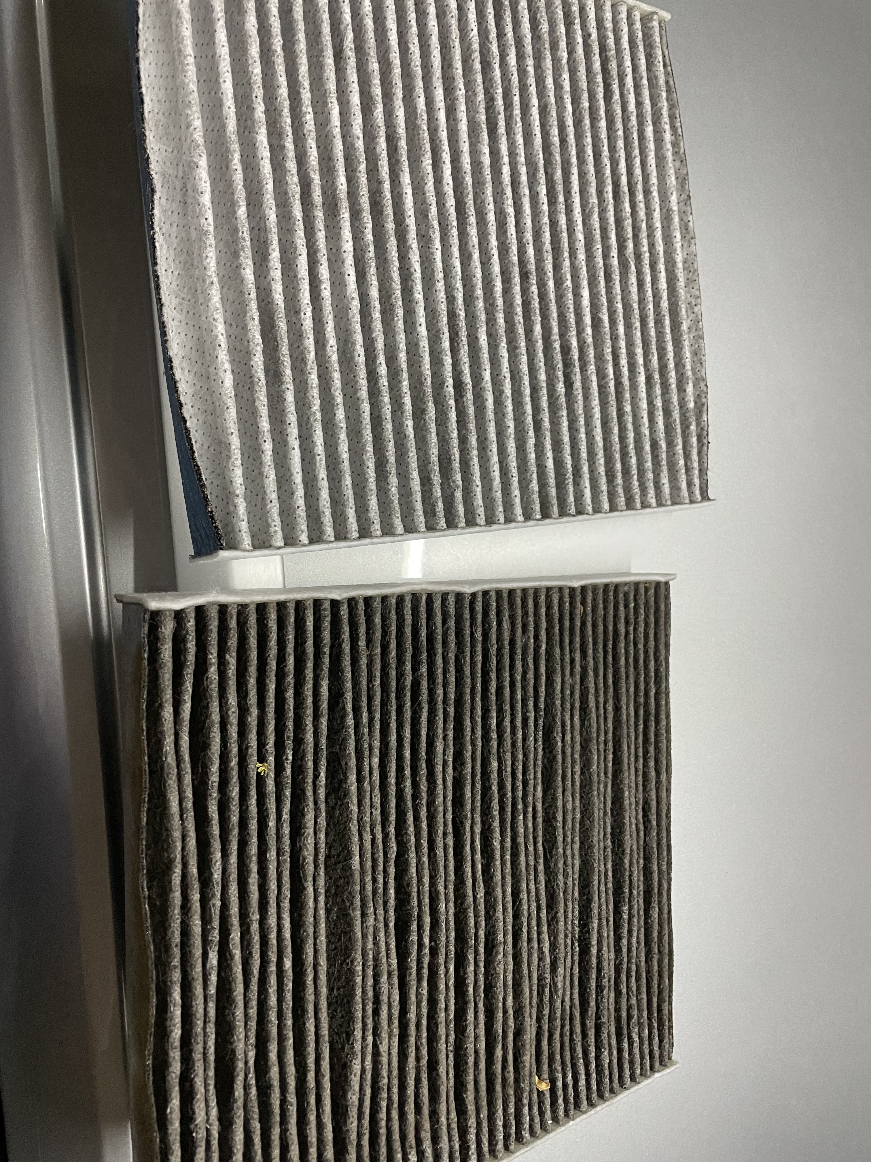

I’ve just changed my cabin/pollen filter on a little more than 10k miles and wanted to show you the difference( the one on the right was as clean as the one on the left ).

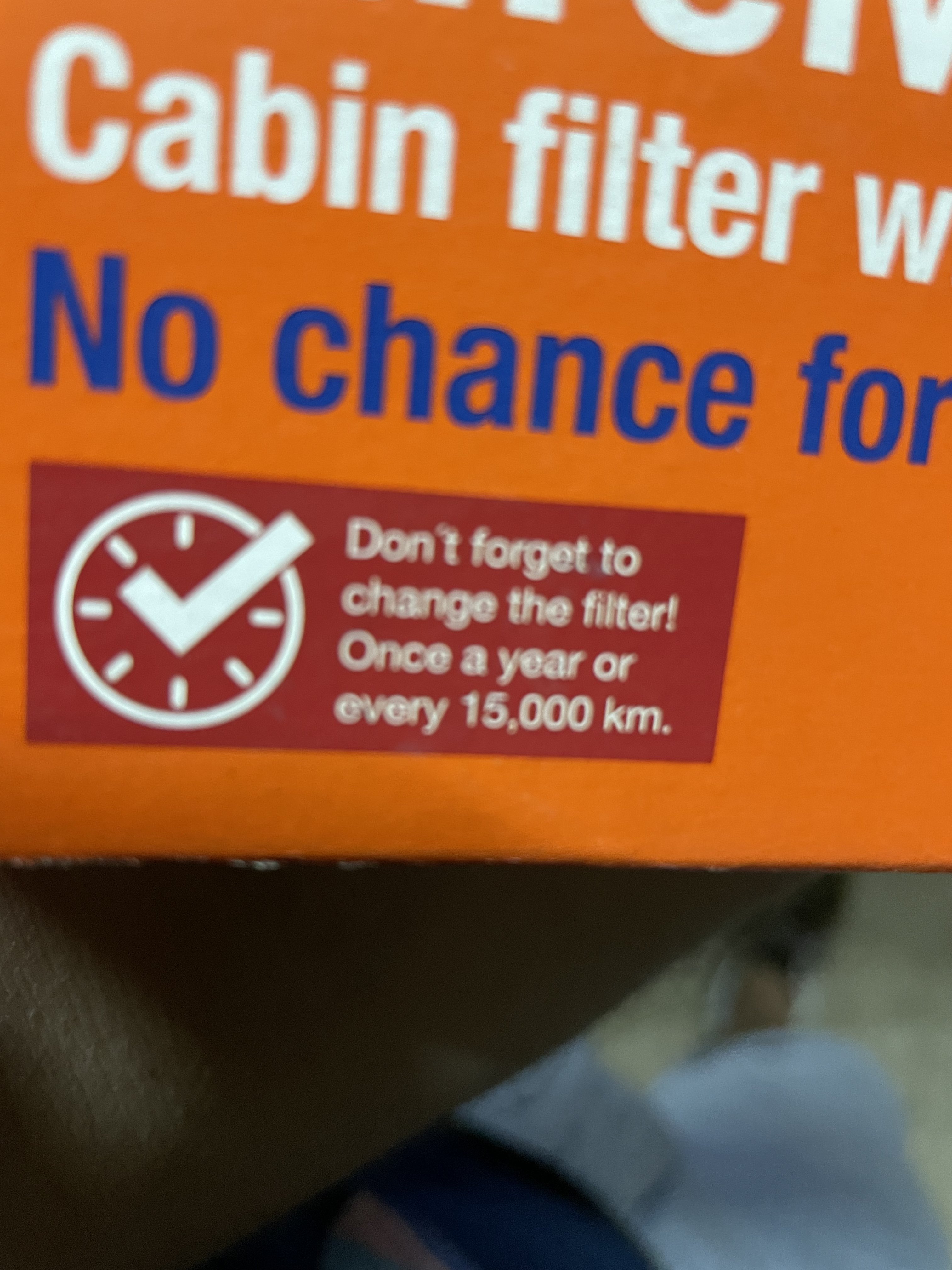

I’ve also took a shot of the label on the new filter box.
I wanted to buy Mahle, but found Knecht on a better price. It’s the same company and therefore the products they offer.
