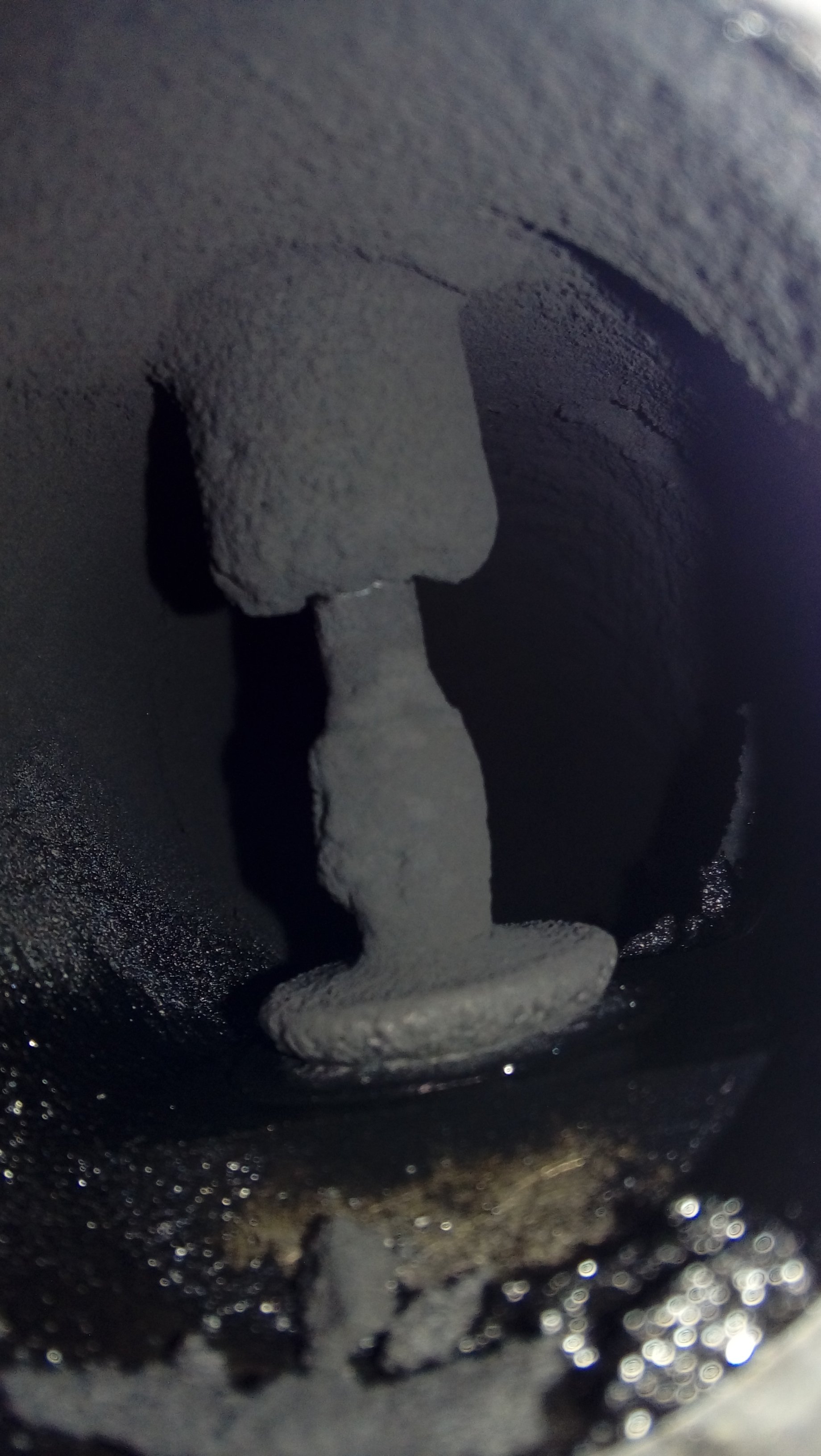

Previously cleaned out EGR back in October 2019.
Cleaned EGR again and on same journey now trip computer reading 63mpg instead of 53mpg.
Car had new EGR at 60k ish due to shaking engine on idle, slow warm up, poor mpg.

I bought some test tube / pipe cleaning brushes and solvent cleaner for EGR which has definitely yielded a significant mpg improvement. Had to remove ASV each time to properly clean.
5mm allen key hex female  bolts x3
Needing to clean after 6k miles 9 months seems excessive, but yielded results.
