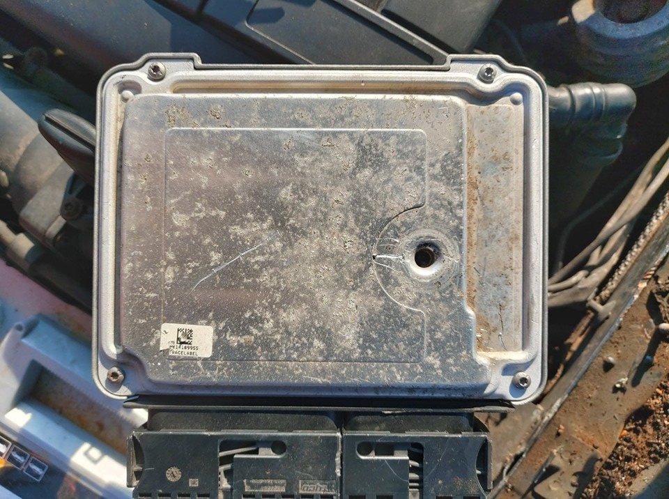

I took the ECU out and had that checked and getting it back today hopefully but they say its working fine and nothing wrong with it.
do you think it could be the connector to the ECU? maybe just a case of spraying in some connection cleaner?

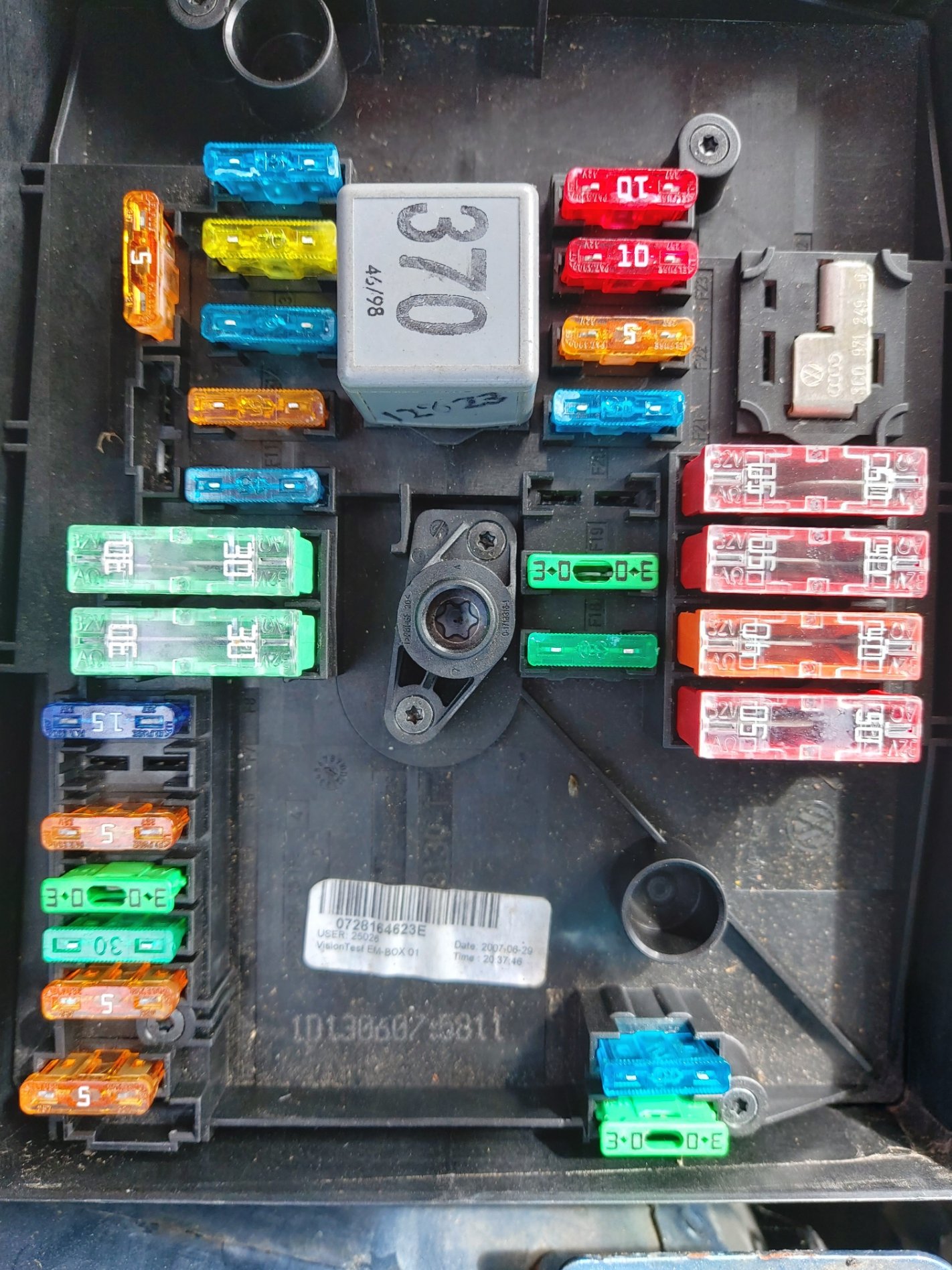

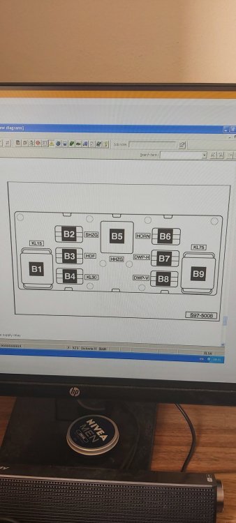

    Check/replace the fuse if you haven't already, relay coil fuse is number 10 in the e-box, should be 5-amp rated. Look for corrosion or looseness of contacts, as well as fuse itself. If that is OK
  • It's quite probable that the ECU has more than 1 12v supply to it, but you need the wiring diagram ( which Wino may have access to ) to see.   Also might be worth removing the battery lead f
  • Sponsor
If that is OK, check continuity between ECU pin 49, and pin 6 of the 40-way connector to the e-box, that's the wire which the ECU grounds to energise the coil.

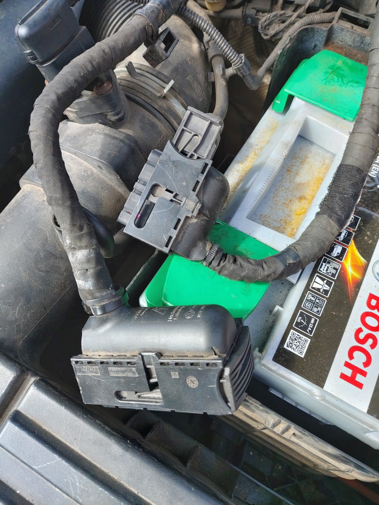

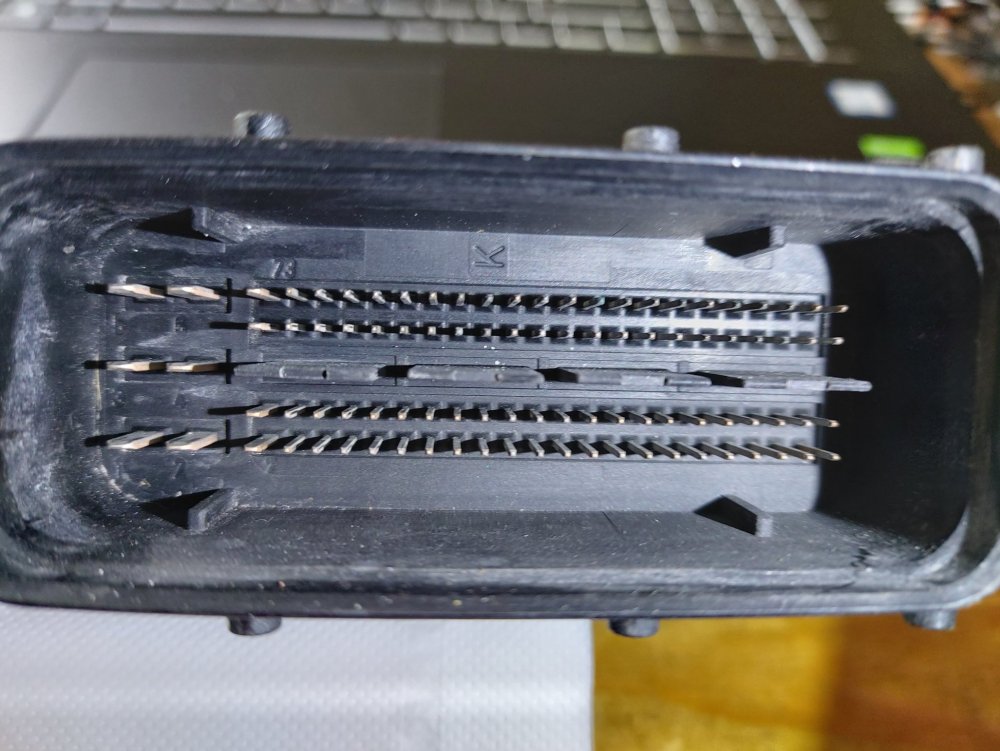

Should be fine,  but don't overdo it; and don't bother even trying if everything in there looks clean and shiny. They're usually pretty well waterproofed.
I have seen some pins come loose on an ECU connector and get pushed back inside the plug/socket.
It's just at an age where electrical gremlins rear their heads due to vibration/corrosion.
Just scan for an indication of which system is faulting and check the relevant wiring and connectors.

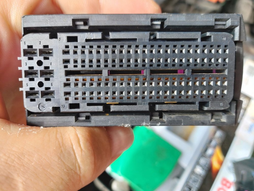

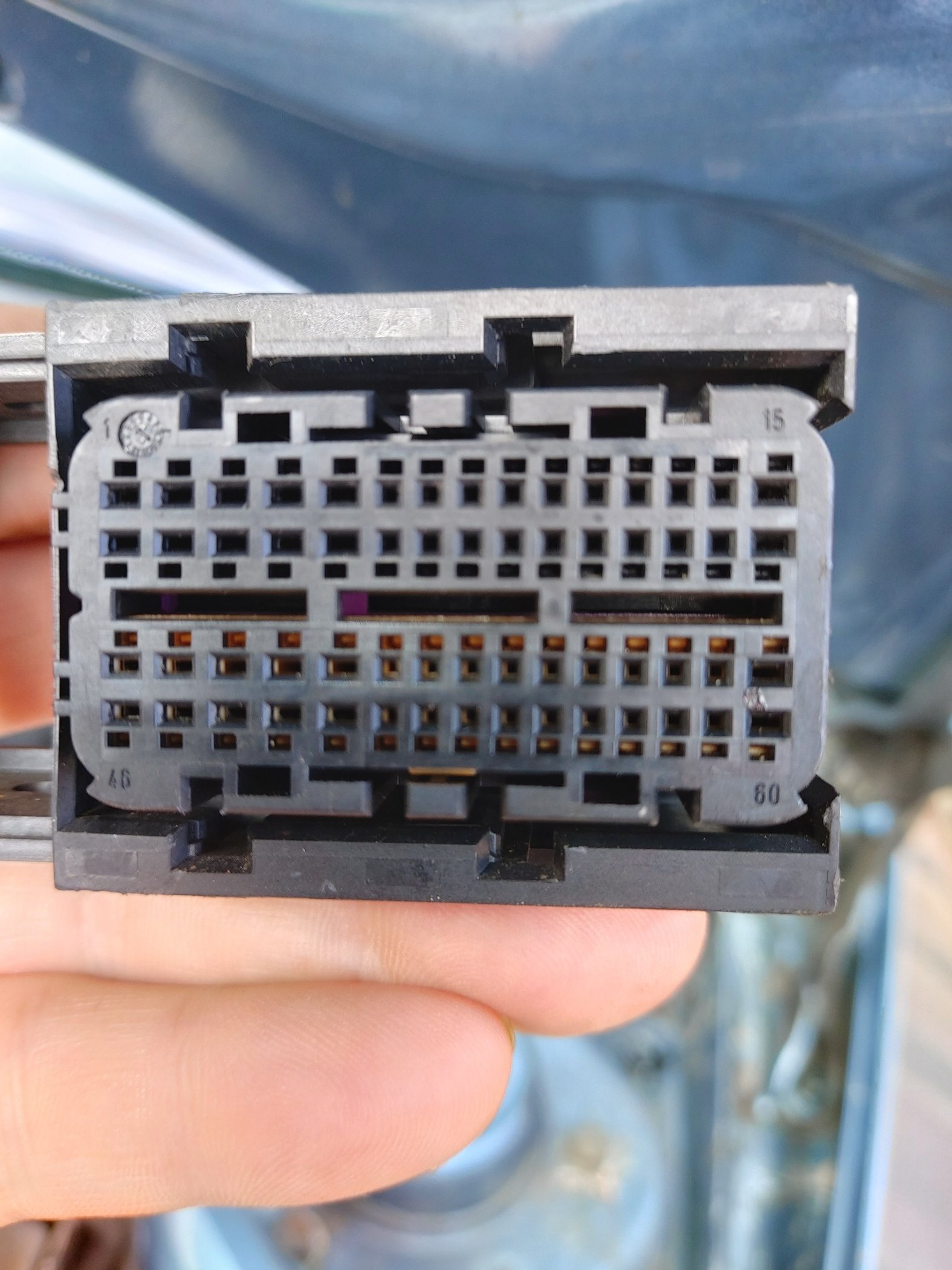

Those points are either end of the same wire. Yes, the engine bay fusebox. Connectors nearly always have pin numbers marked on one half or the other of each plug/socket, if not both.
PM me if you get stuck, or post photos of whatever connectors you find.
  • Sponsor
Thinking about it, it's probably easier to unplug the relay from its socket, then test from (unplugged) ECU loom connector pin 49, to each of the contacts in the relay socket. It should have continuity to one of them.

Here's some photos just been out there as the ass left the engine bay open to the rain and all the pins and fuse box had water in them had an hair drying on them all for ages
20200806_151208.thumb.jpg.de4e9044391d49ed1e22a0c8dd026525.jpg20200806_151215.thumb.jpg.87fd329a46b3ece2608c455473a0c373.jpg20200806_151230.thumb.jpg.c7e16cbce95d8992c3c2d5c8c752fbc1.jpg20200806_151249.thumb.jpg.7eb828f18f654344fc5d717da412454f.jpg20200806_151729.thumb.jpg.e944a8b4d74a04cf5bba1c42320f5153.jpg20200806_151740.thumb.jpg.4cf7a323c94784adb3126fb4906992c8.jpg

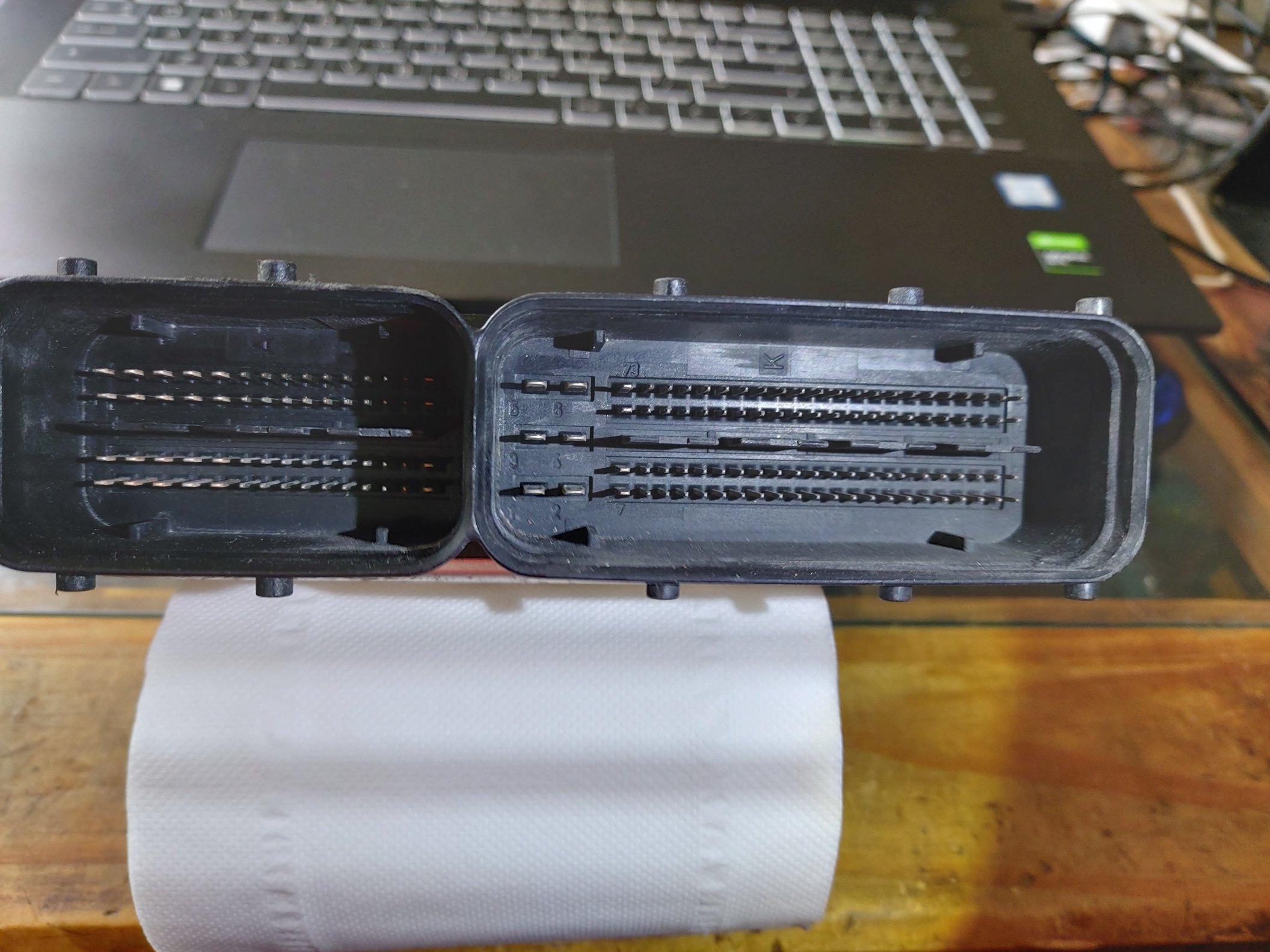

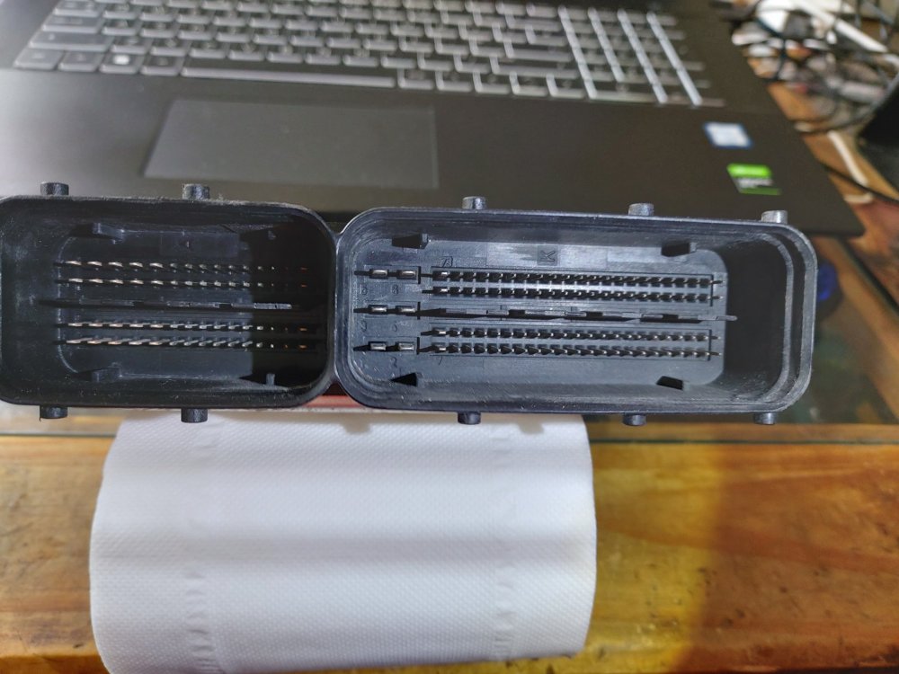

I might need to try and find a ECU rubber seal not sure of the correct name for it but when the mechanic opened the ECU to look at it he never put it back he did say he still got it but not sure I believe him, anyone know where I can buy one?

In terms of the rubber seal, we will need to know the connector part number, then this part number can be cross-referenced with lists of parts associated with your ECU.  The seal will tend to only be pennies.  Electrically, you might just use some electrical insulation tape on the outside of the connector and protect it in a plastic sandwich bag to protect the connector which will keep things good until you can get the correct seal reinstalled.
