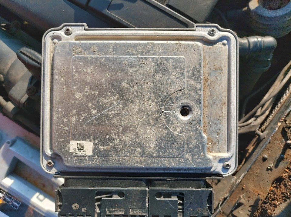

  • Just a quick update on what it was.   There was no power going to the ECU and all the fuses in the ebox needed cleaning out and original fuses needed fitting as some cheap one in there were

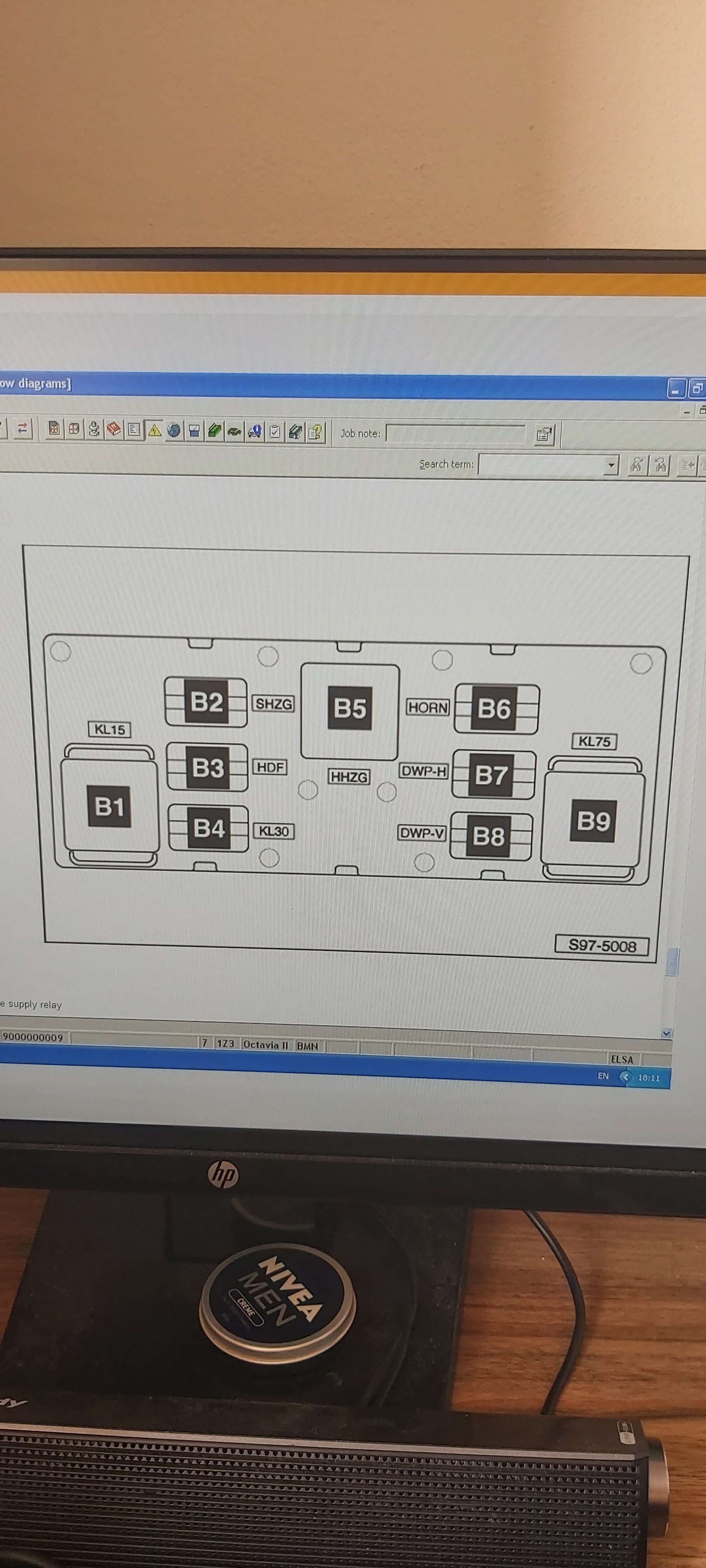

    Check/replace the fuse if you haven't already, relay coil fuse is number 10 in the e-box, should be 5-amp rated. Look for corrosion or looseness of contacts, as well as fuse itself. If that is OK
  • It's quite probable that the ECU has more than 1 12v supply to it, but you need the wiring diagram ( which Wino may have access to ) to see.   Also might be worth removing the battery lead f

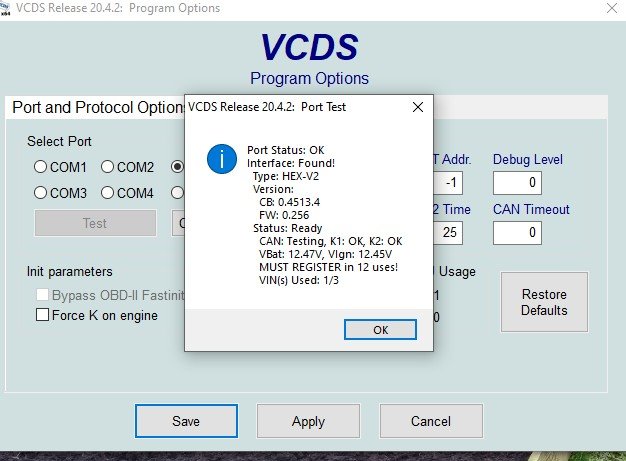

Ok Guys I done an Auto Scan... see below, it was all running fine before I had the mobile Mechanic change all the shocks.
Thing is what to do next?.  I do have it booked into an engine management specialist on Monday I have had the ECU checked and told thats running ok but it could be an intermittent fault

done a port test and says must register would that stop it? where do I register?

Photo showing where this seal goes?
And get onto checking that fuse No.13 in the e-box while you wait for anyone else to step in.
yea fuse 13 in the e-box is fine will these photos help with the seal?
.452770965_ECU02.jpg.70fbf441845a4b3b04157edec2eb4295.jpg182577100_ECU01.jpg.58147bad9f017f3b27dcc3e04a241c13.jpg
Which relay have you checked? According to the wiring diagrams on Elsawin there's two under the dash, one controls terminal 30 power which is referred to in some of your fault codes. (B4 in attachment)
  • Sponsor
Not (for me anyway) without an arrow or verbal description of where in those photos this missing seal should be.

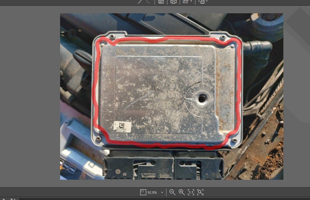

I'm crap at drawing but do you get what I mean Wino? it goes along/inside the grove
Edited by sealover1
  • Sponsor
Dunno, can't spot it in the parts catalogue, and none of the ECUs on ebay that I've just been looking at seem to have anything there.  What's it seal against?
