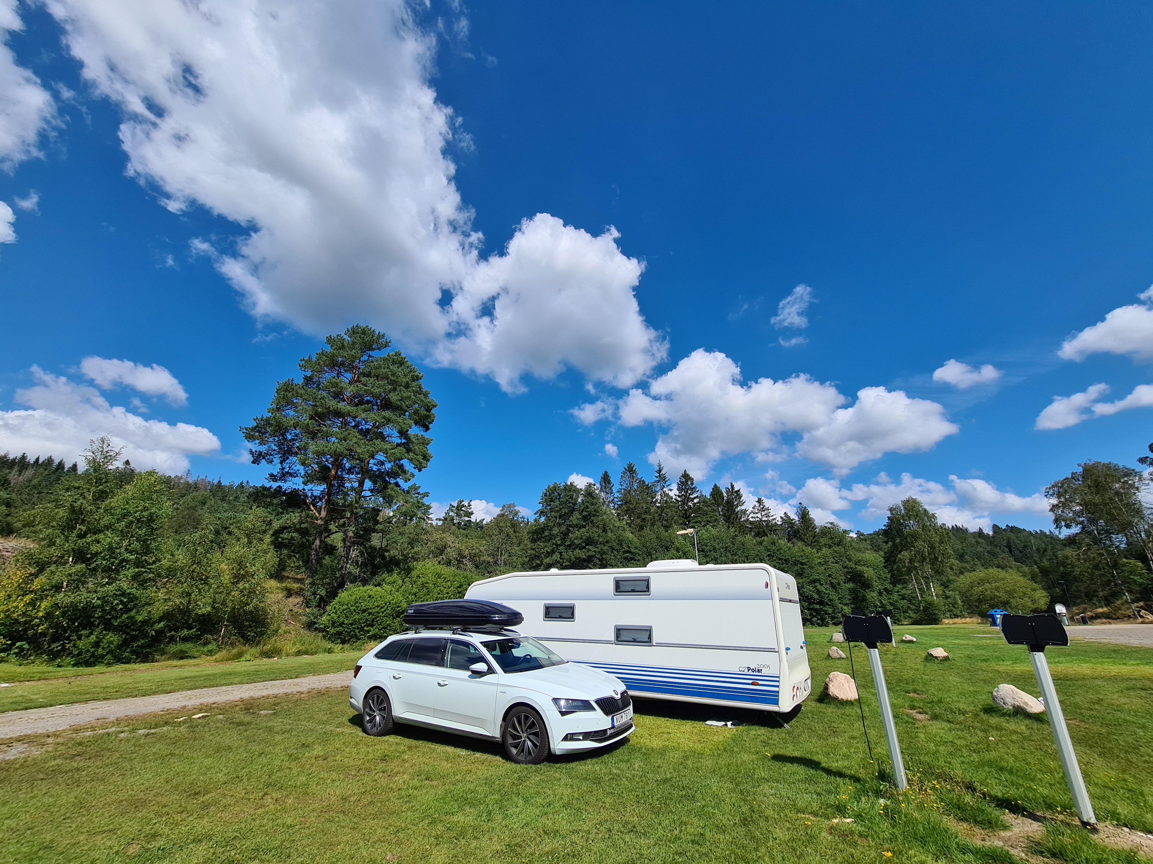

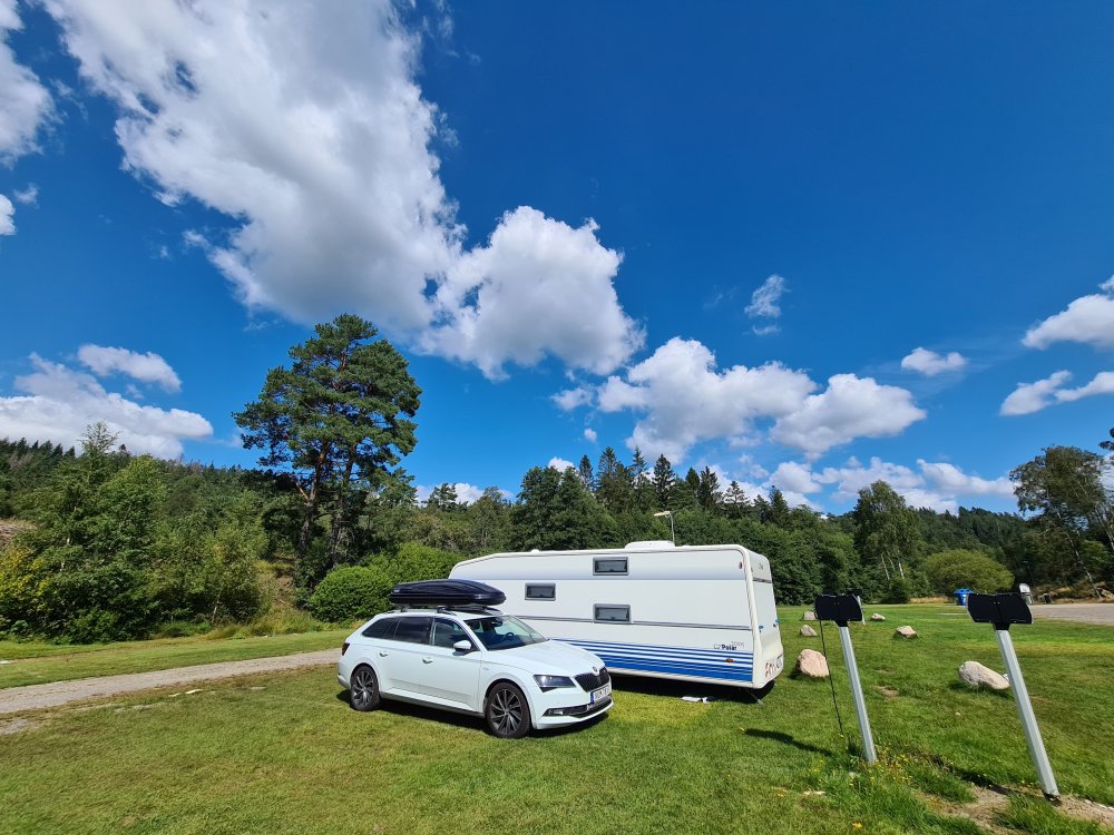

I tow a Polar 680 with a total weight of 1900kg.
it sure feels that there's a lot of weight behind the car but it doesn't struggle at all (I have the 190tdi 4x4).
It's really important to match the weight over the towbar with the recommendations, if you don't it's really dangerous.
Superb has quite a long rear overhang which makes it "spungy" with a heavy trailer or caravan attached to it.
Overall I'm pleased with the experience but I do miss the TC gearbox from our XC70 when reversing and manouvering in tight spots.
Picture of car and caravan
