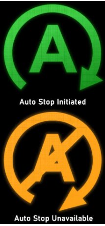

It's a manual gearbox, when I stop, the circle with the A  and a line through it appears on the screen as it always done, however now the engine keeps running and never cuts out now. Not sure what you mean by Finally check the dongle on the battery -VE post, is its cable plugged into it?
Other than the AC being on as mentioned above, or the BMS sensor lead being unplugged, or any of the other load demands being high, it might just be your journeys are very short with frequent engine starts, or that car might not be getting used much - or the battery is in poor health due to aging, compounded by the way the car is being used.

Ok looks like its became unavailable for whatever reason, will prob get the battery checked out as I dont think it is any off the other reasons.
From what I have seen and heard, it only takes a bit of a low battery to do this. I think around 70% charge or less!
This is most likely the norm on a five year old battery anyway!
