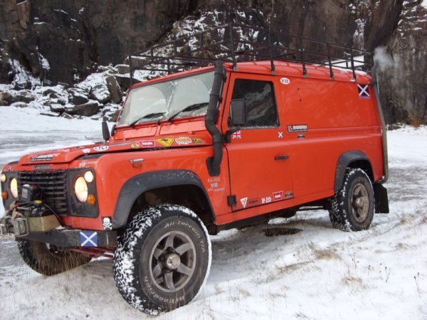

@e-Roottoot Nice looking Defender.👍. Hope that’s a bald spot in the snow under the rear diff, not the orange beast marking its territory.😉
@DSL. A hot spot as nothing to leak there as LPG V8. But there was a cooker, fridge, sink and drain outlet.
